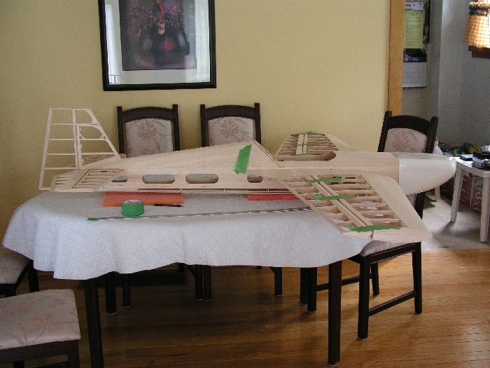

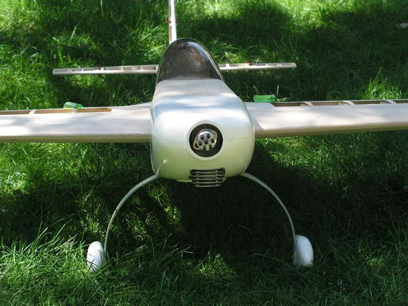

Hi,
I'd just like to share some pics of my new plane for this season. It's a 2M Funtana Pro from Germany, with an SM 30 (30 CC) gas engine and Multiplex Royal Evo 9 radio. I worked on it a lot over the past weekend and it should be done by the mid of June.
THanks
Sebastian

Sweeeeet - its the one with the airfoiled tail. I have a huge crush on this plane. I just can't seem to bring myself to drop $400 on a bloody kit!
How do you like the kit/instructions? Give us some pros/cons, please!

Nice lookin motor. Who sells them?

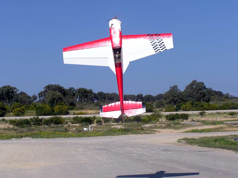

[8D]nice job . dont forget to show us some pics when done - we have one and we run it with a moki180 and perry pump - 18x8 3w prop and she's a real flyer - below some pics.

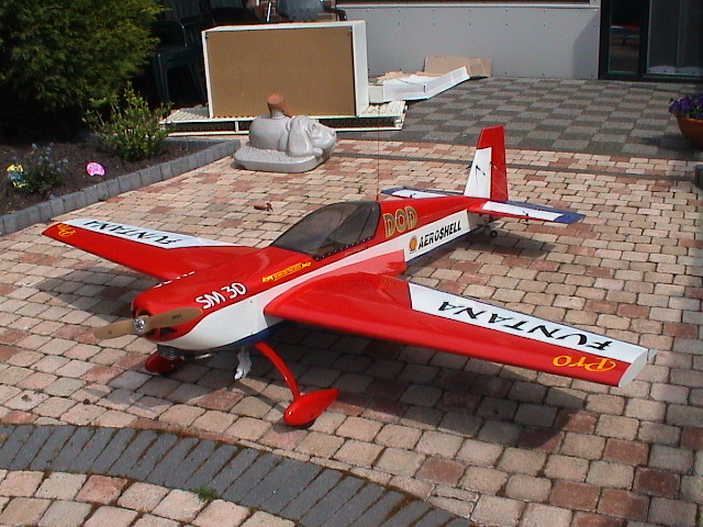

I have also a Funtana Pro with a SM30.
The engine is really powerfull (18x8 MenzS, 8500RPM) but I don't get it right.
I have about 15 flights and 15 deadsticks with my new Funtana but the fun is over.
I have tried everything to run it right

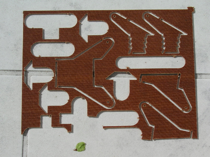

Hi Kurt,
Trust me, its well worth the 400$!!! I will also expand on the pros and cons.
Pros:
Pre joined fiberglass cowl, wheel pants and spinner with almost no visible seam
Very thick curved fiberglass landing gear and rear wheel landing gear
Excellent wing jig( building perfectly straight wings is a sinch)
Amazing cut parts and veryyyyy easy assembly
Perfectly cut fiberglass control horns and accesories
Cons:[:@]
Very bad instructions. They were written by a pretty famous german called Olaf Sucker and they are not very good even if you understand German
Some sanding is required on part openings because the round cutting bit leaves a bit of an arc at corners and this causes some square parts not to fit properly
My main tip when building this plane is to take your time especially with the fuselage. The main thing that I would do next time if I was building this plane again would be to make all of the parts fit loosly with no stress. In the fuselage this is very important because most of the bulkheads fit into the sides very tightly. When you assemble the two sides together, this causes the formers to bend very slightly and this puts and unwanted force on the fuselage that makes it want to twist. So basically let all of the partsfit in loosly because this will make the fuselage perfectly straight and later you can fill it in with some light weight filler.
Sebastian

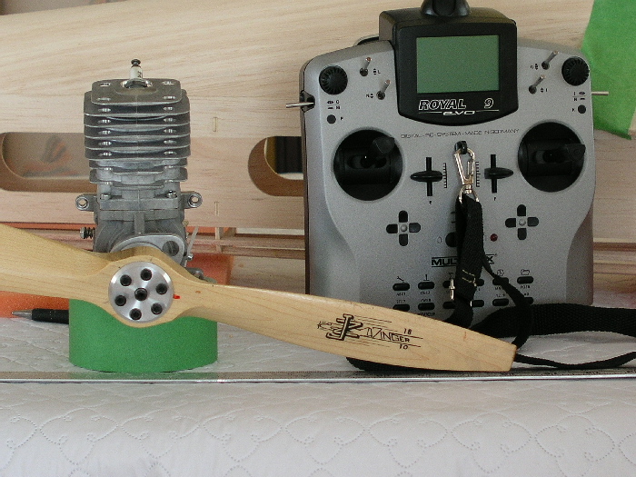

Hi coveredup,
This engine was bought due to the fact that gas is cheap compared to methanol and Nitro. I was considering buying a Mintor 1.7 but it would be to expensive to run and maintain.
I attached some pics

Thats a nice FUNTANA I have some questions. How easy is it to hover and what setup are you using? Servos, distance of CG etc..

tks - cg is on the factory spec only about 1cm back. its very easy to TR but you must have the thrust line perfect and thats it. a real flyer this baby. [8D]some more pics - we have ordered another just incase

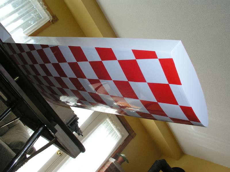

Hi,
Here's the update. Between working the midnight shift, sleeping and living life this is what I have completed. Remounted the engines on aluminum bars (the elastics were to flimsy, the engine barely idled because it shook so much) mounted the throttle servo with a rubber connection. This will absorb shock and reduce servo damage. Inside the rubber are carbon rods from both ends and in the middle is a gap of 5mm which gives a bit of flex Also mounted the ignition. The good people at KS Germany are building me a custom manifold for my SM 30 with a flex pipe in the middle and they advised me on buying the 70cc muffler because it is very quiet and it's performance will be almost exaclty the same as on a pipe. I also covered the wings on the weekend. Those silver stripes tested my patience![:@] I attached pics.
Enjoy
Sebastian
