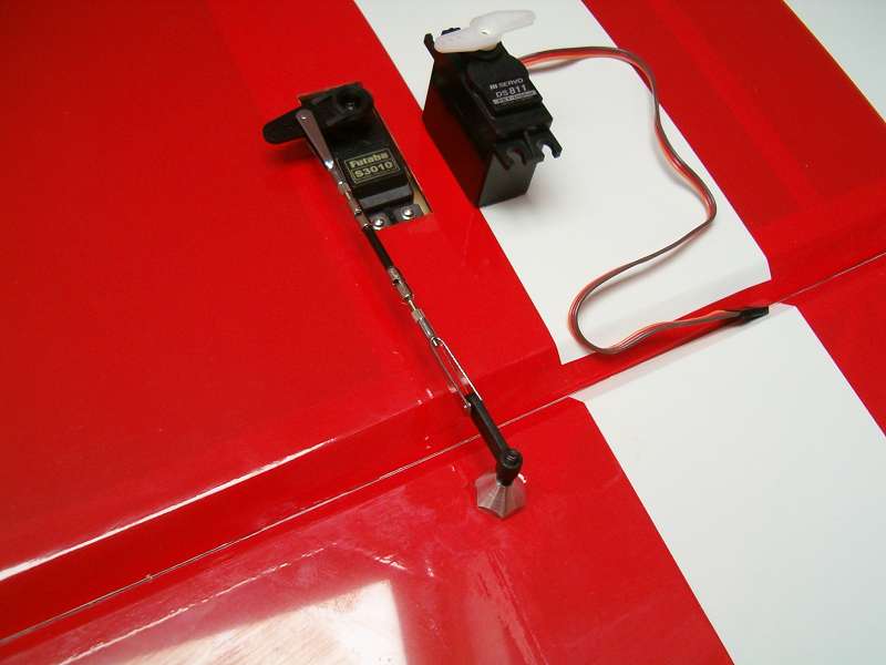

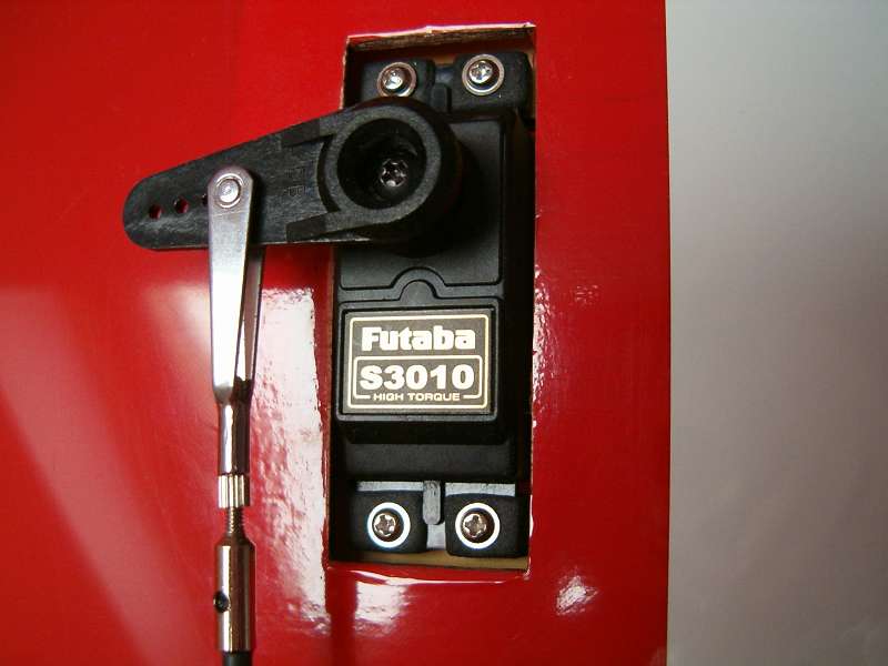

Yeah Luke...
I went out and bought 5 S3010's...got control transport nailed down and as tight as a Ducks A***...but then found at the t/e of the ailerons, next to the fuze, o.k. the ailerons are 150mm deep at this point, there was nearly 5mm free play...i'm a bit uncomfortable with that... also to support 5 S3010's, you really need a 6v 2100 mAHr NiHm batt pack..or somthing simular..
Anyway managed to get, like Joe suggested a JR DS811 servo ...yes .."A" would you believe theyd only got one in stock at LHS.[:-].....if all this turns out well i'll order some more from somewhere ...£38...Not that bad...$69.71..[:-]...more later..
