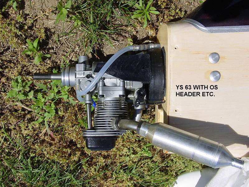

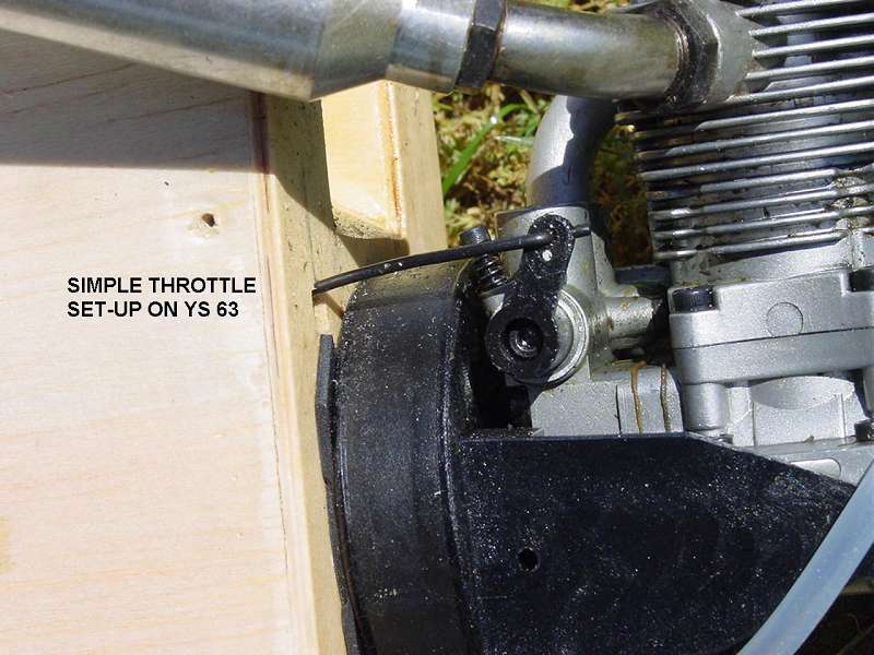

I used a Hyde mount to cut down the "drum" effect of the airframe. It also helped give throttle linkage room.
You might find it interesting that the OS 91 header fits the YS 63 and allows the muffler to be routed nicely. I'll post a picture when i wake up tomorrow and take one :-)

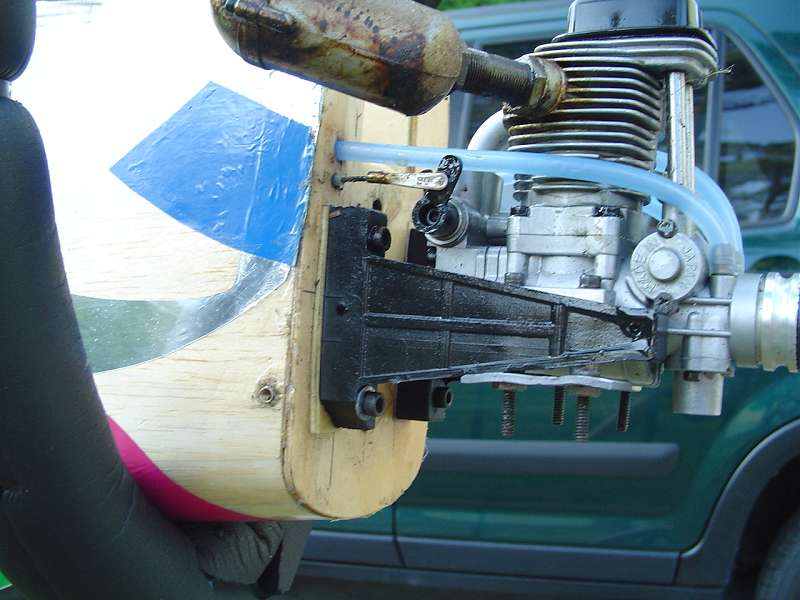

This is how I did it.
You will have to loosen the cap screw in the center of the throttle arm and rotate it where you want it.
I also had to move the rudder servo up front to be able to balance the plane.

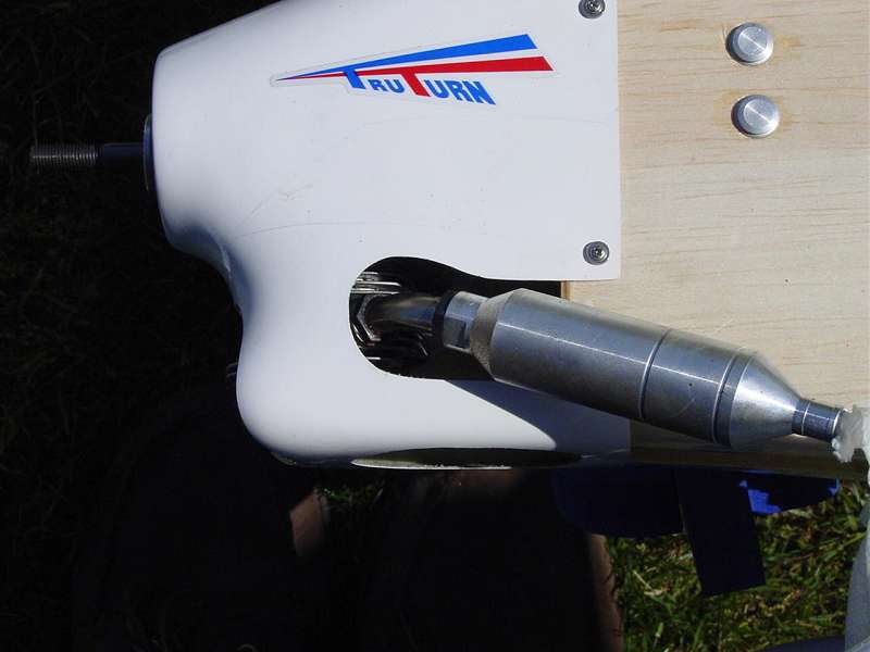

Here are some pictures of throttle/servo muffler and tank psoition.

This entire thing turned out to be a piece of cake. I mounted the engine inverted, flip the throttle arm over so it was pointing down (really up) installed the servo tray and servo in stock position. the throttle rod runs perfectly straight to the carb arm just below (above) the wing. I have no idea why they suggest mounting a 4s at 90 degrees.
