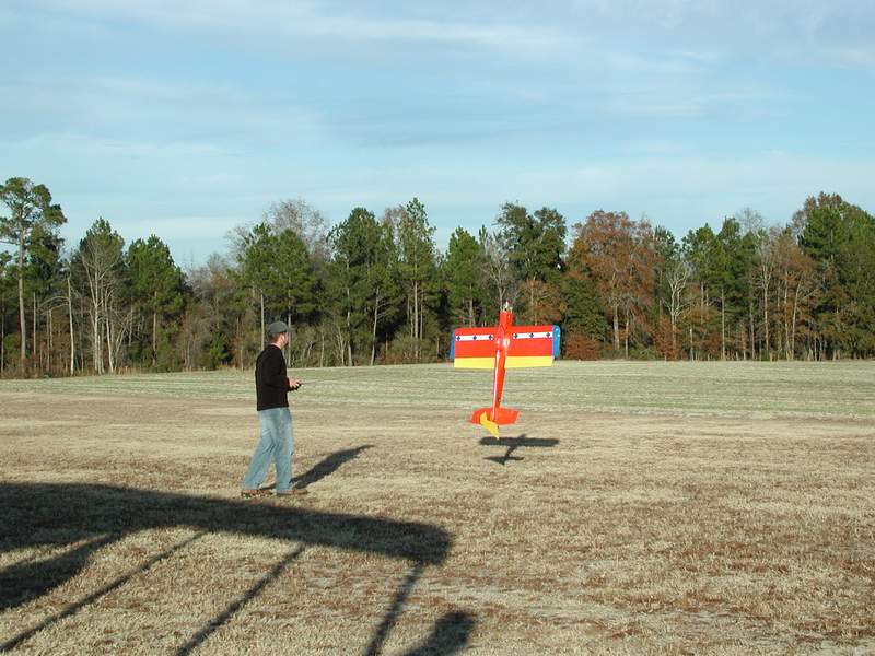

Thanks guys. I am really looking for it to move in the same direction for tighter waterfalls on this new funtana. Hovering is not really a problem for me, its always just came naturally. However a more stable harrier would be nice. I am currently getting right at 70 degrees deflection on most of my planes on 3D rates. I am just looking for something to play around with.
