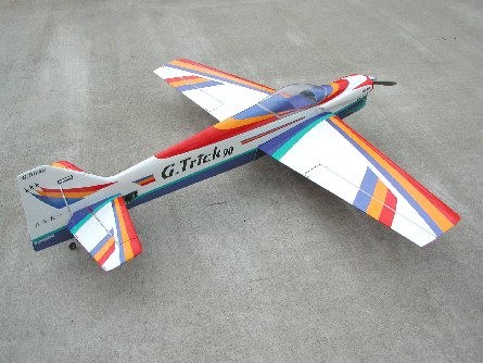

Hi.
I have flown a couple of pattern planes and just saw a G Trick 90 at the store with excellent elevator and aileron as per my knowlegde ideal to do 3D maneouvers. But as we all know it costs a good 600 $. So i would like to know is a Tai ji or a ZEN capable of 3D. Anyone ?
regards
azuz

My experience with the G-Trick is that is a smooth flying machine! I LOVE mine. Altough it has the large control surfaces required for 3D, it's weight is a bit tooo much for 3D. It's a great pattern, freestyle plane. I have a YS 91 un-piped on mine. It will do well with a 120, but then you're adding more weight.
I haven't seen the Tai-Ji or Zen fly, but I believe it has slightly smaller control surfaces. Not sure on the weight, but what I've read others like these planes for their pattern capabilities.
I believe you can get the G-Trick at Central Hobbies for $500 now. Got mine at that price in Dec. If you get it, go over the fuse formers with epoxy or CA, and the firewall as well.
It flies awesome. But not as light as I'd like for 3D.
Hope this helps,
Scott
