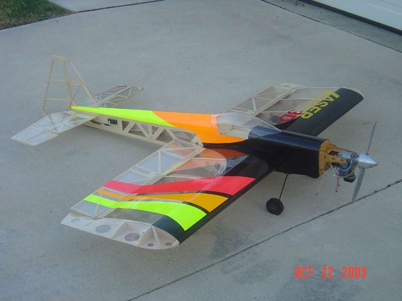

I used a Du-bro anti-vib mount with a YS63S, sheeted all flying surfaces with the thinest balsa I could find and then cut out lightning holes. Didn't reinforce the tail. She was a great flier until I had a mid-air and lost!! Bought another kit already.

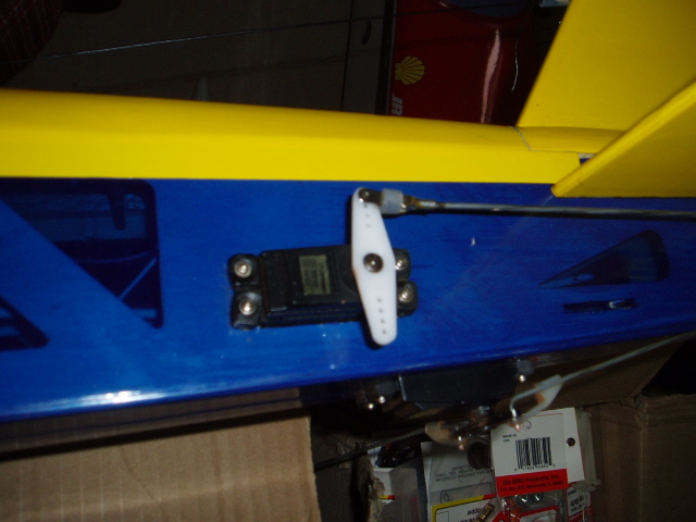

epc, thanks for the info, if you could send some pics thatd be great also how do you mount the servo in the tail. i notice some guys built it without wing tips whats that about. i dont meen to sound dumb because this is not my first kit but how is the tail whell conected to the rudder (if it is) because the instructions arent too clear on that.

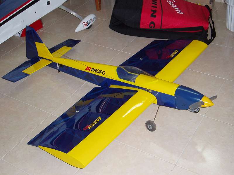

a few pics.
I built mine without the wingtips but just because I like more the way it looks without the wingtips.
epc.

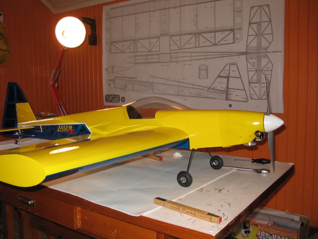

Some Laser 3D pics: http://home.online.no/~helnaess/Laser3D/
- Original engine mount (Irvine 53)
- Tail&Elevators reinforced using some balsa and carbon
- No wingtips
- Pull/pull: Du-bro cevlar
- Some minor reinforcements here&there
Servos: Ail 225MG El 225bb t HS81 ru 475HB
Weight 2200g
30+ flights so far no problems.

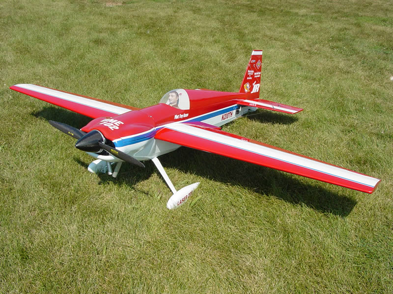

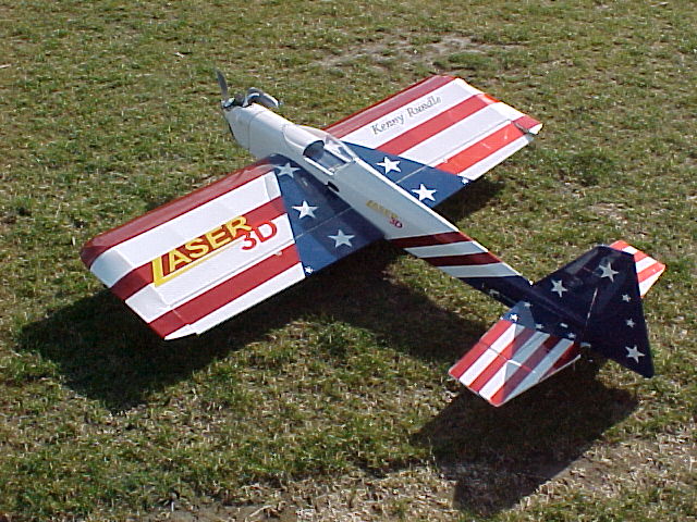

Here are some pictures of mine.
Upgrade your landing gear if you fly on grass, the gear that comes with it is to short

would it work to put some hardwood square stock on both sdes of the mount and bolt it to mount and fire wall as i have poorly illustrated the darker is the hardwood. stratosman your is awesome i liek the patriotic color scheme. once again thanx. -3D-
