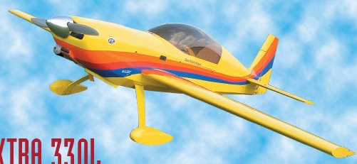

Dave Patrick 26% Extra 330L. Is it a good plane or not? How about its 3D capability?
I have a new Moki 180 I could use in it but will it be enough to pull out of the hover with some authority? Will it even prop hang at all? Specs say 12.6 to 14 pounds. I'm guessing nearer the 14.
Any info gratefully recieved before I buy. And if not the DP Extra then what else for my Moki?

If you can get it down anywhere below 14 lbs it should hover and pull out fine as long as you dont live a mile high. But it is a very good plane and 3-ds pretty well.

Thanks for the info guys. I posted on another couple of forums too and it looks as though the concensus is its a fine 3D ship but 15 pounds is a more realistic final weight. Maybe too much for a Moki 1.80 to hover?

I had the Patrick Extra. I was flying it on a BME 44 and the weight was in the high fifteens. You would probably come in around 15 or somewhere in the high 14's on the Moki. It would be OK, but not graet on your 1.8.
I took my Moki 1.8 and put it in the Dave Patrick Edge. That's a really good combo. I am just under 14 lbs and it flies great. The prop on the Moki 1.8 is the Mezjlik 19x8. This is a MUCH better setup for your Moki.

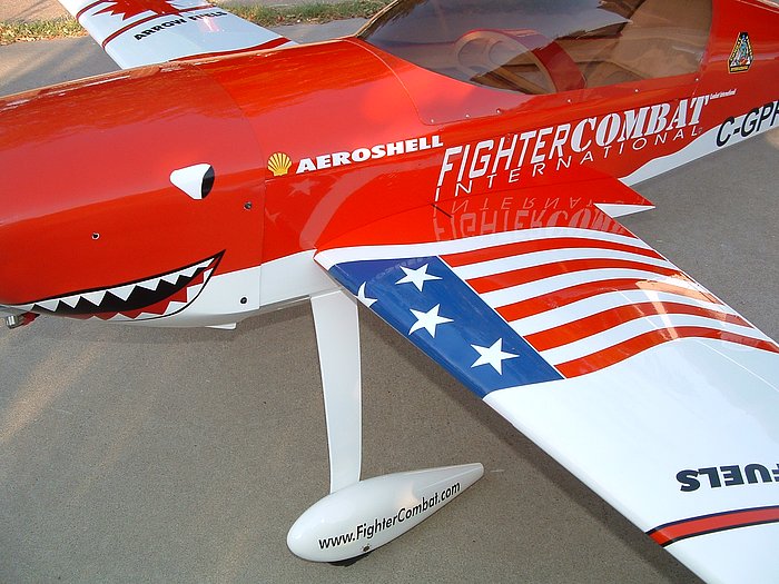

I love my DP Extra 330l I have a D/A 50 in it it weighs about 15 lbs and flies light with an abundance of power through the power curve, it will harrier and elevator with very little effort blasts out of a hover like a rocket, its one of my favorite planes I have ever had!!!
