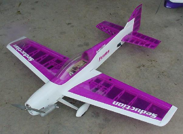

Has anyone found the perfect cg?? Well I finally got a few pics of mine.
