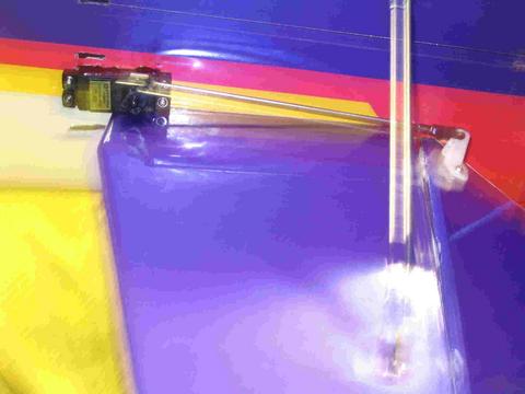

I was wondering the same thing about the pull-pull on the DP ultimate a few weeks ago. I first flew it a few times with the pull-pull setup on the elevator. It worked ok, but they would both not center the same. I was also worried about flutter. Last week I put 1 elevator per each half in the tail at the bottom of the stab and just run a pushrod back there. It works a lot better and flies better. I have more torque now, and it balances out better. I use a YS 140. The rudder is fine and works great with pull-pull.

I have Tower Hobbies TS 70's in the tail (133oz of torque each). One for each elevator half. I have them in right underneath the stabalizer. I cut out the plywood that the servos fit. Then I made another piece of plywood that the servos will fit into so its strong. It works good, and gives my more tail weight for 3D. I'll post a picture on Friday. I won't be home till Friday. I like this better then the other way. The rudder is fine.

Here are the pictures as promised. Some of them got blurry, but you can see them ok to see how the servo setup is.
Ryan
