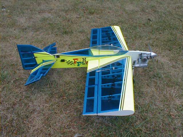

Hey gang thanks to our good friend Vinny, we finally have some pics of our profile Seduction with OS 46 FX and APC 12-1/4 x3-3/4. Have about 16 or so flts on it and is working real well / a lot of FUN ! Only problem has been the HS 225MG servos ! The rudder servo nylon gear stripped at full rht rudder in flt and the aliron servos do not center well and one locked briefly in flt - almost caused a crash ! We only have the travel at 100 % on all and using a 6 VDC pack. They are quick but seem to not hold under a load ?? Would give it a decent score of 7.5 on a 10 scale so far, not the best but good overall. Very quick and a real blast !
Take care and have FUN !! Rod & Chris in PA.

Is that the Seduction Funfly .
Do u have trouble with the Rudder , in the sense , in wind , does the Rudder Flutter .
Do lwt me know .
Regards.
Arjun
Old 08-23-2002 | 12:25 PM
My Feedback: (43)
Posts: 419
From: Whitehall, PA
Default seduction ff
yes this is the seduction funfly, and no we don't have any problems with the rudder.

How can a Nylon Gear strip if you are using 225MG (Metal gear) servos
I think you are probably using the regular 225's and not the MG's .
I am using MG's on my Top Cap, and never had any problems with them.

There are still nylon gears on a 225MG. Also, I have some lock on me in flight as well. But for the most part they have worked well for me.
Question: I am now covering my seduction wild style, and they had the airleron servos being on top of the wing just like your fun fly. I didn't like the way that looked, so I flipped the wing around (fully-symmetrical airfoil) to put them on the bottom. I think it looks better. Just wondering what their logic was for putting them on the top. The wings don't ride that close to the ground that you would have to worry about grass or dirt.

Kevin, almost did the same on ours , to have the servos on the bottom of wing. Would look a lot better for sure ! Yep, there are 2 nylon gears in the metal gear 225 MG's and the one that stripped out has very fine teeth on it. Have FUN !! Rod :spinnyeye

1. Where did it balance out at? from reading other post it should be around 11" from trailing edge Is that right?
Ours was very close to that with the 46, not sure now with the 61 ?
2. the decals did not come with the kit. How much were they and where can I get some. Got them from Randy in Canada for $ 20.00 I think , he is in some of the older seduction post and under the profile section. He is a good guy !
3. Did you support the lower fuse with anything behind the wing? Normally I do because most profiles brake behind the wing and ours did crack there on a hard landing when the eng quit low and slow. But I did not add anything to this one yet. I would install a 1/4 " or so carbon or glass rod into the bottom from way up into the eng doublers all the way back to the tail end. This will allow it to flex a lot without snapping off.
4. what servos did you switch to in wing? I used JR 4131's and they are working great !!
5. and can you open it up and fly it fast if you want. I would NOT open it up or even close while straight and level, only while climbing or in tight manuvers , not even in a large loop or you will propibly blow it apart !!?? None of these type FF / 3D planes are made for speed and most will flutter bad and blow apart due to the large control serfaces and especially the profiles where the whole tail section will move side to side a lot ! I think it would be much safer on the built up one due its structural integrity.
Have FUN with it , they are a BLAST !! Also be careful handling the wing during assembly, the sheeting is very thin and easy to break or crack it ! Take care, Rod & Chris
