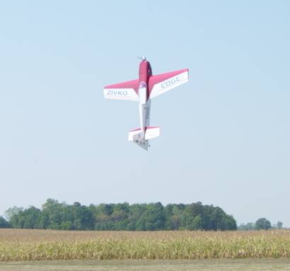

Imac and TOC don't allow gyros, some guys use them in to learn 3-D some don't. I've never used them. the biggest tip I can give you, is to make sure your thrust line is where it needs to be for your aircraft. on my 33% edge I have 3deg of right and 1deg of up. It will sit in a hover almost hands off.
Later, Scott
