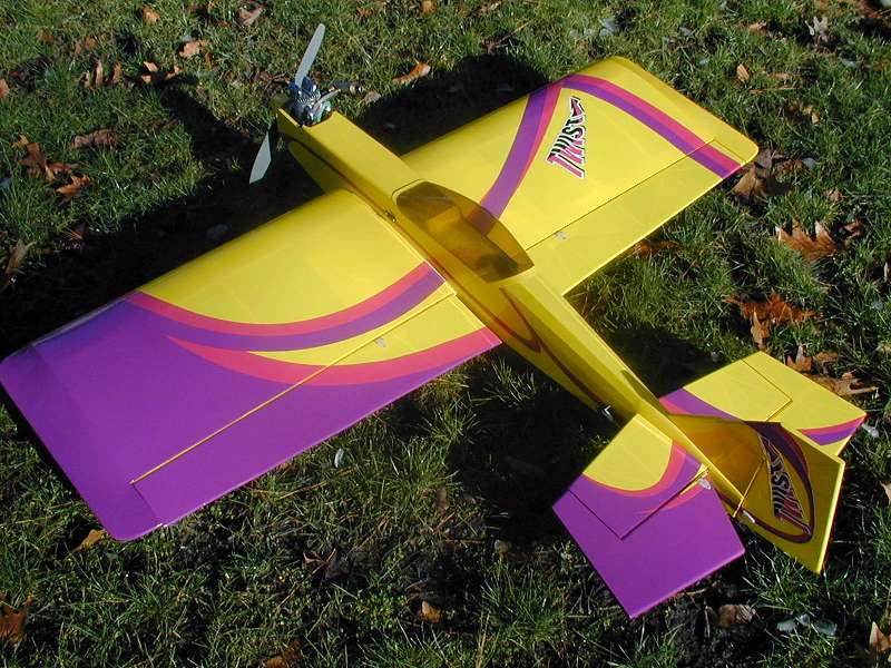

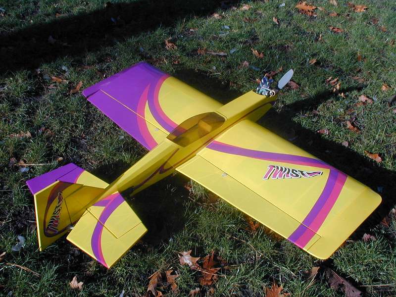

picaro,
I have a twist with modified wing tips. I also fly mine with a Saito.72 on a APC14x4W. Perfect set up, believe me. Plenty of power, hovers between 1/3 an 1/2. I have alot of fun flying this bird because it's cheap and easy. And with the Saito .72 you will have plenty of other schoices, in case you wreck your Twist or get tired of it. There are many other terrific planes on the market but with $99 you can't go wrong.

thevirginian,
did the new wing tips help with wing-rocking in an elevator/harrier?
Old 03-08-2005 | 04:39 PM
  #35
Posts: 1,107
From: Chapel Hill, TN
Default RE: Hangar 9 Twist 3D Vs. Model Tech Magic
What did the wingtips do for you?

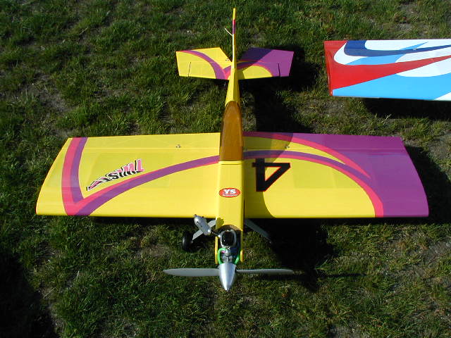

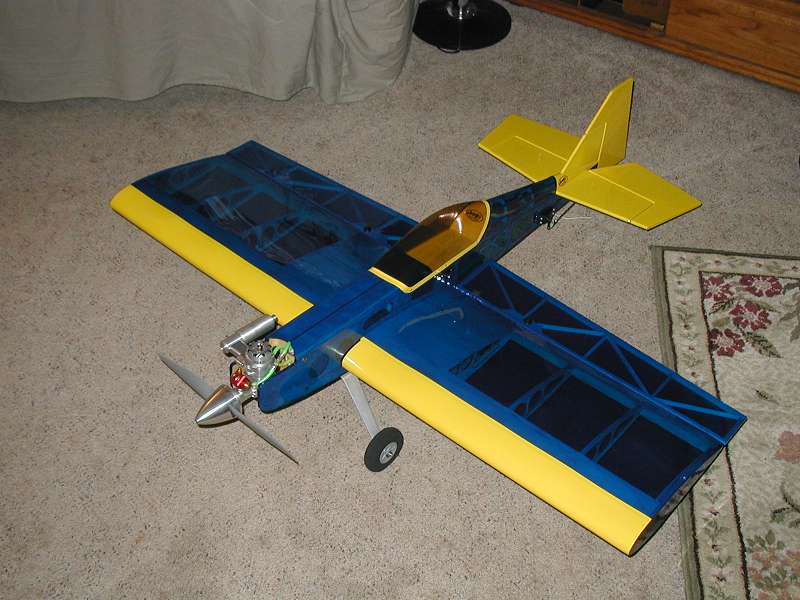

Yellow Twist &YS63S.....Blue&yellow Jett BSE76L.....you can't go wrong with a Twist...JW

lynnpreston,
I think the wing tips improved the overall characteristic in a positive way. Harriers are more stable, inverted flat spins are a riot. Just go vertical and throw both sticks in the upper right corner. She'll flip inverted and flat spins on the spot for ever with throttle wide open. The insane roll rate is still insane, although perhaps a tad tamer. I only can recommend this mod to all Twist owners. Took me only a couple of hours to complete.

lynnpreston;
I post my pix again to show you how I did it. Don't cut a notch in the existing wing tips. It only weakens them. Just glue a piece of balsa 3/16" thick onto it.

Great looking install. Thanks for the pics. I'm going to give this a shot, although mine won't look that clean.
How wide were the tips you installed (meaning how much additional wingspan did they add)? Any methodology to that?
