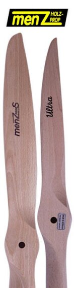

WHAT KIND OF WOOD IS THE MENZ? I THINK MOST WOOD PROPS ARE MAPLE. ARE THE MENZ SHAPED LIKE A PATTERN PROP OR WIDE TIPS?

James,
You can get the MENZ S which is a 3D prop or the menz ULTRA which is a very narrow blade similar to the Mejzlik

The menz wood is German Beachwood. Get em through Desertaircraft.com. $16 bones. have fun.
