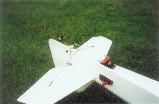

da King,
Basically for the servo installation all I did is square off the holes on the back of the fuselage right a the stabs leading edge, glue a piece of ply wood in flush with the fuse sides (with epoxy) and then a straight linkage setup. The linkages are only about 5 inches Long. The rudder servos was mounted on the bottom of the fuse with a mini pull pull setup. I hinged the rudder with those square plastic hinges with the metal pin in them. I remove each individual pin a replace them with one long piece of music wire. I did this so I can interchange different rudders.

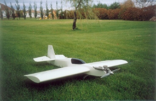

Here's a pic.

Old 10-01-2002 | 09:01 PM
Posts: 12
From: Winnipeg,Mb Canada
Default somthin extra 3d?
And one of the tail!

Old 10-01-2002 | 09:47 PM
Posts: 1,070
From: sterling hts, MI
I like the pix of the servos. I might have to build a kit and do all the mods ive been thinking about. soooo how do you tell which way its going in the air?lol.
Old 10-02-2002 | 01:07 AM
Posts: 12
I'm usually flying right in front of my self so orientation is not a problem. It actually is very easy to see in the air. I covered it sold white so when I screw up in a low hover all I have to do is glue her back together and slap some white monokote on her. That good ol O.S. engine has saved me a couple of times, no incidents yet!
