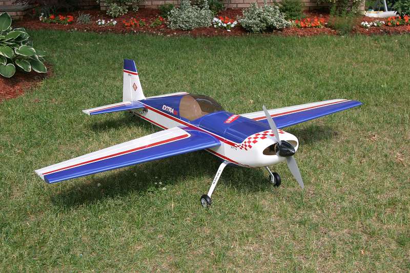

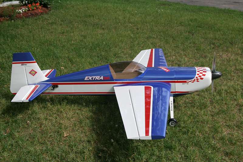

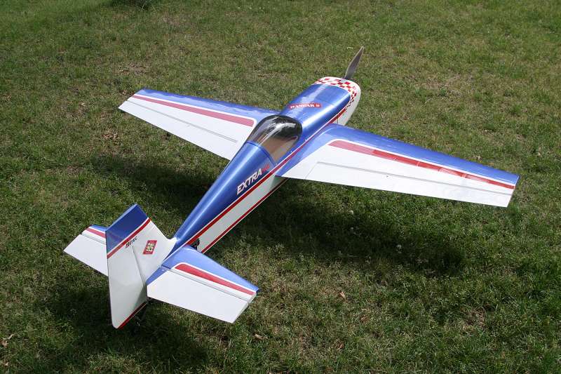

After working all day to finish the battery box and change 3.5mm bullet ESC connectors to Feigao 4mm, it finally flew.
The flight time is about 10min with battery reserve ( landing voltage per 3cell pack was st 11.2v ). It will hover about 1/2 throttle and it has unlimited vertical. IMO it tracks much much better than my DA50 powered PW extra. It does awesome flat flat inverted spins and quite acceptable flat spins. The plane is too new to wring it out so more test will come.
I am waiting for better prop for this plane (22x10, 22x12) as 20x13 makes it too fast and not enough thrust. I also feel the need to build a louver in the cowl inlet to direct air to motor drum.
I have not so perfect maiden vidoe. Those who would like to see say "I"

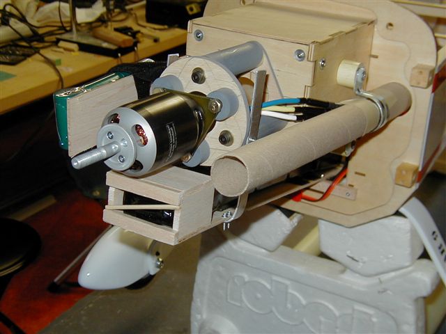

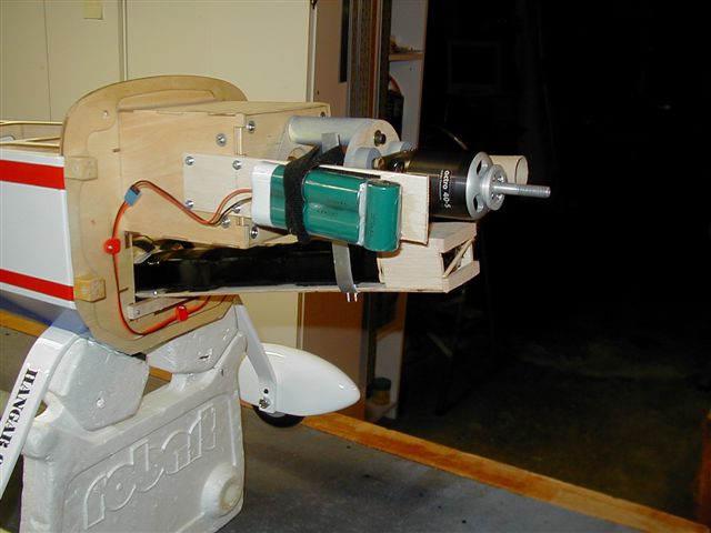

Well, I'll try this again. I just wrote a long write up on mine then apparently lost it before posting.
I just found this thread as I don't monitor 3D forums. I'm mostly interested in precision aerobatics. I have 5 flights on mine.
My power system is:
Actro 40-5 with Actronic 32-70 controller
APC-E 20x8 prop
10s2p 4000 mah Thunder Power ProLite pack
11 oz. 2600 mah Rx pack, (I need the nose weight).
RTF weight is 13 lbs.
The paper tube houses the controller and directs prop blast over it.

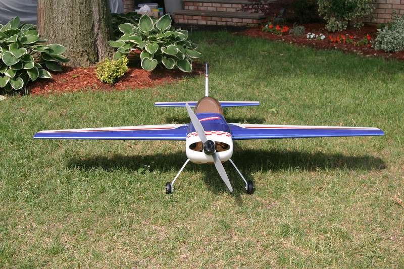

Norm, Awall - Welcome to the thread!
Norm - My ESC shutdown on 5th flight causing water landing. The ESC shown on the side of the motor box will be slanted and be flush with bottom of the cowl exposed.

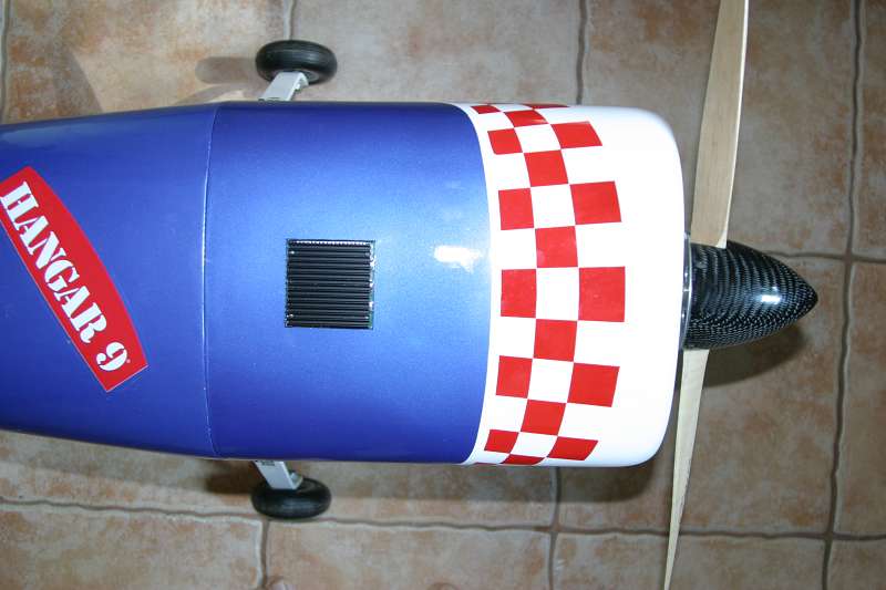

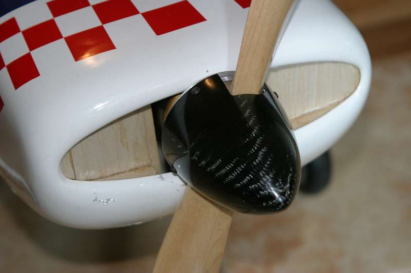

Temporary location of the esc on busted cowl. Although it was only temporary, it does not look too bad. What do you think?
It also shows the inlet louver. I will eventually build a concentric ring around the motor to complete the ventury.

Red,
I would mount the ESC just like you have it, but on the bottom of the cowl.
I have a question though. It looks like in the middle photo above you blocked the airflow. I am missing the point of this. You need as much airflow across the motor and batteries as you can get. Especially since you are running such high amps. You exit hole must be twice the size of the entry hole to creat a vacume effect to force cool air in and warm air out.
Thanks for sharing the conversion. I have followed Norm's, but it is good to see another.
-Mike
-Mike

Mike:
Yes. top esc is only temporary as I am lazy too build a standoff at an angle to make the esc flush to bottom.
Open cowl will give higest flowrate but least will actually reach the surface of the motor as air stream will look for least resistant path. It is most beneficial to batt as the coolest air gets to batt. However, I'm not too concerned about the batt temp as I'm not pushing the batt too hard. 10min flight on 8000mah means the average current draw is 480ampmin/10min = 48amps or about 6C. It only gets warm which is also good for longevity of the pack.
As you put the baffle or louver, you are forcing the air to pass near the motor surface reducing the boundary layer thickness. You are reducing the Q (flowrate)
but improve the airflow near the motor. Combination of Fluid Dynamics and Heat Transfer at work.
The motor temp has been reduced but the esc temp has gone up before the esc relocation. To improve the system, concentric cylinder needs to be constructed around the motor so air does not escape to area on top and bottom where there is least restriction as is the case of current louver setup. Only expement will tell what the optimum gap between the ventury cylinder to motor can diameter should be.
I really need a separate cool air inlet from the motor air as it is already heated.

fresher air is better than heated air exiting the motor. I may endup adding a scoop on the bottom for flow into the batt chamber similar to your yak.
Ideally you want fresh air into the baffle and exit to side before entering fuse. same for esc and batt.
I wish i have the eagle tree telemetry system while i work out all this.
For now, I have to resort to finger method and duratrax thermometer. I believe the thermometer can be left on for continuous reading of max temp. it might be useful.
