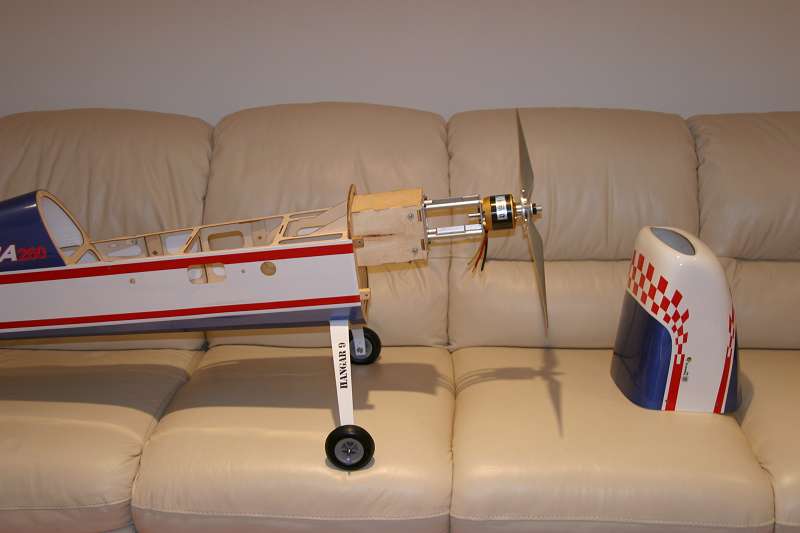

Aluminum motor mount from espritmodel came!
4" extensions were ordered and they are shortened to 3.8"

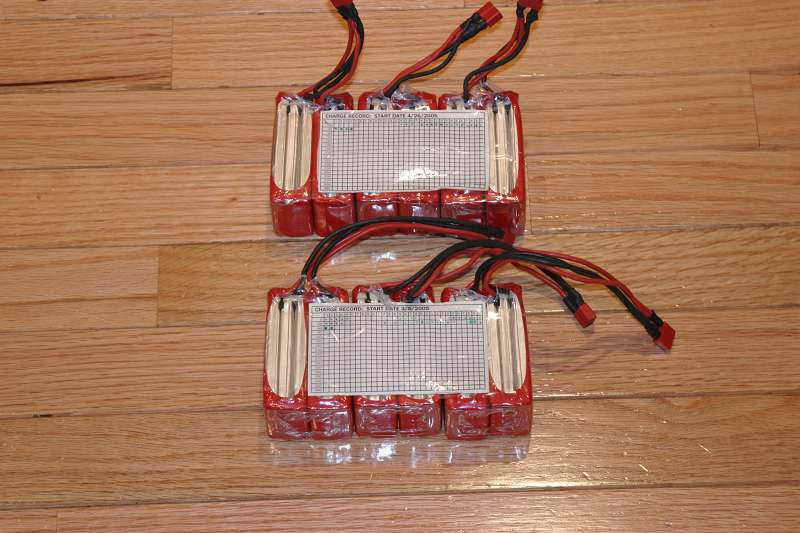

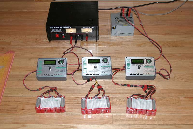

Pictures of home charging (make sure your eyes are on the display at all times if you plan to charge inside) and field box.
2 packs shown will be powering the Extra 260. These packs are currently being used on my Funtana 90. Having 3 packs allows me to fly every 20min at the field.

Hey red_z06... what kind of charge sheet is that on your batteries? I'm curious as to the data you put on there. It might be beneficial to some of us.
Old 06-08-2005 | 11:14 AM
red_z06's Avatar
My Feedback: (11)
Joined: Jun 2003
Posts: 538
From: Dumont, NJ
Default RE: Hangar 9 - Extra 260 - Electric Conversion
Ghee:
It is just a chage log with 480 boxes of 30 columns x 16 rows. It also shows initial charge date. I'll be happy if the battery packs last until the last box is marked and if the capacity is good enough after that... well that is freebee.
1st pack has 90 charges
2nd 65
3rd 34 <- since April 2005
3 packs are chaged as shown at home ( in my driveway ) then they are field charged with 80ah car battery in a custom box with banana terminals. While it is being depleted, 1000w generator replenishes with its 12v outlet and another 12v 24a radioshack power supply plugged into 110v outlet for additional 2 astro 109 chargers.
This allows me to continuously charge 2 packs while I'm flying the 3rd.
After flying the 3rd home charged pack, there is a bit of delay 10-15min before I can fly the 4th flight ( 1st field charged )
I really need 4th pack to fly nonstop.

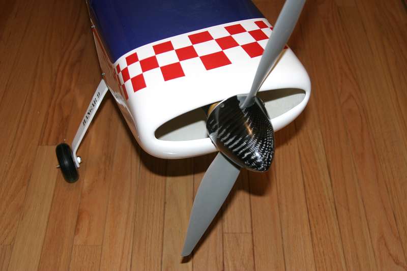

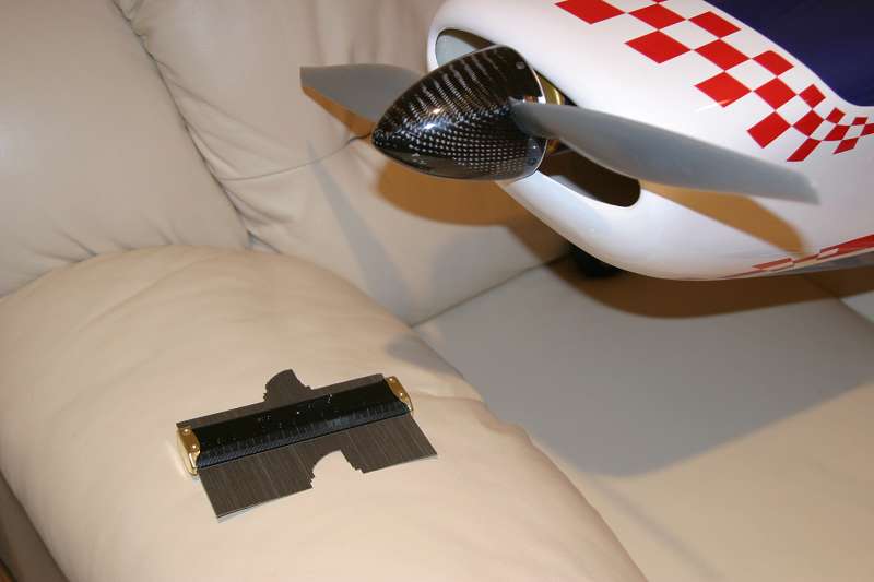

After running to a local hardware store for a contour gauge...
3 1/8" CF spinner is from EspritModel. Their FG spinner is dirt cheap (relatively speaking). I think I should have gotten 3.5" CF Spinner.
I just need to mount UBEC, 2 Batt Packs according to CG and build batt boxes, build 2 series Ultra Dean wire sets, and mount receiver switch and it will be ready for maiden.

you forgot to mention the $390 for 3 astroflight 109s and the pyrimid power supply price and the $45,000 car in you avitar
Old 06-09-2005 | 08:10 PM
red_z06's Avatar
My Feedback: (11)
Joined: Jun 2003
Posts: 538
From: Dumont, NJ
Don't waste your money on Pyramid Garbage power supply. It was rated for 40amps with 35amps continuous. When 18amps are loaded, it cuts out in less than 30min. When I called them, they said the duty cycle is 15min full, 45min idle. What bull**** @#$@#$.
So, it is good enough for 1 astro charger. You are better off getting Radio Shack 25amp switching power supply.
Drumbum:
You only need one Astro charger. I'm using 3 cause I want to fly it non stop. BTW, the Vette is actuall $53,000. It is a Z06 (405HP) not a regular vette.
Old 06-09-2005 | 08:48 PM

Motor, Spinner, 20x13 APC Eprop, Esprit Alu Mount, and 3 1/8" CF spinner all weigh 2lb 2oz
