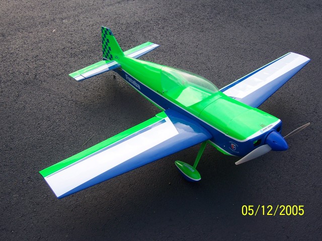

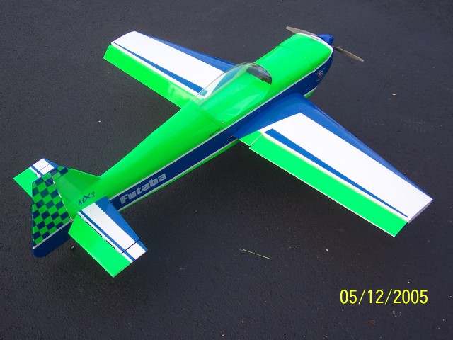

Has anyone built the CMP Giles 202 1.40 size (the big green one)?
I'm just getting towards the end of my assembly and it looks gorgeous.
I was just wondering if anyone has any experience of this particular Giles. I have an MVVS 1.60 glow up front with an 18x6 prop.
