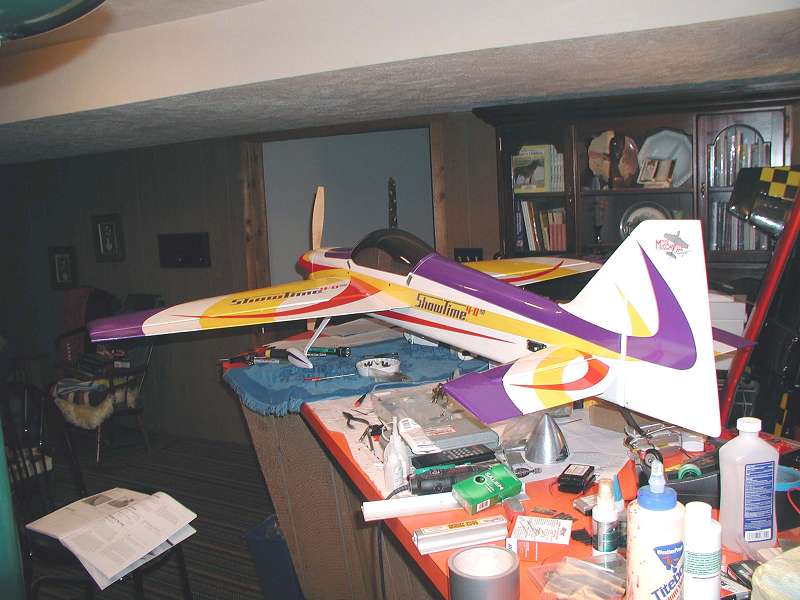

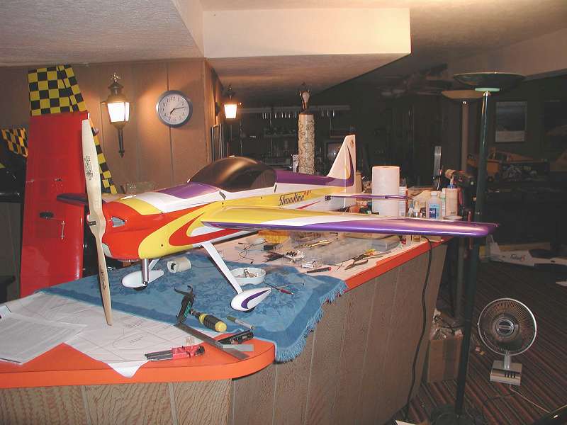

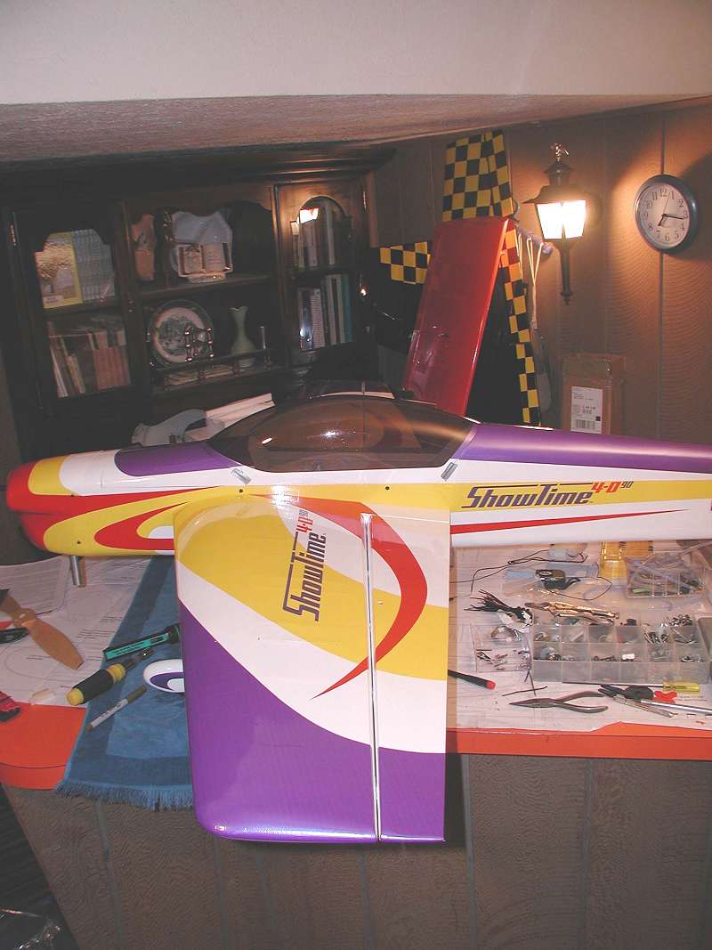

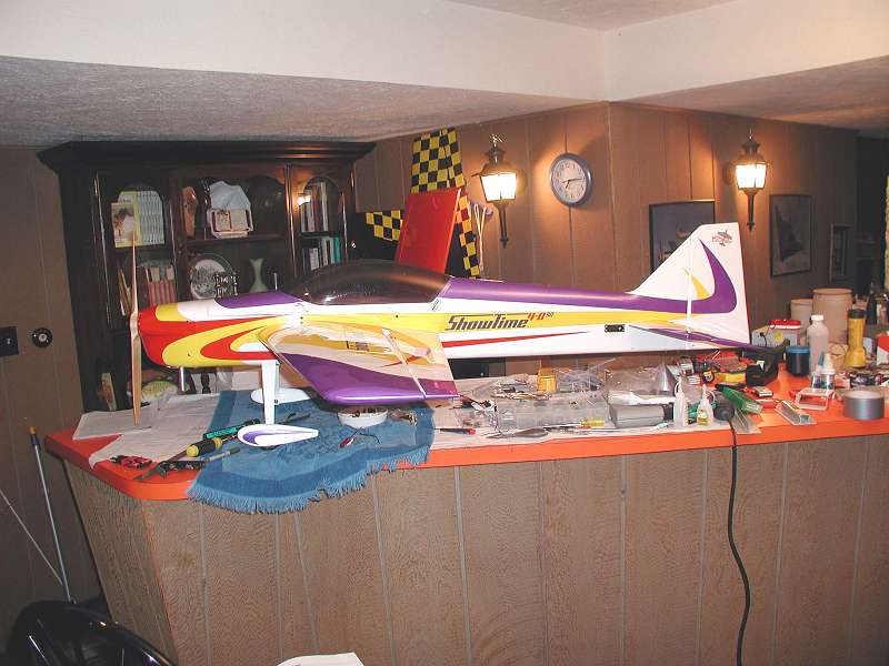

Old 06-27-2005 | 08:19 PM
Joined: Dec 2002
Posts: 68
From: new lenox, IL
Default RE: Showtime
Here is few pictures. The ShowTime looks like a pattern plane. Its' 69" from tip of spinner to tip of rudder. The wing panels are 30" long by18" root at the fuselage and 8" root at the tip. The fuselage is less then 7" wide at the widest point.
Pat
