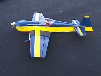

They pop up on eBay and RCU from time to time. They were in production only a short time.

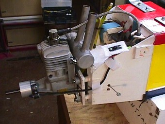

Or, if you want to try building, you can buy the Midwest kit (one of Mike McConville's best designs, IMHO) on eBay, keep the plans, trace the plywood parts in the fuse and cut them from balsa, cut wings and stabs, and turtle deck from 1# foam sheeted in 1/16" contest balsa, then box up the kit and sell it again on eBay. You end up with an 80" Cap weighing just under 11# with a YS 1.40, or (like mine), 12# with a ZDZ40. 1200 in^2 wing area, 12# on gas = 23 oz/ft^2. That is a great wing loading for a .40 size plane, let alone a 50cc sized plane!
Here is mine:

Thanks Terry... Thats a good Idea but how will it handle a 50cc?

are you saying a 50cc is significantly more power than a 40cc? It has plenty of power with the 40, a 50 would be additional weight. My cap weighs around 12# with the ZDZ40. It is exceptionally light already. It would "handle" a 50cc just fine, but why add weight? (except the BME or Brison, which weigh less...)
The reason I posted this is the Hangar 9 80" Cap is roughly the same size/dimensions of the Midwest Cap. There are a few changes that can be made during construction that will dramatically decrease the weight. The Hangar 9 weighs around 15# with a 50cc engine.
Note these planes are quite a bit larger than the CHP Cap-X/Extrem Aircraft Cap 232, which can both handle the 50cc. Chip has a video of his Cap-X with a DA 50 on his website.
[link=http://pages.prodigy.net/ka9lnp/dhm27cap232.htm]HERE[/link] is a link showing a similar plane "in the bones". Mine has 1-piece wing and stab.
