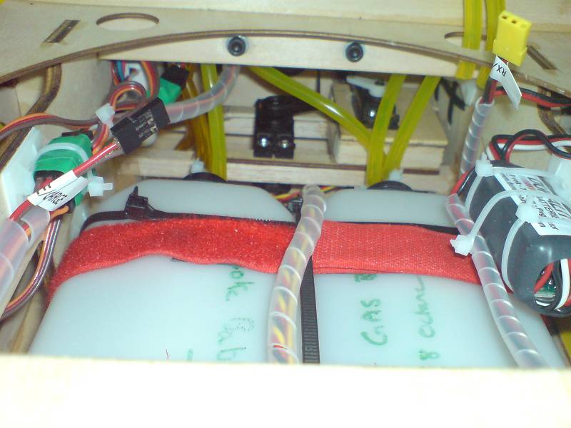

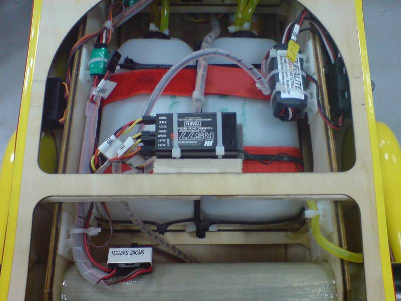

OKay finally got round to finalising the plane, here are the pics, I decided to go with the a smoke system, and as you can see I have added an equivalent smoke tank. Will have some more pics up later today with more shots of the final touches
The C.G did not balance out at all as per the manual, as per bonedoc's c.g neither, I will have to wait and see if it balances out once a spinner is in place.
If all else fails I might swap out the smoke pump with a sullivan smoke pump that may address the problem, lst resort will be dead weights.
I dumped everything at the front of the plane there is nothing left to add, also I decided to opt with a single pull pull single servo setup for the rudder as per bonedocs building tips, looks like a winner.
Maiden flight schedule in the coming days will see what the result is.

Nice work. I'm not sure how you can hover with that much weight though. As long as you're good with your landing, starting at .75" aft from the aft-most recommended CG shoudn't be a problem.

Bonedoc have not weighed her in yet will do so once the spinner is in place, then will have a fiddle with the weight issue prior to her first maiden, most likely going to swap out the smoke tank something smaller. after her weigh in will see how much I can drop her down to.
P.S. I did fiberglass the Firewall wit hobbico 21 g cloth as well with epoxy resin from zap. That would have added easily 25 to 30 grammes in the front.
Here are the updated pics
