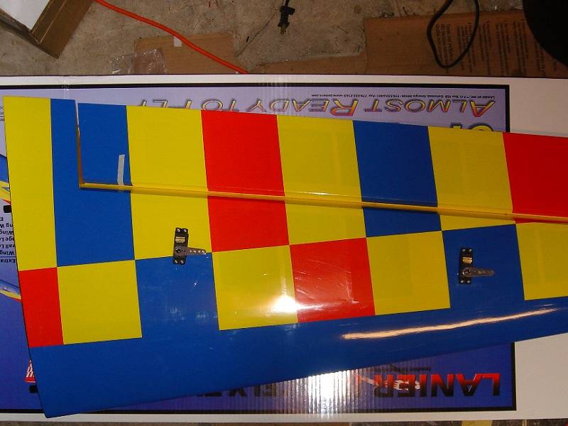

My servo setup is rather cumbersome. I have the Left wing on CH 5 & 6, and the Right wing on CH 1 and 8 (or is it 7?). The Elevators are on CH 2 & 7 (or 8, I don't recall which). I think that you can master / slave the channel so that the wing servos will function as a unison, but I haven't quite figured it out yet. It's setup ok now, and really the only mix I typically use is one to neutralize the roll / pitch on KE anyway. I find that I need about 15% Rudder / Aileron mix to take out the roll coupling. Everything is plugged into my Futaba PCM receiver. No powerbox used here. I didn't have any issue with power, responsiveness, and glitch, so I haven't had the itch to upgrade to a powerbox. I suppose, however, a powerbox will make setup more convenient. I think using a Y Harness with a programed Hitec servo will be just fine (Just use two and use the flapperon mix on the radio). I would if I have the time to do it, but once you've got everything kind of set up already, laziness kicks in

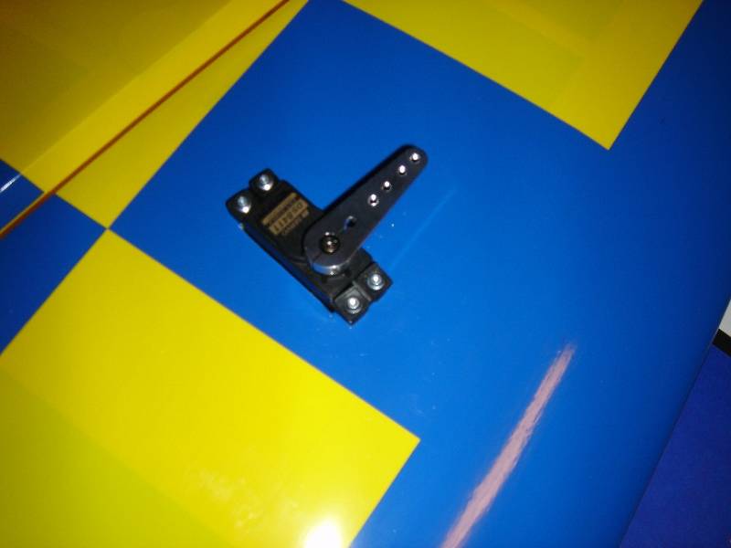

Has anybody got any comments on the servo arms to be used? There is no mention of it in the manual and the ones in the pictures seem to be DuBro HD.
I installed intially the 1.5' H9 machined arms, which are very tight. They do however look too large and so far off to the side that the linkage to the hardpoint might get a bit offset and diagonal.
Instead of measuring a direct line from the servo side as per the manual (which hits the middle of the hard point), the line from the arm external hole goes to the outside edge of the hardpoint. If I want to drill in the middle, I will have a linkage that is not at 90 degrees to the servo.

You will have a much stronger and linear aileron response if you do not have your pushrod 90 degrees to the servo at neutral. Instead, the pushrod should angle in towards the servo slightly. Draw a line along the wing right against the body of the servo, towards the aileron. Then move the aileron control horn about 1/4" outside. This gives you a set-up that is strong throughout the servo travel. I'll try to find a picture...

Thanks for this info.
If I do what you describe, I would have almost an inch the connecting rod would have to go back towards the horn. If I position the servo the other way (output shaft toward the aileron, not towards the wing like the instructions show) I can even increase this angle.
Is there a recommendation how much the connecting rod should go inwards to get the maximum effect of this setup?

Very interesting conversation and the dime just dropped for me.
I now understood the notion of the servo still being effective at full throw if it's slightly offset out and the arm angles in at neutral. On the flip side, if completely parallel ay neutral, it will be investing very litle of it's motion to actually hold the aileron at full throw...
Actually, if I extrapolate, in order to identify the linkage best angle at rest, it should be parallel to the servo at full push throw. So one would need to move the arm to the best angle (between 45 and 60) and measure a straight line from the hole to determine the right horn location.
Furthermore, the arm at neutral should not be at 90 degrees, because if that is the case, during pull (aileron up), you will encounter an area of low yield and low hold, probably somewhere after 50 - 55 degrees of throw...
