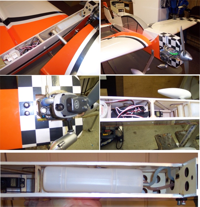

Hey dude, looks like you did a great job on that yak. We've been fighting the weather here in Loisiana, but I finally put the maiden flight on mine today. I've got an old YS 1.20 4 stroke on mine. After a couple of trim passes, I turned it knife edge at half throttle. I rolled it and by instinct fed in about half of the rudder to catch it. Before I could react, it yawed until the nose was straight up and started to hover. Woooooh! It doesn't take much rudder to hold knife edge. I haven't tried it yet, but I'm sure it will do multiple knife edge loops. Had to leave the field early, but I can't wait to get some stick time on this thing. It's so cool to have a profile without the tank and wires hanging out. Good luck with yours.

llamury, how does it do with the YS 1.20? How did it balance with that large of an engine? I would really like to make one electric but I don't think I'll get the batteries by spring. I'm also considering the new Saito 125

rtn9105, because I had to go to a wedding, I only got one flight on it so I'm not through trimming. But, I was surprised that it was not nose heavy. I initially placed my battery all the back in the radio compartment assuming it would have to be there with the 1.20, but I had to move it forward to hit the factury recommendation on CG. On a new airplane, I usually start with the factory recommendation for the first flight. I will creep it back until the plane dives very slightly with no elevator input in the inverted position. That's just personal preference.
I am not into electric power, so I can't help you on that, but the Saito 1.25 would be a lot of power for this plane. A good 90 would be plenty. I think the Saito is about 7oz. lighter than my old YS 1.20. You shouldn't have trouble hitting the CG.
