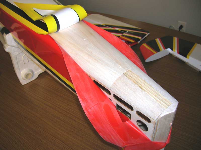

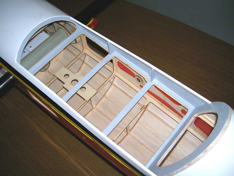

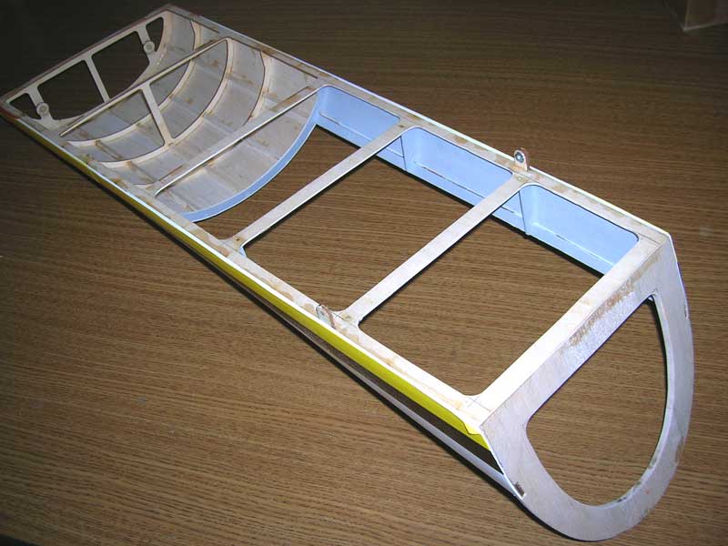

Maybe I shouldn't show this.... but again... curiosity killed the cat...
This thing is covered PERFECTLY to peel it like a banana and access the tailwheel plate and rudderpost. not to mention the belly balsa...
A person could easily remove some material here and the button it back up without having to tear up the beautiful covering. It'll go back together without a hint that it was done and without needing any extra covering.... SHWEEET!
And also, while in here... look how nicely this thing is assembled... w9old have loved to have seen an ARC version... beautiful job of sanding and sheeting... makes a fella feel bad if he decided to take some out...
pcsol... ADDING! That firewall is solid man... pinned and everything... but do as you must...

This is VERY interesting... the wood parts I haven't touched, have already lost 2.3 oz!
I noticed that my hatch was actually a tad heavier in todays weight untouched vs. yesterday's weight intouched.
I was going to go ahead and lighten the tail out a bit just to see how much I was gonna save in the tail... (yeah I know)...
And thought I better weigh the fuse again... It dropped 1.1 oz! The wings dropped a little too and one stab a hint... the other stab was the same.
Then I weighed all the "hard stuff" wingtube, stabtubes, gear, etc... they are all the same... so YES.. .the plane dropped 2.3 oz on it's own... Probably dried out some from being outside on the ocean so long.
now that's what I am talking about! Yeah it's not gonna drop 1/2 lb... but maybe when all is said and done it would be 1/4 lb less huh?
Then one could argue it would gain that much in humid summers... well I dunno... but let me enjoy this anyway...

Simple job... saved .7 oz and this thing is still rock solid in the tail... The center tailblock was an absolute BEAR to drill thru... looks like pine/spruce... HARD as a rock. Light sanding and... well... you can't tell it's been done except for the slight darkness of the holes... If anyone gets up under my plane and compains... [:@]
Saving in the tail is going to be a real big deal come balance time... I didn't iron on the covering real tight as I may come back and visit the belly balsa once I see how the balance comes out.

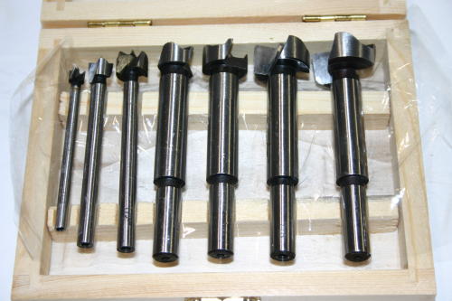

Great job, what's the secret for such clean looking lightning holes? Also, you were right about Lanier and single ailerons. Talked to them today and they said they had never flown one with one servo per wing. Really advised against because of the size of the ailerons.

I use forstener bits for drilling the clean holes... I got a little carried away on one front big one and caught the edge a little, but didn't hurt anything.

Here's what forsteners are if you haven't seen them...

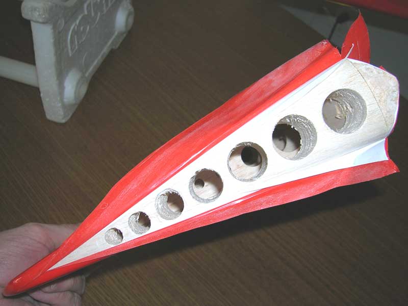

It just gets better!

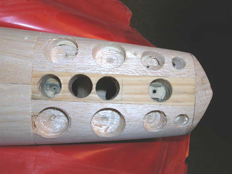

Taking a break from some webwork, I decide to "peek" at the rudder bottom...
Again the covering couldn't be done better for a peel and see approach.
I did, and decided to drill out a bit hole and see where I was... I drilled, and I drilled and I drilled...
And when I finally broke through the other side it felt like reaching China...
Oh.... my..... gosh..... this thing has a 2" tall rudder block!
I drilled atotal of 7 varying size holes as I follwed the taper... and to my surprise...
I save yet another .7 oz! From the rudder plate alone. left PLENTY meat for the tailtouches (like I can do one anyway).
And wrapped it back up... won't be in here again, so I ironed it down good...
Saved .7 in the tailwheel plate and .7 in the rudder base... 1.4 oz total out of the tail with the CF tailwheel and stabtubes that's about 3 oz out of the tail and 8-9 in the nose!
Making that DA50 balance is getting likelier and likelier...
