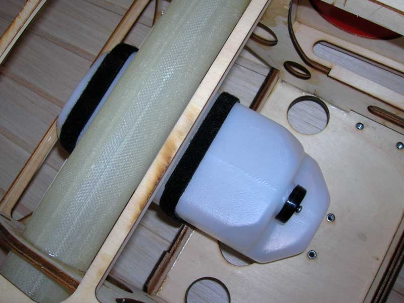

I didn't know about the flex tanks not beign gas compatible til I had a low testosterone moment and read the label...
Here's a couple pics... 1st is a single 20oz tank... thay are about the same height and the 2nd are TWO 20 oz side by side. The two aren't shoved unfrt the wingtube sleeve because I only have that flange cut for a single tank, but shows you if you cut it off all the way acrss they'll slide under there nicely. Add 1/4" foam if you wish and when you velcro or zip down it won't touch the tube at all...
I wouldn't worry about cutting the top part of that former flange til it's flush with the forward floor... lots of interlocking there AND when you epoxy a plate on top let it overhang to catch the floor too and it'll tie it all back in again anyway.
Sounds like the 2-24oz will work too...

Thanks for the pics Maudib. If you think two 20 oz tanks will not be too much weight, I am going to give them a shot. After I verify fuel comsumption, I may go to 16 oz tanks. Apreciate your help.

Me? I think one 16oz is too much... but you guys can know yourself out...
At least they'll be on CG.
I would think a 16 oz on the 80 would get you a clean 15 minutes with time to spare... but 16 oz of smoke fluid is gone in a heartbeat from what I've seen.
This would be purdy with smoke, but with the 50cc it would definitely only fly sport. Dual 24's WOW... 3 lbs of liquid in a 20 lb 80cc plane... 23 lbs wet.... That seems like an aweful lot for 1460 sq in... at least a significant change of flight feeling from start to land.. Somebody needs to invent wingstretcher...

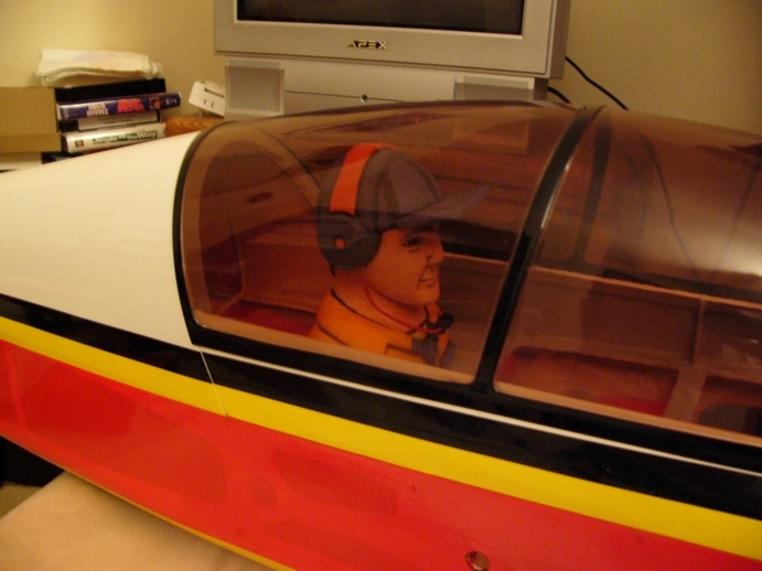

Aircraft International pilot, slightly less than an ounce. I used Maudib's cockpit lightning up, only gained 3.5 ounces. But hey, a little here and a little there all adds up. Also, just before I started building I re-weighed every thing and it had lost about 6 ounces. Hopefully the balsa has dried out enough that it will not absorb near that much again.

Lookin' good Rege,
6 oz WOW, I woulda never thought that.... but that's a really good thing. Definitely a review point...
And 3.5 oz inthe canopy is real good... almost 1/4 lb...
