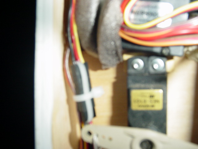

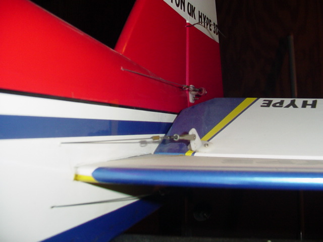

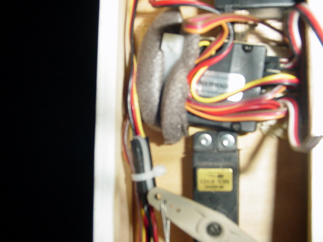

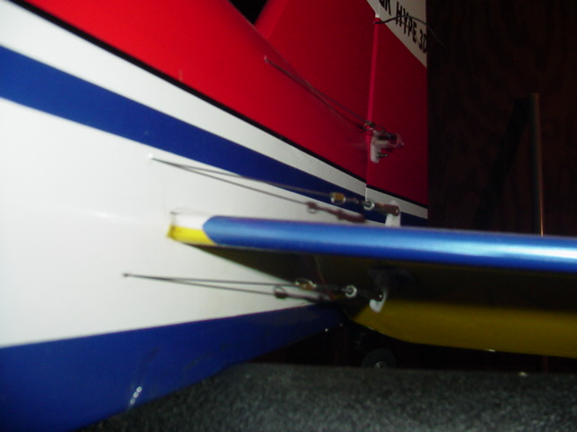

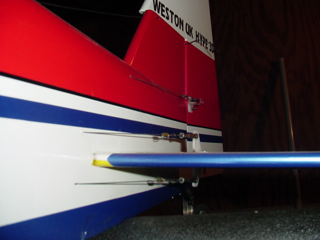

Old 12-16-2005 | 06:04 PM
My Feedback: (31)
Posts: 7,415
From: Kannapolis, NC
Default RE: Modifying Tail Section on Funtana 40 for Pull-Pull
take a look at these pics. i have pull pull on this plane rudder & elevator see if you can see its a pulling action that makes everything work. the bigger servo arm will let both parts more for 3d if you are not going to 3d a standard arm that come with servo will work. look at the pic then hit me up on your ?'s

Old 12-16-2005 | 06:26 PM
Joined: Aug 2003
Posts: 1,920
From: Charlotte, NC
Alrighty then. I got you.
You're pretty much saying, cover up the servo wells in the tail and put the rudder and elevator servos in the fuse near the front just like you have your's? I think that's what you mean.
Also, I see what you mean by 2-3" servo horns. You're talking about the TOTAL length including both sides. I was thinking one that was 2" on ONE side. My bad.
Thanks for the help though.
What would I have to do to the place where you have your servos for Pull-pull? I know that's on he Hype, but I'm quite positive that the servos would come up on the canopy. That's the only place to put them, and when I cut the holes for them, the bottom of the servos would be in the canopy.
Hmmmm??
Thanks again
~Michael~
Old 12-16-2005 | 06:48 PM
My Feedback: (31)
Posts: 7,415
sounds like you will have to see what is the best spot for your set up it may mean putting a hatch somewere to access the servo like how a fun fly has the hatch on the wings sometimes. if so use some 1/4 square to mount your servo in the correct location.
By George i think u have it hit me up if i can be of anymore assistance.
