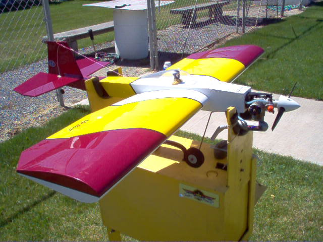

I have the uproar 60. I really like that plane. I build mine as a kit. When I built it I added 1 1/2" to the elevator and Rudder from the hinge line back and 1 1/2" to the ailerons from the hinge back. I did this after watching an uproar 40 at our flying field. I am really glad that I did because this plane is a real animal now. It hovers, Knife's and does several other 3D moves well. It does take some learning to get it to do 3D. Its not as good as most of the 3D Designed profiles out there, but in my opinion is does some other things better, smoother too. I have had my uproar 60 2 years now ant it is one of my most enjoyable planes if not the best 3D plane or best pattern plane. It is one of the most fun planes

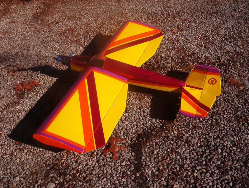

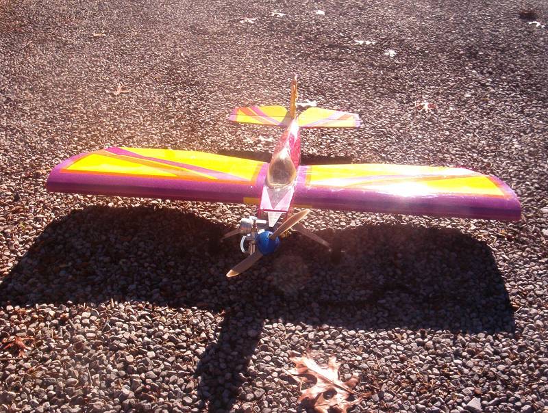

Hi
The uproar is a really good flyer as 65 chevy stated with a few mods. I would go with the kit. I built the 40 size and added 3/4 to the rudder and 1/2 to the Elv. I also added a deck as you can see in the photo. Really simple to do and it will track on a rail. After 2 members at my club saw her fly, they are building one with my mods. If you go with the 40 I will be glad to help you. If you go with the 60 I am sure 65 chevy can help you. I would go with the deck as it aids in the knife and tracking.

Sorry, the photo does not show the added controls. I took the photo before her first flight. After a few flights I put her back on the bench and added the controls. Now, she is sweet!!!!

Thanks for the comment. It is kinda bright on top but all smoke purple on bottom. My dughter thinks I should call it fruitloops. As for the help, no problem.
