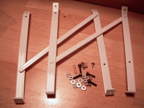

Brown dropped my plane off today and it's beautiful. Or at least it will be in a few weeks once I have it ready to fly. =)
Can someone help me out with the Cabane attachment inside the fuse?
I'm finding that the ARC version needs a little more reading between the lines than the ARF. Some of the hardware attachments that come complete with the ARF are left for the builder with the ARC.
Attached is an image of the hardware I received in the bag with my cabane. Can someone verify that the correct way to attach the cabane to the fuse is to go SHCS, washer, ply, cabane, washer, nut?
And I'm guessing that the rubber grommets and servo-style screws are for attaching the canopy?
Thanks for any help.
