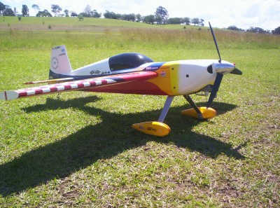

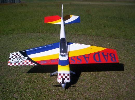

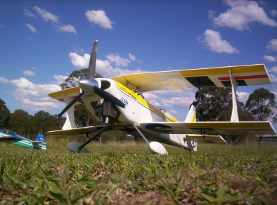

HI i run a 3 blade on my mvvs 58 22x12x3 & its the ultimate combo.3D& IMAC are insane.
its a great set up as i have had my props on this motor.LOOKS ARE A ADDED BONOUS
cheers glen
