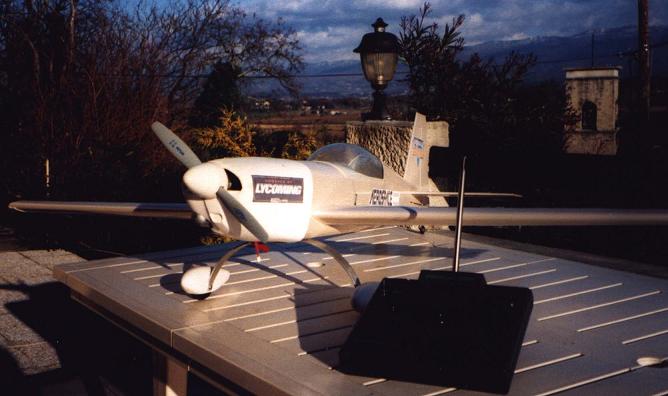

hi - I built the .40 size extra 300 from Great Planes - see pic below
I am pretty happy with it except I cannot get it to flat spin...
I tried, starting from regular spins, both upright and inverted, and what happens is when I decrease the ailerons and start making them opposite to the rotation, the spinning stops. I expected it to flatten and keep spinning... I already read the threads about flat spins but I still can't do it ... Does anybody have the same aircraft and manage to have it flat spin? I need help with the sequence of control inputs, maybe CG location and control throws too...
thanks
I followed the instructions except I replaced most of the sheetings with thinner and lighter balsawood. I can't remember the weight (built it several years ago) but it's pretty light. The engine is a .46fx OS, and with 0% nitro and a 12x6 graupner prop, the thrust is greater than the weight of the aircraft, I get unlimited verticals. I can also get it to make 3/4 of a knife edge loop, which is pretty nice... Only the last part (the downward->horizontal part) fails. It is a very nice airplane, I just need fine tuning to make the most of it.

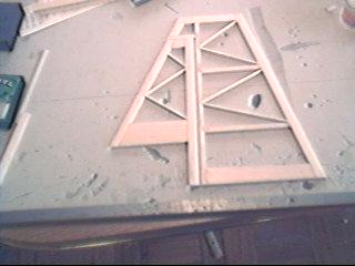

I can already see that people are interested in what I do. This is very must the same reaction I get at the field. I enjoy buying a plane that people already have and flying it better (WITH MODS), I know its mean but its fun. To start with the questions I don't know what my plane weighs but I can tell its to much It would be able to 3d without mods if it were lighter. Da king I think that your elivator looks good try it because you can always go bigger. And Walls are doable but dangerious the third flight a gave one a try and broke the stabilizer the only thing holding it on was the monokote. Luckily I was able to get it down without a problem. So I put fling wires on it and haven't had a problem. Da king what engine are you going with it better be big! This bird is TAILHEAVY.
Capnic The elevator was crazy and alot of work I moved the stabalizer forward added an inch along the entire span and on the sides of the stabalizor has the elivator to WATCH THE FLUTTER. Rudder I added about two inches to the top (TALL) and about 4 inches to the bottom (WIDE) But the shap stays the same. I will try to get som pics but no digital or scanner If you want I can make a diagram in paint shop and send it two you with the dimensions. And last the weight on this plane is bad so lighten it or else. Any answers to My question???????????

I did cut the elevator for 45 deg throw. I plan on taking wieght out of the tail and the nose too. a lot of it will be out of the tail. I think i know why it tail heavy so i will fix that when i get to the fuse. I just sheeted the wings so all i have to do is join them and then i can start on the fuse. HERE COME THE DRAMEL!!!!
