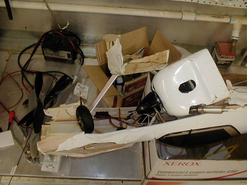

just incase you didnt see my other post . will be getting another soon this one bit the dust . guess i could not avoid that bad spot as you can see ..[&o]
