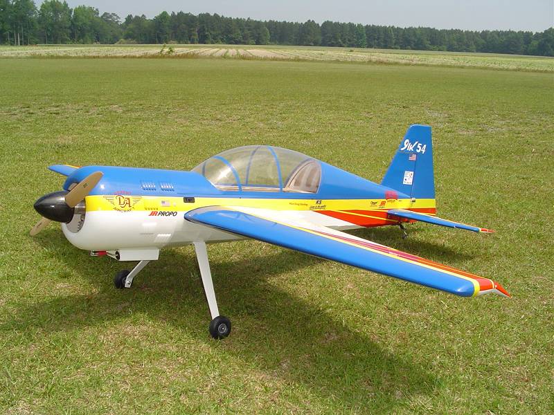

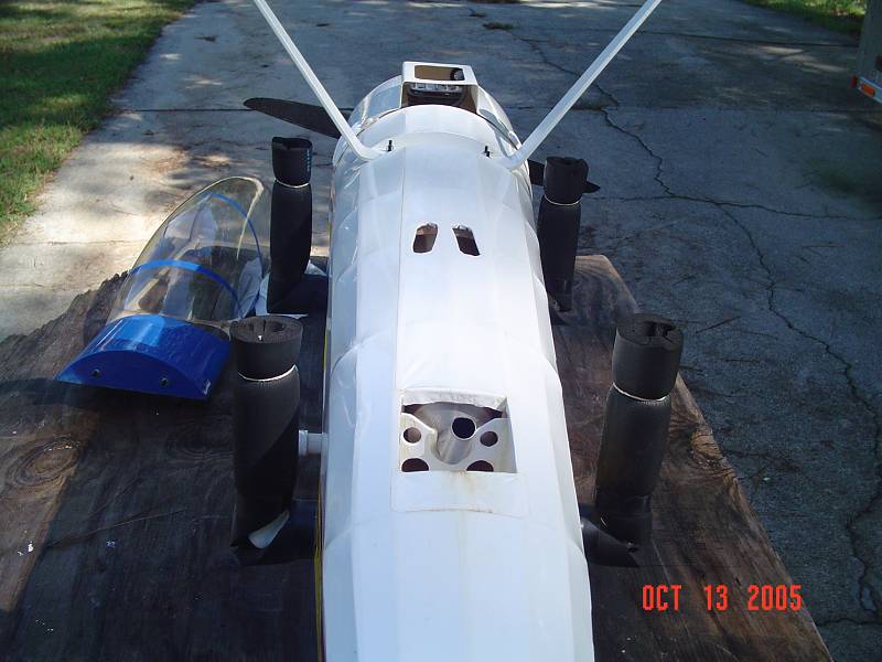

Default RE: Tune pipes
Like this?
This is a KS full wave tuned piped set up.
ID:	438143   Click image for larger version
ID:	438144   Click image for larger version
