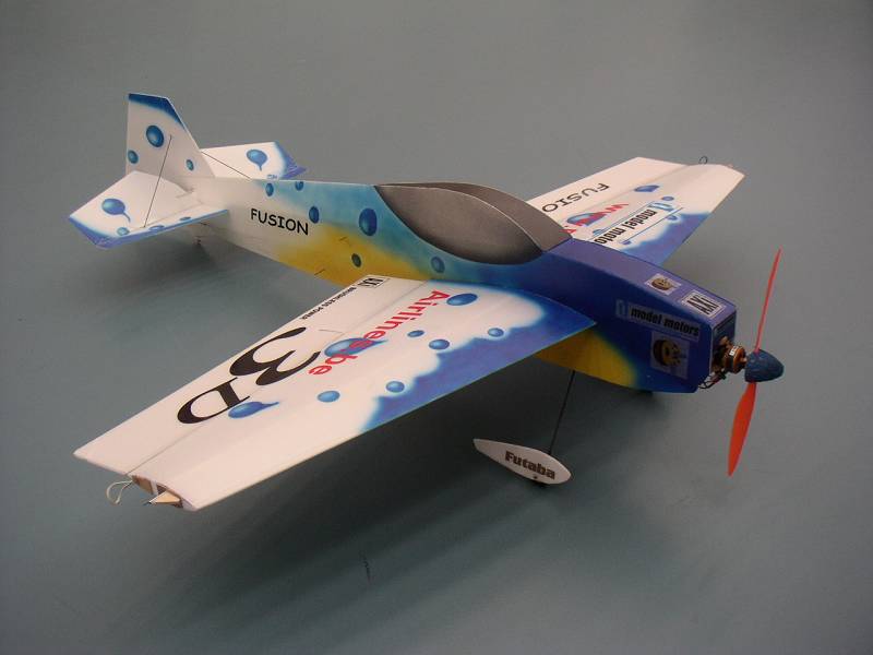

Hello Guys, I am Benoit Dierickx from Belgium.
I am really happy that you enjoy my flights.
I am very honoured by your nice comments. I thank you.
My freestyle plane is the "Fusion". Yes indeed, it got a fuselage, an airfoil and thrust vectoring.
Cheers,
Benoit

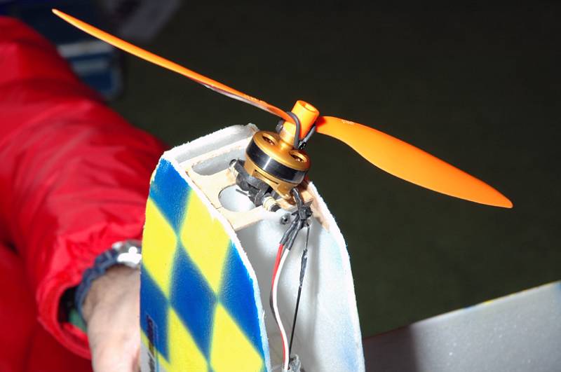

About the fusion set-up: 97cm wing span, lenght 105cm , weight 230/250gr with 3x li-poly Kokam 340 to 640, motor AXI 2204/54 GOLD LINE, prop GWS 9/5, Phoenix 10 controler from Castel Creation, 6x waypoint (6g) servos ( 2x ailerons, 1 elevator, 1 rudder, 1 thrust vectoring) + 1x 4gr servo for streamers), GWS6ch 72Mhz receiver (modified to 7Ch)

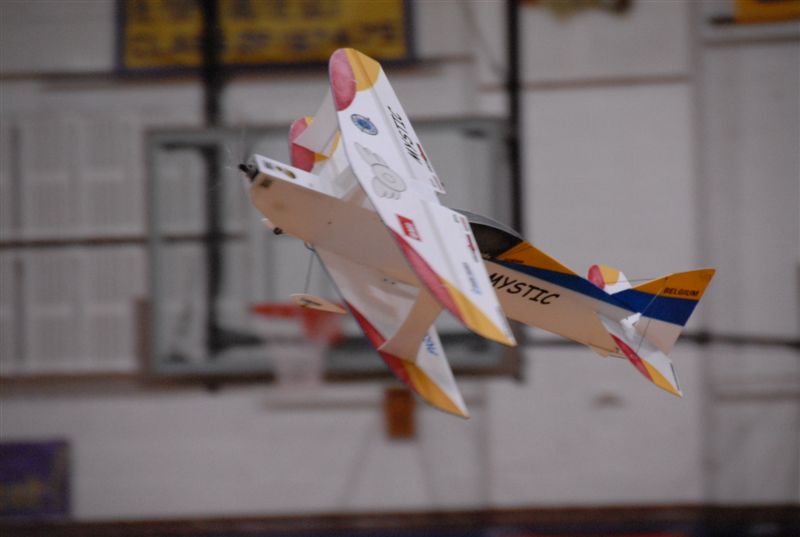

Indeed, the plane is very solid and precise on the trajectory if you can hold some speed. Nevertheless, for F3P, a biplane like my Mystic (Donut's model) will be more efficient.
But the Fusion is more reactive for freestyle, especially with the Thrust vectoring system which give a terrific yaw control. The motor is on an axe (or gimbal), and it's just mixed with the rudder. It's difficult to make a kit with such an airfoil. The plane is fast and fragile. But we are working on it. May be a 10% smaller plane will be better. Stay tuned!
