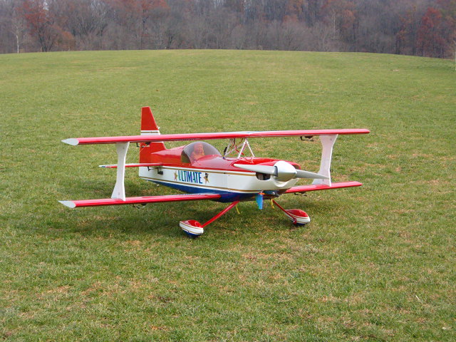

Is the LG strong enough,looks like its bending just sitting there?

The landing gear is plenty strong on this plane. For some reason the camera makes it look "squaty". My pictures look the same way. I think it's because of the way the gear sweeps back. It's not landing gear is not bending. It's make of fiberglass. It flexs nicely without breaking. I really like the LG. It stands up plenty high for my 21" prop. Even on a couple of bouncers I haven't had a prop strike. The landing gear is one of the rather nice features on this plane. Like bubbagates says, "Great Planes got it right with their performance series airplanes.

Mix,
As Barry said, it looks flexed but it's not. This landing flexes just enough to turn a not so good landing into something nice and smooth. If you bouce this baby into the air, you either hit pretty hard or really came in hot.
The gear on the Ultimate looks the same way. It's exactly the same gear including the bolt holes except they are red. I have a spare set of the red and tried them but it just did not look right, see the pic. It's an old one, there is now a Brison 3.2 on it with a CF prop and spinner.
