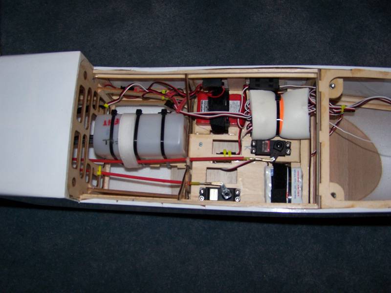

I did not go with redundant anything. The only thing I did extra was to install the smart-fly opitical kill it weight a total of one ounce and if you have throttle servo trouble it gives you a way to kill the engine in the air if you do not have a choke servo
I always say do what make you feel best. While Hoss knows what he is doing, sometimes you canot get to wild with things.
Here is my complete setup. My personal preference is no redundancy once I get below a 50cc plane. This plane is not really a 50cc, I'm just using one for it
DA50
22x8 PT models CF prop
Fromeco 2400mak Li-ion on the igntion
Fromeco regulator set at 5.2 volts
Fromceo Badger Failsafe Switch
Smart-fly optical kill for the ignition
JR2000 Scanselect receiver
Fromeco 4800mah Li-ion for the reciever
Fromeco regulator set at 6 volts
Fromeco Failsafe Badger switch
Hitec 5945's all around
SWB dbl lock control arms
Dubro ball links on the servo arm
Dubro Kwik lok safety links on the control horns
H9 Titanium control rods
A lot of the above is overkill but that's how I like things. The Failsafe switches are electronic so there is no moving parts, if they do fail, they fail on not off. There is no choke servo as I have a nylon rod connected to it pointing to the front so I can just pull it to choke it then push it back in to open it.
Total weight according to my Escali scale is exactly 14lbs 4 ounces, I just weighed it. Wheel pants are not installed but I am going to do that since I have more than enough power now so add about 4 or 5 ounces

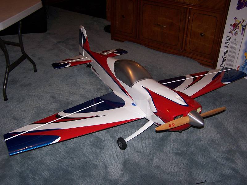

Here's my setup and weights with a partial built aircraft.
EVO45GX
21x8 NX prop (trying to keep revs up to about 7000 for my elevation)
Evo electronic ignition
Hobbico 4.8 1650 mAH battery for ignition
Hobbico 4.8 2000 mAH battery for radio
Great Planes kill switch
G3 Super Hummer 12Z Futaba receiver (2048 PCM receiver with all channel availability)
Hitec 5945 servos on all surfaces except throttle
Hitec 5475 on throttle
Carbon fiber pushrods on all surfaces with "Cazier made" steel ends
Dubro 4/40 clevicies
Dubro 4/40 ball links (very cool pushrod set up)
Weights on next post.

Weights on partial built aircraft...
Fuse with all servos and pushrods and servo extensions installed: 54.6
Wings with servos, pushrods and extensions installed: 42.0
Cowl, uncut: 8.8
Wheel Pants: 2.6
Landing gear: 6.8
All 3 wheels: 2.8
Hardware, axles, blindnuts etc, in bag: 5.2
16 oz fuel tank with fittings: 2.2
Supplied aluminum spinner with hardware: 5.2
Canopy: 3.8
NX 21x8j prop: 3.8
Evo 45GX with ignition: 54.2
Receiver: 1.2
Throttle servo: 1.8
Ignition battery: 4.0
Radio battery: 5.0
Total (if I added correctly): 204.0 ozs/16 = 12.75 lbs
I will drop the wheel pants but I'm sure I've forgotten some items, but right now I don't know what they would be. I might actually get in at 13.25lbs. But surely I'll stay under 13.5 lbs.
This gives a wing loading of 26.6 ozs. From what I can read, that is a good wing loading. But I have planes as low as 15.5. But all the bigger planes seem to be in the mid 25s to 30s. I think this should be alright, but I'm looking for opinions. What have I forgot?
Barry

Finally...
I'm all done with this bird. I must say I'm very impressed with the build. No I got to get busy and do the maiden flights. I had to use valuable flying time to get the thing built so I haven't flown yet but I expect to do that some time this week.
Here's a few pictures.
Barry

Here's the plane itself.
Barry

13.5lbs WOW, is that gonna be a blast.....Nice and clean install, looks great....
He I just noticed, you put the stab on correctly
