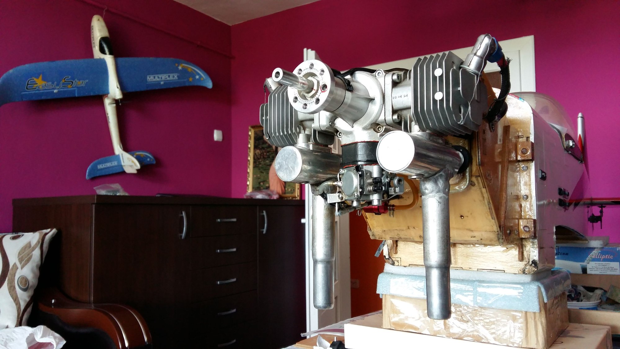

Thank You! I've made the baffling from cardboard and barbecue sticks then epoxy them. Since I've only had single cylinder, I've thought that a twin will look nice on this plane since it is designed for that. I've fitted a working parachute on it too. to bad it's not made anymore

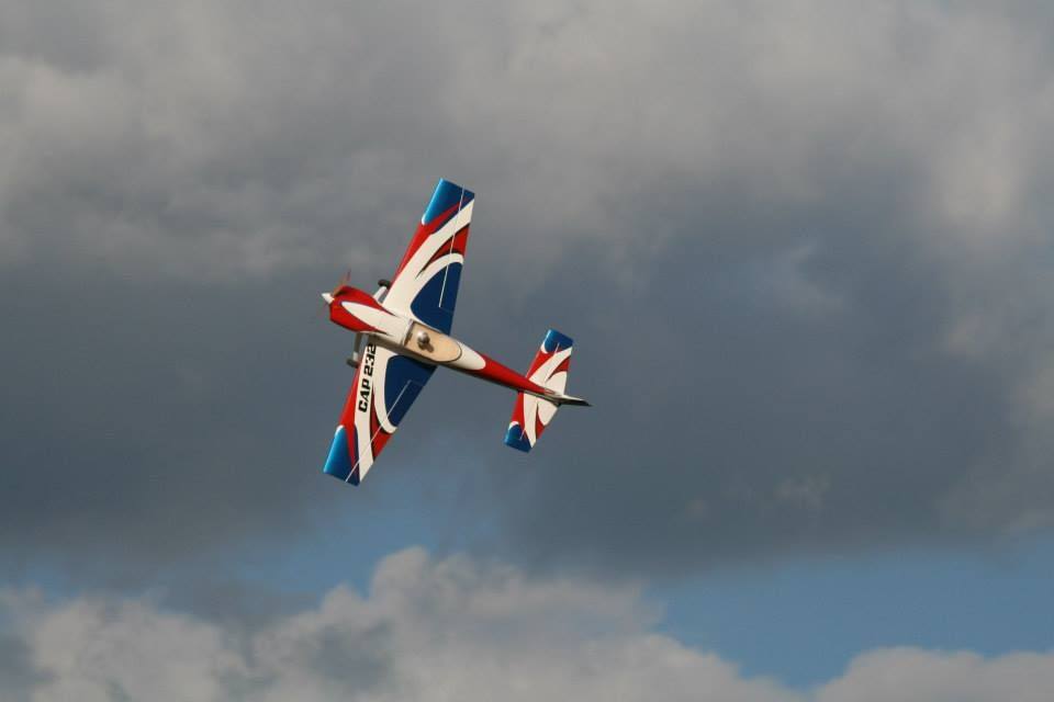

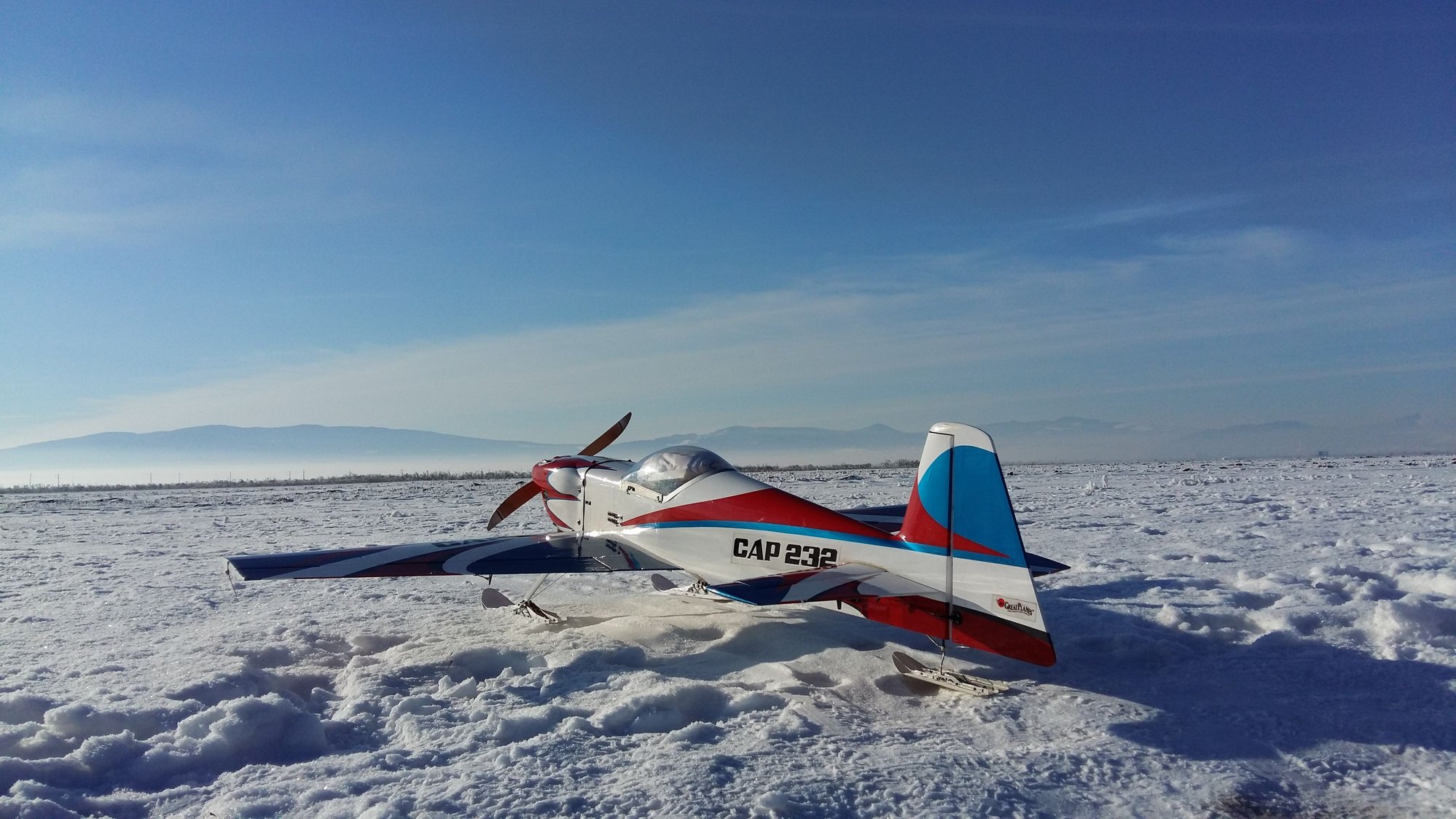

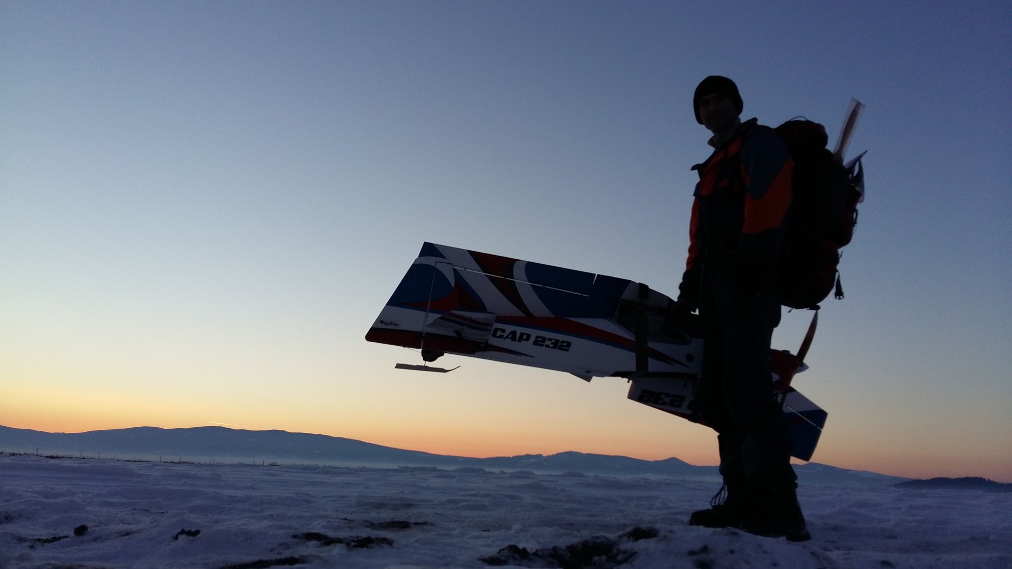

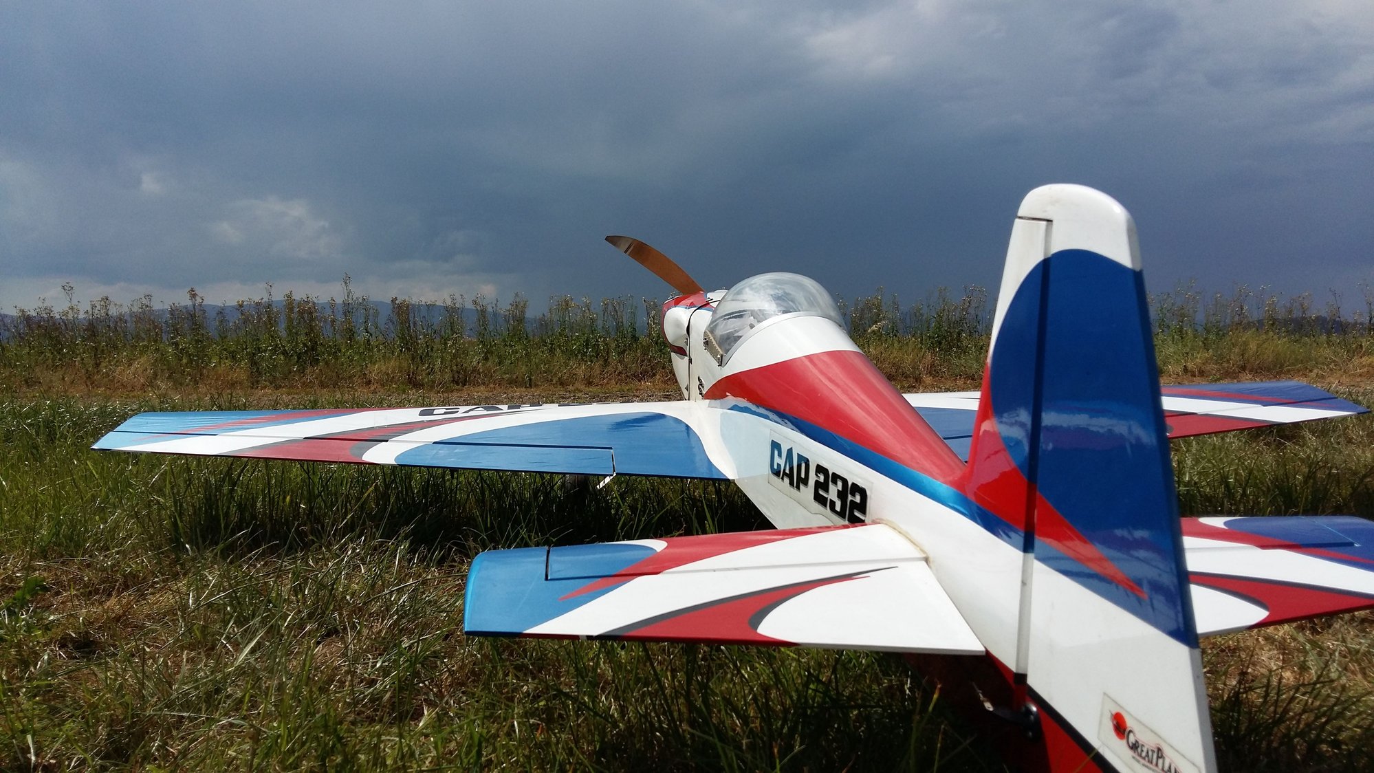

A Great Plane!
Anyone still flying this plane?
Enjoying nature between flights
Time to go home..
Snow blast.
The end of a great day..
A dream..
..the other side of the dream
hovering
knife edge
XYZ 53cc 5,5hp twin engine. 6700rpm with the 22x8 prop and bohr (bowman) rings.
My pilot is a 3m working parachute that saved my plane once. A dream project that brought 350g to the plane but worth it for me.
