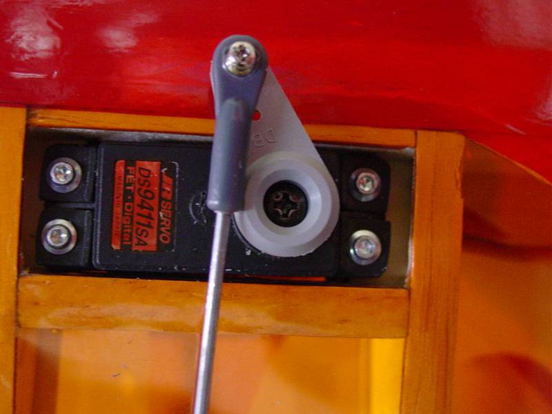

Has anyone got any experience with putting four servo's in the wing of one of these, I am thinking of using four so that I can get opposing movements for some extreme manouvres, I have the fibreglass fus version that I am just about to start building.
Mike
Mike
As no one has replied I assume I must be the first to do it, therefore below are the pics of the finnished plane if anyone is interested I suppose I could explain how its done.

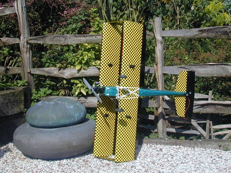

To ALL
Maidend the Panic on Saturday, did I have the thrust lines wrong, it left the ground and went straight into a nose high hover, opened her up to gain height and lowered the power immediately the plane leveled into a very low loss of height glide, very easy to bring in at my feet, played around with the downthrust, aileron and flap reflex, it now fly's beutifully, flat spins onto the deck, I am thinking of putting an undercarridge on the top wing just for fun, this thing is a hoot.

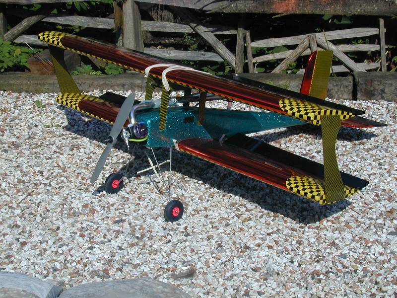

i have a panic the wood fuselage, its very heavy and im running a .91 engine on her. It's to heavy to do any maneuvers properly so i use it as a sports model
Michell91
Mine weighs 6lb9onz dry with a Jen 56 and pipe in it the performance is stunning, how much does yours weigh? it must be very heavy if a 91 does not do it for you.
EDIT: just a thought what prop are you using, I have a 14.5x4 Graupner Cam prop specially designed for IC 3D, it may be you need a different prop to get the thrust needed for good performance on these things, I would have thought you would need something in the region of a wide blade 15x4 or maybe 16x4 at least.

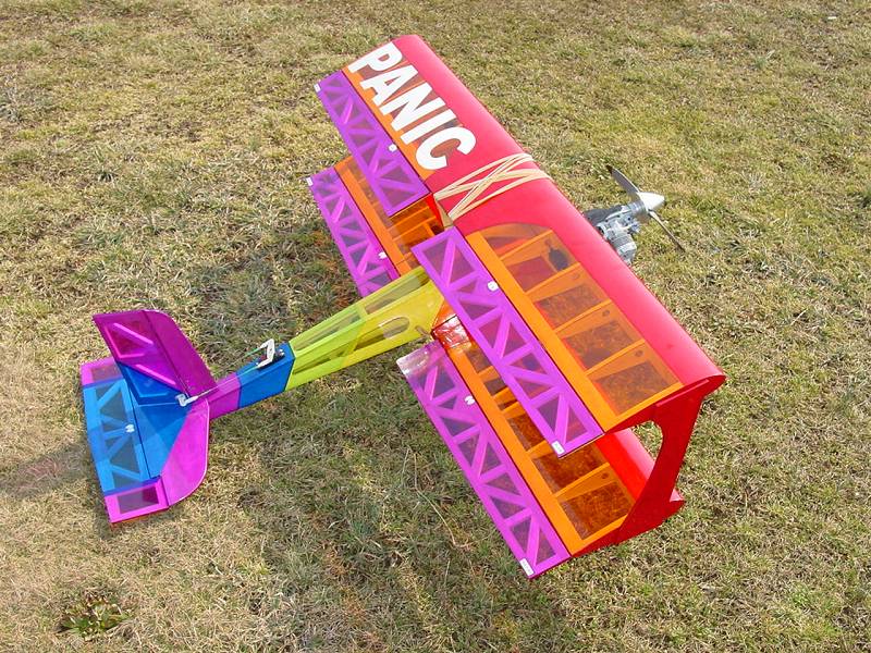

I go back a long way and a couple of countries with the PANICs. Just when I thought I was over them they came out with the ARF version 25th Anniversary edition.
After some Euro conversion pain to US$ one arrived in New Jersey!
I noted that it was lighter than my many previous versions and that it used a connector to the top ailerons.

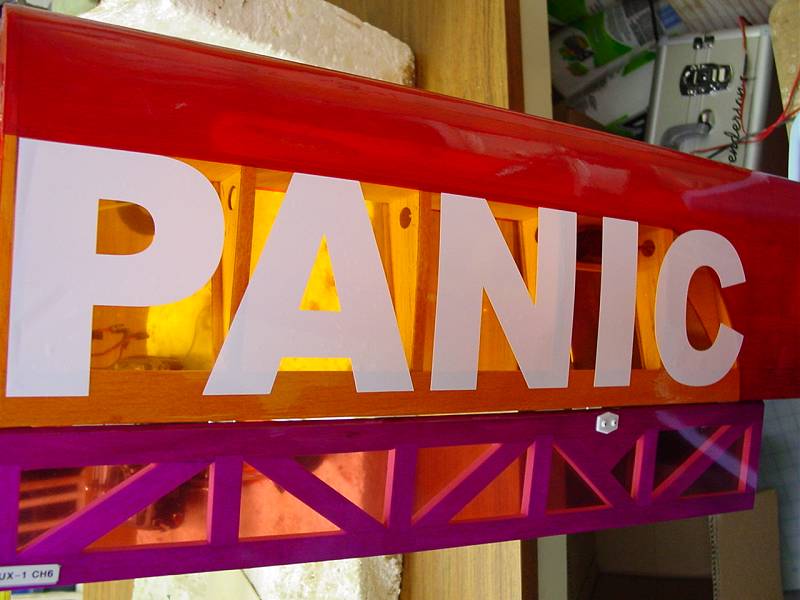

I cut a small opening in the covering and slid a ply-plate trough it. A little bit of "Ship-in the-bottle" technique and the plate was epoxied in place. I ironed teh existing covering onto teh plate and it was done. There are existing holes in the ribs that allow you to feed a fuel-pick-up-clunk through on some tread for the aileron lead routing. You need to cut two new holes in the lower surface to make exits for the servo-leads.
I programmed the JR 10X to do to do Bi-plane Crow, which is both top ailerons up about 30 degrees and both bottom ailerons down about the same.
I put a trim knob mix on the elevator so that I can dial the right amount of elevator correction during flight-testing. The trim option is on the same switch as the crow activator and once etablished the auto-down-trim will be dialed-in for keeps and the elevator trim knob/mix disabled.
I also did a similar mix for the top two ailerons to be a regular down-flap for slow almost hovering landings.
You can also try some pretty funky stuff with the ailerons only dropping on one side for climbing type spins, but you need to be wary of that switch near the ground - wonder how I knew that :-(
It's a bit cold right now, 17 F or approx -10 C, so I'll just have to wait for some sun. This plane was a 3-D ship that was way before its time and even though some people claim that they are ugly they still look beautiful to me!

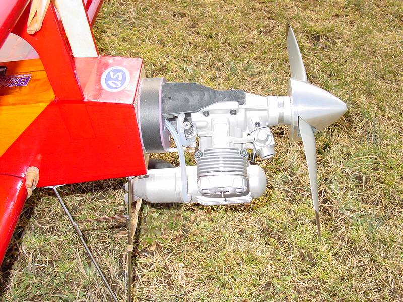

We had 63 F in NJ today. The rain never really showed up although some wind did!
The OS 61 started up easily and one tank of fuel had the engine running reliably and with a good idle. The wind was so strong that it weather-vaned the Panic immediately upon thottle application.
At 1/4 throttle she left the ground in about 2 yards. She flew easily and felt as comfortable as an old glove. I had PANICs in the UK back in the late 70's I think. Then in the 80's in MA. One even flew in the 1985 Westover Nat's as a last ditch substitute for a lost pattern plane. The last one had an ENYA R-120 on the front. The nose was shortened by 3" to get a good CG. (No nose fwd of the cabane.)
Tried all the rates and a couple of spins. I could not count the rolls on high rate. Most of the flying was devoted to dailing in some auto-elevator trim for flap and for Bi-plane-crow. I used trim knobs mixed to the elevator and controlled by the flap and landing switches. Once dialed-in, the elevator settings were measured and then permanently mixed to the flaps etc.
The top flap needed about 1/4" of down trim on the elevator. The Bi-plane-crow actually needed some auto-up-trim!
Landings were very slow and two crosswind "arrivals" were enough to call it a day. Monday looks less windy.... then we'll have some fun

I can hover this Panic way better than my foamies. I only wish that I had known that I was supposed to develop that skill back then! (Even bigger grin!)
Regards,
Eric
ORIGINAL: piroflip2
hi BALDEAGEL
I too have the ARTF Panic with Saito 82.
ballistic vertical and wild 3D.
It is the easiest to hover model (including foamies) that I have ever had!!
Don't know if this is any use to ARTF Panic owners but my (and a club mates too) kit supplied bands snapped after three or four flights,,,,,,,YOU HAVE BEEN WARNED.
hi BALDEAGEL
I needed an April flight, so on Sunday the TX and the on-board 1500 mAh Li-Po RX pack was charged and we were off to the races!
It was not too windy although a bit chilly at 45F. The OS .61 is broken in now so some full throttle stuff was in order. I tried a few different props and finally settled for the 12 x 5 APC. This got me up high enough quickly enogh for some ridiculous spins....
I put the rudder on max-rate and the elevator and ailerons on low rate. After entering the spin the throttle was brought up to full power. The elevator moved to full down and the ailerons slowly reversed. The spin was a sight to behold. You could take your eyes of the plane for quite a while to give your neck a rest. It just kept in a very flat spin and slowly descended. The sound of the engine told you where it was at all times.
I tried lining up for a runway-spin-bounce several times but the breeze drifted the plane over the "tall-stuff" each time. So I settled for some Biplane-crow dives from a great height. The Panic needed some auto-up-trim when the crow was deployed. Once that was dialed you could dive stright towards the runway and pull out at about 6-8' and land in less than a few feet.
A more conventional flap that I use is top ailerons down only. This lets you "walk-the-dog" down the runway. Very slow flight with the nose help up. I
I don't get a very axial roll - might need some throw tweaking on the four aileron servos. It does do a great very-slow-roll however.
Spent a lot of time doing KE loops and pin-wheels. It needs some down elevator when the big rudder is applied. Might use an exponential mix instead of the std code 66 [JR speak]
I am looking for some old pictures of our USA Panics when we threw Enya 120R's etc on the front.
Back to the grind.
Regards,
Eric.
Back to the grind.
Regards,
Eric.
