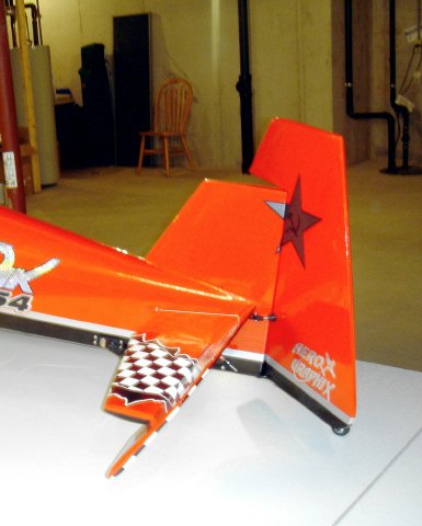

I have a BME 30% Yak, 8611's, Dubro HD stuff, CF rods, ball links on servo end. I need some procedures/ideas on how to setup these so that all three rates are equal on each side.... When I set High rates, matching both ATV end points, then my lowest rate isn't exactly both down/up...If I tweak ATV to minimize differences on LOW rates, then the others have errors.
I have already done most of the usual things, just would like some procedures/ideas from others who have had to solve this in case I've overlooked something in my setup.
BTW - I am not troubled with RATE of deflection, that's fine between the two servos.

Bob,
Assuming yopu are using dual rates or even triple rates (flight mode on JR radios). Is it possible to set the end points for each rate on each surface. I know in my 10X that is possible so if I cannot get exact mataches using the standard mechanical means, then I'll configure it in my dual/triple settings. The only thing I cannot change is neutral, but normally that is not a problem.
OK now for the most common reason I have found that I can usually correct without changing the radio setting amongst the flight modes
Usually, the servo arms are not aligning exactly the same on each elevator half or when dual servos or more are on a single surface. This will then make one control rod longer/shorter than the other. Sometimes when I measure them it is only a few millimneters but it really makes a difference in extreme throws.
Another thing is are both servo arms actually traveling the same distance in both directions. I've learned to use a paper protractor taped to the wing with the center line of the protractor lined up with the servo output arm. I then get a servo arm the allows itself to be on the protractor centerline when installed. I then power up the servo and move the stick in one direction to full travel and look at the angle. I then move the stick to full in the opposite direction and look at the angle. They should be exactly equal. This takes a bit of work and if you are using hitec servos it is easily prgramed to get the exact same angle in both directions.
Once I have that set, I will then get a control rod and get the ends I am going to use installed and connect everything up. I'll adjust the control horn height and control rod until I get the same throw in both directions, all the while I am still making sure I am getting the exact same throw on the servo arm in both directions. If that changes, I am most likely getting some binding somewhere in the linkage. If I am working with a surface with 2 or more servos then I do the exact same with the other servo taking inot account that if I did the innermost servo, the next servo going outward may beed less arm throw due to the wing/aileron/elevator getting thinner but still maintaing the same through as measured at the surface.
Ince I get all of this matched up then I can bet that I will not need to change anything in the radio except to lower the total percentage for low/middle and high rates.
I know it's a lot of work, but it works well and you will be rewarded with a plane that does not eat servos, longer lasting batteries and in the case of the ailerons, great rolls and in the case of elevators, the exact same travel for both in all condition

Bill, Alan - Thanks to BOTH of you.... there's some good stuff coming out of this, and helping me understand things a little better.
I guess the FIRST dilemma/question is - How do I *KNOW* the servo arms at NEUTRAL are 90* to the chordline of the stabilizer/elevators? (I understand that having them 90 relative to the servo case is meaningless) ??
Assuming that finding that, mechanically, is pretty important, AND that it's done with the least amount of subtrim possible?

Sillyness posted this a while ago. It worked for me on 2 different planes. You only need to set your ATV and subtrims. Both elevator halves track evenly throughout their travel using the "stick method". When you are finished you will notice that your servo arms are angled back just a bit. I use JR 10x w/ 8611 and 8411 servos on elev.
"Set your ATVs to approx 130% up and down (130% is for JR... may need to use slightly less on Futaba or Multiplex) to allow room for subtrim. Then I roughly center the surface with subtrim. Measure up and down throw. If you have more up than down, then shorten the pushrod (and vise versa). Now, re-center the surface with subtrim, but do not touch the ATVs... leave them alone at 130ish%!!! Re-measure up and down throw and repeat the above proccess until the surface moves the same amount up and down. Your servo arms will likely be tipped slightly toward the rear when done, but it depends on your geometry. If you end up using excessive subtrim you may need to rotate the servo arm 1 spline one way or the other. Look at your servo monitor page to make sure you aren't over-driving a servo (i.e. a servo stops before the stick reaches full travel).
The result is a setup where both halves will travel at exactly the same speed and they'll track together perfectly throughout the range of motion.... very linear. Mixing out the differential in the radio CAN give you a setup where the surface might match at the ends, but they are off at in-between throws. Been there. "

jon595, bubbagates - this ATV thing seems to be the solution, and I just basically finished duplicating that "no sub trim, high ATV" that is on the downonthedeck website.... works VERY well.... BUT...
If you're measuring REALLY closely, the travels are NOT identical for two of the three rates. I can get BOTH up and down to be VERY exactly matched, but only on ONE of the rate settings. The others are close, but very slightly off at on or the other end points.

BTW - not being argumentative, here - but SOMEBODY 'splain to this simple Okie how the LENGTH of a pushrod (clevis to servo arm distance) effects TRAVEL? I ain't seein' this one, boys, and I need help.....
My Feedback: (32)
Lets assume we are working on dual elevator servos and you have the same length arms on the servos and your control horn connection on each half is the same distance from the surface.
Now lets take a control rod with ball links on both ends and the total distance from the center of the hole to the center of the other hole in the ball links is 3 inches for both setups. With 1.5 inch servo arms you might be getting 45 degrees of throw
Now lets take the rod on the right elevator and turn one of the ball links 1/2 turn outward. You have now moved that surface maybe 1/16th of an inch up. So now you adjust the subtrim to conpensate and recenter the surface. Now remember your right rod is just a bit longer.
Ok so now you do the stick trick and notice that the right side is getting to full through faster because the rod is longer but you adjusted your ATV's to get the same throw which you do get but the plane now rolls slightly right in the air because the longer rod is moving the surface to full travel faster. The reverse is true when inverted or the rod is shortened
Hope this splains this for ya
(Head and sheetrock softening now....no hair remaining.... torch at the ready.... )
Now, they looked perfect with the naked eye, but with the long stick trick I could get the high rates to match exactly.... but when I set the AFR and dual rate (futaba 9Z) I could not get them to match perfectly. I could get them close, to within 1/8" on an 18" long stick but not exact. I measured and remeasured pushrod lengths and control horn settings with a vernier caliper and they were exact. But the darn throws would not match up. As you said, I could go back and adjust for low rates, but then the high rate would not match. More head banging[:@]. I never really figured that out. I just accepted that 1/8" at 18" om low rates was just EXTREMLY close to perfect and dealt with it. Since I started programming, that became a non issue..
I just dont know and never figured out exactly what the problem was. Was it a servo resolution thing? Was it something to do with using subtrim? The ATV's were the same,,,, I just dont know? IF you figure it out tell me. That is what drove me to programmable servos. I have gotten pretty doggone good at setting up matched deflections mechanically, and what I considered imperfect some may have considered spot on, I dunno.
That slight difference seemed to make no difference on low rates for precision flying, but it made a big difference if I left the offset on the high rate. It would cause lots of problems like dropping a wing in a wall, hard to manage waterfalls, wingrock in harriers. Stuff like that so I always perfected the high rate.

bubbagates and Mike East and jon595 - ya'll have put "School in Session", and very patiently explained to me how to fix what I was SEEING, but not UNDERSTANDING. I have just "fixed" my BME Yak, and it is now WAY close enough on ALL three rates (yep, I fly using all three)....
I'll translate, so ya'll can tell me if I "got it".
Because of minor mechanical issues - hinge line to servo center, differences in parellel "height" of servo shaft to control takeoff, and differences in the control takeoff itself (even getting them the same distance away from, and OVER, the Hinge Line), the system introduces what I will label "radially-induced-rotational-differential".... Because the attach point is pivoting in an arc, and the control point takeoff is moving in an arc, we got troubles in the RELATIVE RATE OF MOVEMENT Have I got it so far?
So.... the long stick (or cf rods) to align the mechanical "neutrals", then tweaking the sub trim to change the REQUIRED LENGTH OF THE PUSHROD TO KEEP THE MECHANICAL CENTER, causes the need for "sub trim".
The sub trim changes, in combination with changing the length of the pushrod, maintains neutral "zero" mechanically, and corrects for the radially-induced-differential from the servo arm movement.
That's the ball game, right????? Game, set, MATCH. THANKS TO ALL OF YOU!!!!!!!!!!!!!

My Feedback: (32)
So if I read that correctly, you found the control horn connection not on the hinge line...Ya know, I forgot about that part
In any case, it sounds like you got it and learned a few things along the way. Even drilling for a 8/32 rod into the surface and not drilling perpendicular to the hiinge line, meaning straight up and down can really make things hard.
ORIGINAL: aerobob
Im rambling. Bob I am pleased that you got your surfaces all lined up. Its a great feeling to get that mess straightened out.
I know you are a thinker when it comes to this stuff. Just curious, there is another facet to this. Are you already aware of the advantages of using the shortest servo arm and longest control horn you can get away with and still get the max throw you need so you can leave your endpoints maxed out and gain maximum resolution? This is another biggie when it comes to 3D setups, maybe even moreso than pattern. And it is REALLY important on the throttle. Speaking Futaba, you should have you endpoints on the throttle at no less than 120/120 so that you take full advantage of servo resolution. If you are dialed down to 100 or less (of a potential 140 Futaba ATV/Endpoint) your thottle will work, but the transition will be much "jerkier" (is that a word?) and its a lot more sensitive especially in a hover. What it gives you is a setup where one click of throttle up or down does not cause you to rise or sink. It is very smooth and gives you some room to work the throttle. If you get it right you can make very sutble moves on the throttle to really zero in on a spot where the plane will settle into a hover. This is something I did not know until recently, and when I got it right I went from hovering 10-20' off the ground to being comfortable bring it right down to all but a tail touch. It makes a big difference.
For my BME 110 throttle arm, I took a big hitec servo wheel and shaped it to the right length and position so that it was plently long enough to get the resolution I needed and where it would give me linear response. I know lots of guys are making their own arm out of composite materials and carbon fiber sheeting as well.
