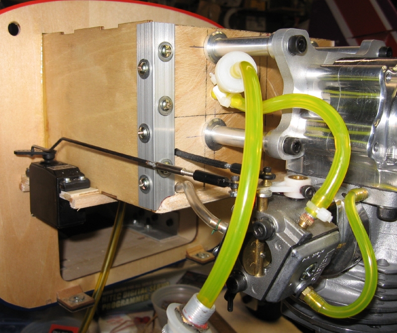

Been awhile, but I've been BUSY
She's DONE, except for canopy; waiting on instrument panel. Have to do final placement of batts for CG, but it is finished.
Brillelli 60 in the nose, with Scott's custom wrap-around Pitts style. Has a GREAT tone - no bark, but good, throaty "Brillelli Sound".....turning the Xoar 23 x 8 right on up there. Didn't tach it yet, first run, but it's a good un.
Put in the Hitec 5955TG's all around, and have to tell you those are terrific servos. Used some titanium 4-40 links from Tower (actually from an Associated car something-or-other, but they are 4-40, and seem good to go) for the elevators. Standard short 4-40's on ailerons.
The fit on everything is just outstanding. Cowl aligns perfectly, and following the calculations for the firewall locating, have just over 1 mm spinner gap. Love it.
Here's a couple pics - more later... Don't have weights yet, either, but I will.

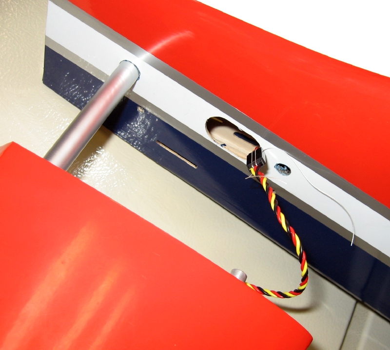

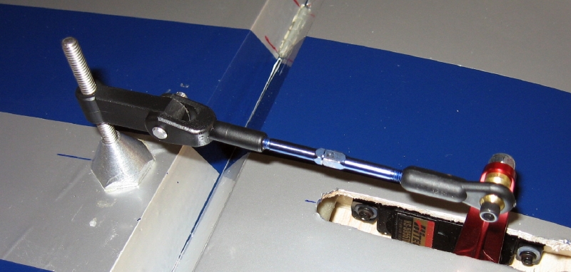

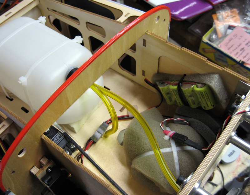

As pictured, the elevators prolinks are 2". That ensures about 3/8" thread (or close to it) in each end, both clevis and ball link. They are from Tower, Associated Car parts, blue anodized. Look pretty good, and work.
Batteries are mounted to the front of the half-bulkhead just aft of the sloping tunnel housing. Don't know if that is the stated 6.5" aft of l.e. at fuse needed, but will check that tomorrow.
One word - the hinge slots on the inboard dual-hinge slots on the ailerons were pretty large oversize! I used Gorilla glue, really cleaning frequently while curing, but after could see that the glue had expanded appropriately to really make them solid. ALL of the other hinge slots were just fine.
I have NO beefs - ANYPLACE AT ALL - with this arf. VERY very nice quality.

I used EVERYTHING out of the kit, EXCEPT the control stuff. I used the Dubro HD #866, (I think) with the 1/8" alum pin for the nylon fork clevis. They come with good 8-32 bolts to mount in hard points already installed. Then the Associated ProLinks for elevators, and just a short 4-40 all thread (stainless) for the ailerons. Rudder tiller arm is the Dubro HD setup, too, it has angled cup washers to get things right. Dubro 4-40 ball links on all servo ends, Airwild MLP servo arms, 1.25" for ailerons, 1.5" for elevators.
The tank is stock, landing gear and hatch hardware stock, cowl mounting stuff - it's all good quality stuff, SAE threads.
I used the Sullivan HD tailwheel because I like the coiled spring on the wire.... lets me drop the tail without breaking stuff... have that on my GP Ultimate, and really like how it has held up.
(The supplied ball links and clevises and control arm screws MAY be just dandy - I just have a bias there toward the Dubro stuff)
