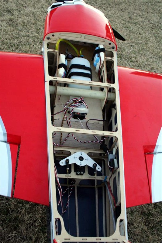

Just about finished today. Still need to mount the switches and batteries and a few details. The AUW came in at 15 lbs 8 oz with all the gear. I did use a CF landing gear, 16 oz tank and a CA aluminum tailwheel. My final weight might vary if I add a pilot and change the spinner to fiberglass or CF. The instruction manual is OK but not awesome. If you have built some ARFs then you should not have any issues. There is an error in how mount the elevator servos. The manual shows to mount them on the side of the fuse. They actually go in the elevator halves. The gear is a follows
DA50
Pitts Muffler
3" standoffs
Rudder HT 5955
Elevator HT 5985 x2
Ailerons HT5945 x2
Tail wheel Chief Aircraft billet aluminum
Fromeco Relion Batts 2400 mah x2
MPI switches with regs x2
Slimline fuel filler
Mezjlik 23x8 CF prop
Dubro 16 oz tank
Dubro aileron setup
SWB 1.25" servo arm x2
Airwild 1.5" servo arm x2
Stock spinner
Stockwing tube
Stock stab tube
Old 11-04-2006 | 01:17 PM

Here's my weights sheet .... http://www.rcaerobats.net/AM_EXTRA/ExtraWeights.htm
Nearly TWO POUNDS difference!!!!!!!!!!!!!?????????????
UN-believable.........but LUCKY YOU!!!!!!!!!
It will be AWESOME at 15 - anything, for sure!

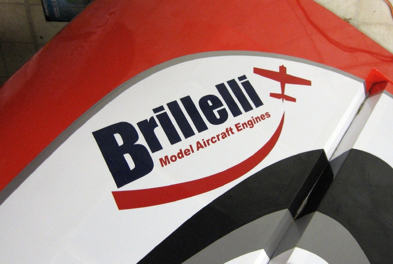

Attached is a "logo pic" of my custom Brillelli logos on the wing from http://www.badbradgraphics.com
Pretty good looking logo enlarged!!

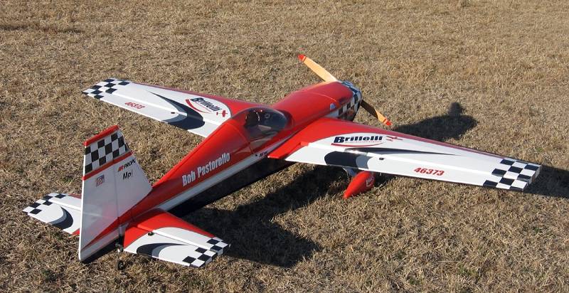

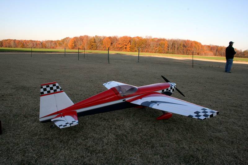

Finally got the maiden flight in today. Things went great. Lots of nice comments at the club field. The plane really flies nice and looks good. I set it up just a little tail heavy and will need to adjust it this week. Harriers, rolling circles, flats spins, KE spins were all good. I hope to shoot some video next weekend. Here are a couple of pics.

Good for you!!!! That's great to hear, hope mine does as well. It is done, balanced, ready to go... just need the time and the wx to come together!
Congrats on a good maiden!!!!!!!!!!

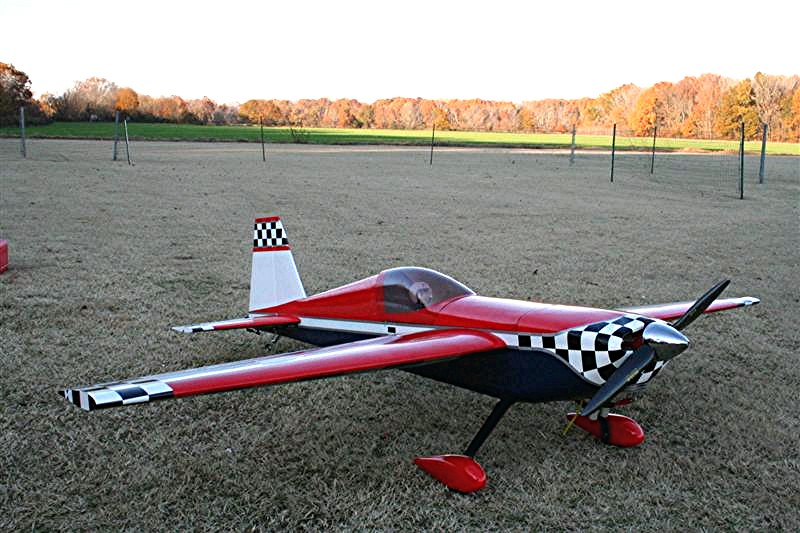

Thanks.... interesting that a stock CG would feel "rearward", but it's easy to tweak and check.
You're right, too.... a good maiden is tough to beat...... (hyperbole intended )
Pics attached...

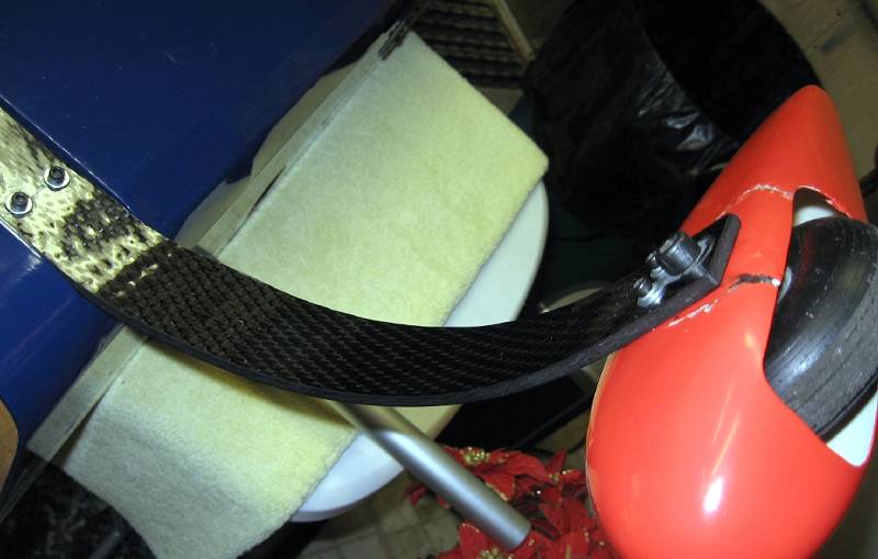

Put some time on the Extra yesterday.... after moving batteries forward about 5" to just behind the wing tube, mounted on top of the canister ply top. Made a big difference in handling, although it still pitches on k.e. a bit.
This is a very precise airplane, and really enjoyable to fly...although it comes in hotter than my Yak by a good bit. I figure that's just my throttle mismanagement, and I'll get the hang of it.
BIG "downside" issue, though - the Chinaluminum landing gear - as I found on my TOC Yak - must be made of aluminum-colored RUBBER. Mine just flexes, twists, and bends so easily that it reminds me of the OLD GP arfs with the thin Chinaluminum. So yes, it took out one of my 23 x 8 Xoar props, and NO, I am NOT happy about that. [:@]
Of course, if I could land better......
Graphtech has replacement gear for the GP Wagstaff (bow style) that probably will work, even though I'll have to narrow down the fuse mounting part because it's wider at the fuse than stock. Can't possibly hurt; the wheel pants already have huge cracks and repairs, so the maiden isn't to "fresh" anymore. At least on the landing gear.

So.... rechecking the wheels/pants after the spaghetti-bending of the landing gear. Of course, they nearly completely cracked through around the edge of the plywood plate on the inside of the pant on both of them. Not a surprise, I had not done my "usual" CF reinforcement around that.... now I have!
Interesting discovery during all of this - though not a "happy" one - the blind nuts provided in the stock hardware for the wheel pants, 6-32 for the ply plates. BROKE. Weird. The threaded portion pulled free/breaking from the flange!!!!!!!!!! [:-]
You can imagine my surprise, not to mention the REAL interesting challenge removing the wheel pants with those staying ON THE SCREWS!!!!!!! Sheesh.
Anyway - all better now - ready for the next round of gear-leg-bending-wheel-pant-stressing flights.

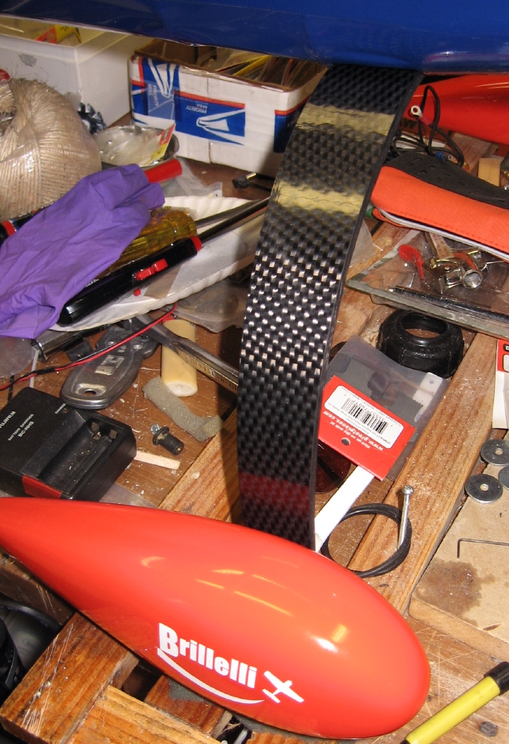

Graphtech to the RESCUE!!!!!! Only $60, and I have BEAUTIFUL, stiff, and strong CF gear that look just GORGEOUS, and a BIG plus---I gained almost 2" prop clearance. Those who fly this bird knows that means a slower landing speed for three pointing.... love it!!!!
Installating the CF gear was not "easy", but neither was it a HORRIBLE experience. Just nasty CF dust....BTW - for those who choose this route (and I recommend it), you have to take about 1/4" off the rear of the CF gear across the width of the "fuse plate". That's it.
I reused the stock axles, my battered wheel pants, wheels, and collars, and the mounting hardware. So, all in all, this is just a "landing gear replacement".
Pics attached.
