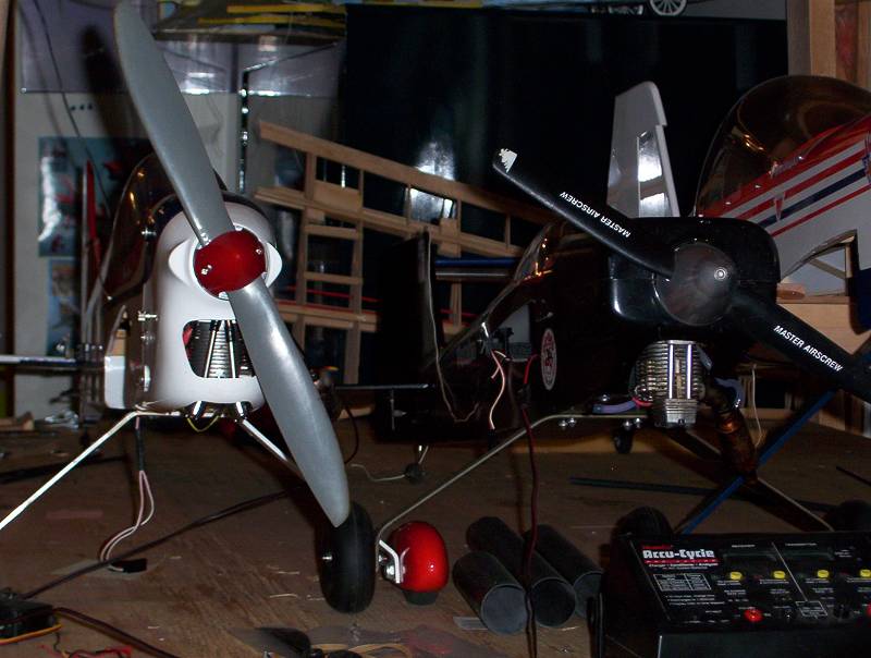

That is sort of an in between size engine.
Its not really enough power for a plane the size of a 60 size U CAN DO, Mayhem, Showtime etc,,, if you want really good vertical pullout. But its almost too big (due to weight) for the smaller planes because of its weight. I know of some guys that are flying 2 stroke that weigh about the same thing on the Fliton Inspire. They should have some flight reports on those threads eventually, keep an eye out for them and see how it flies with a 24oz engine.
omg, what the hell are you powering your planes with??
That stinger looks like a f3a patternship, becouse of that engine!
But if you should recomend a 3d plane, what would it be?
I want the ucd 60 size but I dont know wich engine to go with, you probably would have installed a saito 220??
Of course I"ll by a new engine if the plane demands it!

ORIGINAL: stinger40
Nah, a 220 isn't enough power. I'd jump up to a DA-50.
