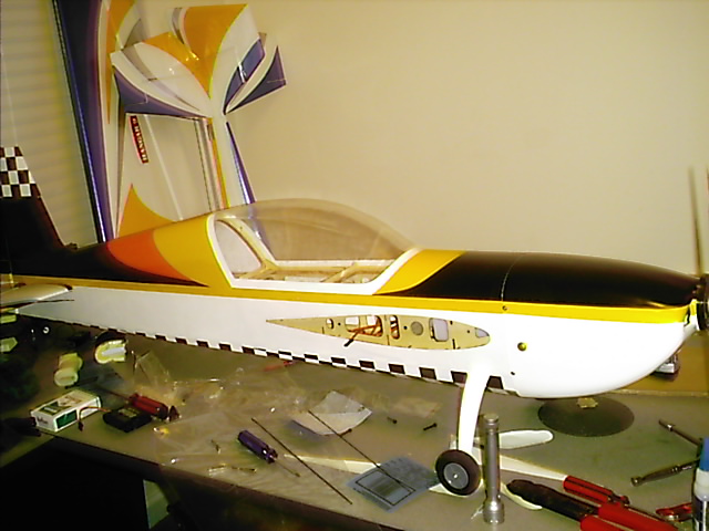

Checking Nitro Models website ran across this Extra 330 90 - 63". Sale price 134.95. I ordered for a practic "bang around 3d plane".
My original plan was to out fit it with some futaba standard digital servos I had laying around and power it with an old magnum 46.
First off let me say that Nitro Models was on point at getting the ARF to me promptly. Ordered it online on a tuesday came in the following Monday. Theyalso e-mailed me with order status.
Upon first inspection this plane is larger than I expected. 46 ain't gonna cut it. Quality seems very good. Built fairley light. 5.5lb with everything except motor and tank. This plane looks very similar to my old fliton edge 540 freestyle. It is a little larger but the building design, control surface, layout is very similar. Love the colorscheme and quality of covering job. but I am sceptic of how well this type of covering will hold up.
I am curently looking for the best (economy) engine. Would Like to go saito 100 but this is still abudget build. Looking at the GMS 76. Would this work well? I want to 3d but It doesn't have to be way overpowered. Enough to hover and practice most 3d manuvers.

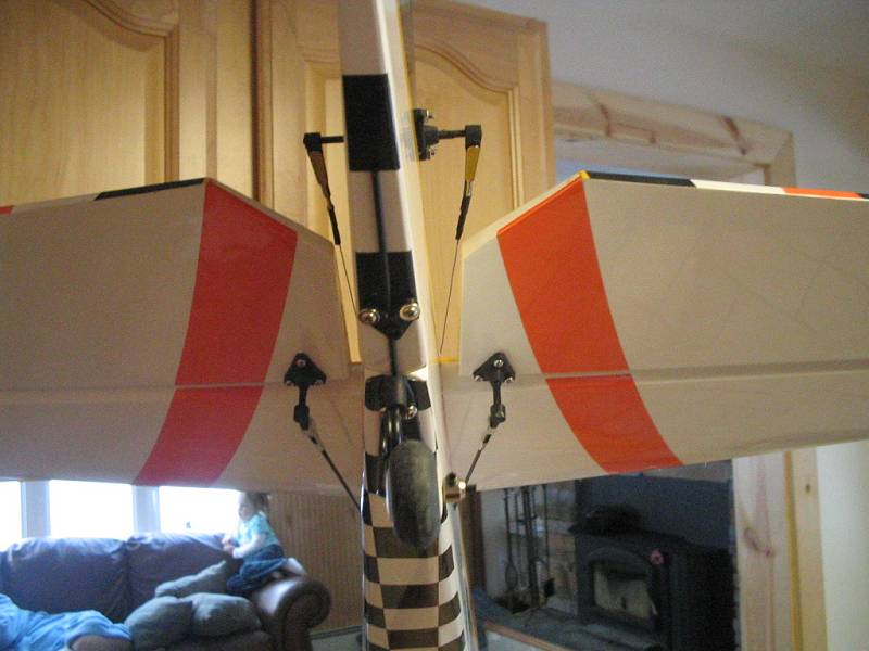

The only thing I did different in the build is:
Used different Landing gear. The stock one is waaaay tooshort. I think you would be limited to 12" prop max!!
I used the gear off of my crashed fliton edge. Slight modification and it worked perfectly.

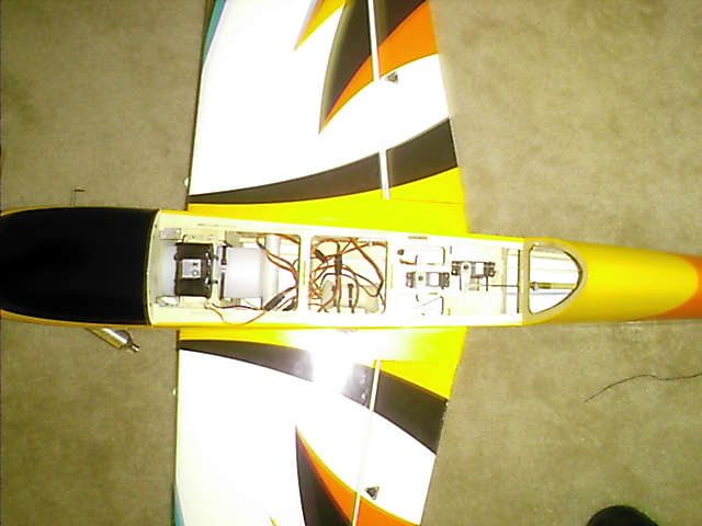

Also I installed to micro servo on each elevator half. I used hobbico cs-12 ( around 35oz torque)
Stock is a weird belcrank assembly with a single servo mounted in middle of fuse.

I'm sure you know what you're doing, but are you sure your elevator servos are up to the task? You've got a bird weighing in the vicinity of 7 pounds and using two micro servos on the elevator halves? The elevators are very generously proportioned and while the torque rating MIGHT be adequate, what about the gears in those servos? A couple of violent maneuvers and they might easily strip. Also, with those long arms and having the push rod so close in on the elevator horn, you have very little mechanical advantage, meaning that flight loads and little bumps against the elevator will transmit directly to those fragile gears with magnified force. It's possible to smack an elevator while loading/unloading the plane and break a gear, but not have it totally give out until the plane is airborne and under flight load. I think you might be risking a really nice looking plane with those micros. I don't care for long elevator push rods either, but you might want to reconsider your servo selection. If you stick with the micros, it's probably a good idea to check for slop in the gear train frequently, hopefully averting a failure.
Just my thoughts....

Thanks for your suggestions. I wasn't too happy with the mechanical advantage of the servos at the time of the picture. I plan on making some adjustments to get everything 90deg with the best mech. advantage. Any suggestions on an alternative elevator set up would be appreciated. Keep in mind I want to 3d but on a budget so weight is a big concern because it will be powered with a cheaper lower output engine.

Ok, Finished my extra tonight also. Maiden tomorrow if weather permits. AUW is 6lb 14oz. wish it was a bit lighter, but we'll see how it flies. The gms .76 is also about 24 oz with muffler. She balanced a bit tail heavy. I put the rx batt right next to the engine and tank is directly behind engine in motor box. It balanced about 1/4" behind rec. cg. I think it will be fine as most of my 3d planes are tail heavy.
My biggest concern is how well this engine will run inverted.

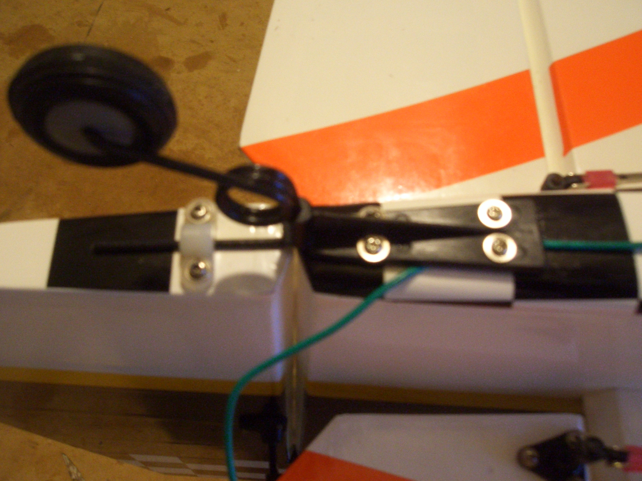

I can not figure out how this tailwheel is to attach to the rudder. Can anyone post some close up pics of your set up for me? Thanks

pnr,
here's a pic of my tailwheel

Thanks fo rhte flight report and tailwheel pic. I do not have that bracket on the rudder, I will have to make one up. I can not wait until the 4 feet of snow melts here so I can start flying [:@]
