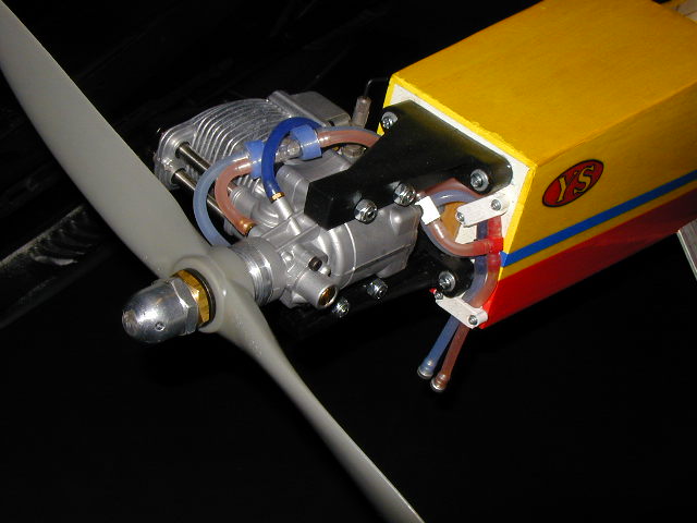

I have a YS91FZ in mine. It's true about the throttle response and performance. I have seen one with a Saito 100 and it flies really well also. I just think the YS91 has a slight edge. Mine had only a few tanks of break-in on it before flying and it was terrific with the 15x8 APC I ran.
I did use larger Hangar 9 lightweight wheels than what it came with. 3-1/4" I believe.
Takes off with very little throttle and very little rollout. Will go vertical immediately on take-off.
Sadly, winter came to Chicago before I had more than a few flights on it. My buddy, who is a much more capable pilot, demonstrated the crow, etc after the maiden flight to show me some of the capabilities. Pretty neat.

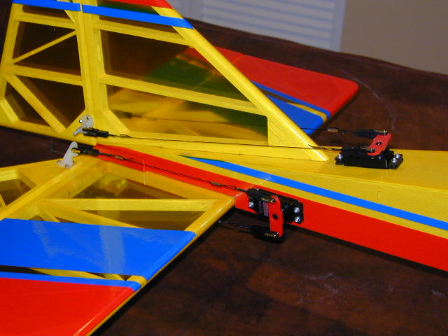

Both elevator and rudder servos are mounted in the tail in a pull-pull arrangement. Look up postings on the US60 by Termagator and you should find it.

Good luck and enjoy it. Great flyer. Either the Saito 100 or YS91 will fly it forcefully, although I agree that the edge would probably go to the YS91. It all depends on what you prefer and are comfortable with, though.

rcpilot44, if you mount the servo's in the tail and the tank on the cg the balance should be there.

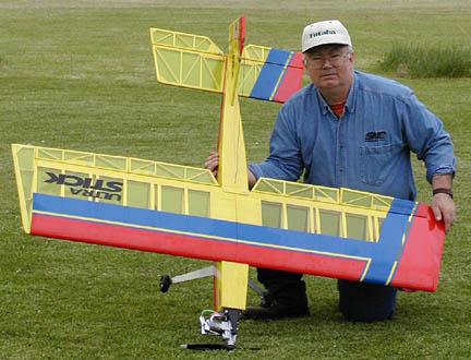

Ed, unfortunately I probably don't have the greatest eyes in the world when it comes to orientation. So, I make sure my planes help me out.
When I've had planes with poor visibility for orientation, more flights doesn't make it better for me, just more stressful, more difficult, more dangerous, and crashing is what tended to happen next, until I learned how to modify planes for improved visibility.
I do know people with many flights on their US60's and yes, they do fly it, and do get used to it, but still think the visibility stinks. Why not make it better?

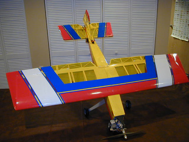

RCPilot - yes, I had to add about 3 oz to the tail. This was split into 2 pieces of lead, covered in red Ultracote, and epoxied to either side of the base of the fin. You don't even notice them if you are not looking closely.
Color scheme is attached.

I have never built a plane with the servos mounted on the fuselage. Did you just cut out a hole for the servo and then screw them down directly to the fuselage or did you drop a servo tray in it??

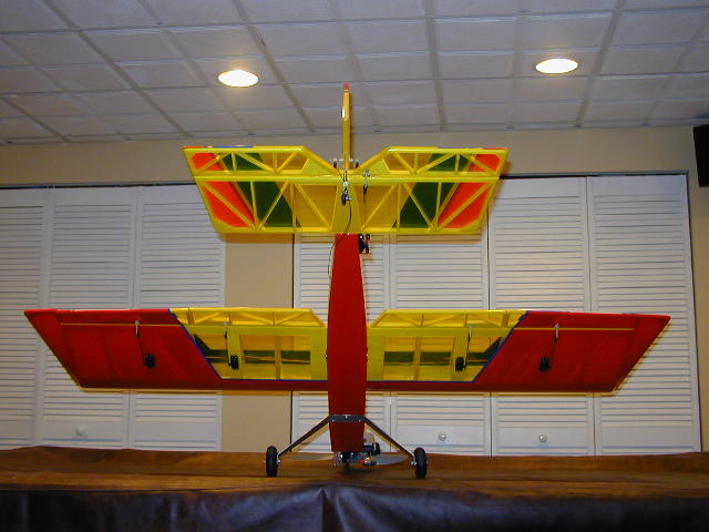

Thanks for the compliments!
The servos in the tail are HS-605's. The (4) Wing servos are the Futaba 3004's that came with my 9C radio (finally found a good place for them!).
To install the rear servos, I cut out the holes to accomodate the servos. Then I cut (4) small pieces of ply, perhaps 1" x 3/8" wide. I mounted these to the inside surface of the fuselage, using thick CA and small adjustable slide clamps to secure it while the thick CA cured. This was to give the servo screws something to solidly bite into.

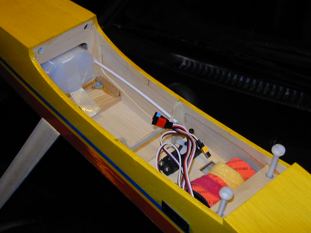

I only use ARF tanks occasionally, and only if they are of very high quality. Unless they go into a combat plane! Then I don't care.
With a YS, the tank gets pressurized to approx 6-9 psi. I know it doesn't sound like much, but that's a lot of square inches of area times 6 psi! I used a Hayes tank, probably their 16 oz. Otherwise I would have used the 13. The tank is wrapped with fiberglass strapping tape as a precaution. I make a little pull tab out of the tape before wrapping it around the tank. This makes it easier to pull the tank out from the rear in the event you need to check it or service it.
The Hayes tanks are very reliable in this application, and work fine with the 2-line system you would use with a YS. If you have not plumbed a YS before, you will use a T-fitting in the supply and pressure lines. It's a good idea to use a fuel filter between the engine and tank in both lines. The T-fitting on the supply and pressure sides works on a YS, because the fuel doesn't go past the regulator when you fuel or de-fuel the plane.

you can see the strapping tape, as well as the little pull tab on the back of the tank.
As Ed mentioned above, you can move the tank to the center of the large fuselage cavity, which will help with balance and avoid CG shifts during flight. No problem with a YS and the tank back there, but I just went the easy way!

Originally posted by RCAddiction
Pull-pull rudder and elevator. If you look, you can see the red Ultracote covered lead weight. Not very noticeable.
7lbs, 6 oz total weight as is.

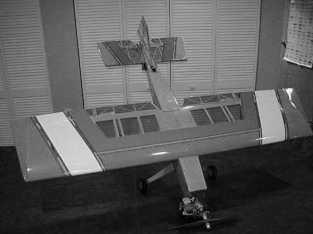

Mine, configured per factory, with a Saito FA-100 came out 6lbs, 8ozs. I did have to add 1.5ozs of weight on the back -- cut a strip out of the fuselage and epoxied 6 1/4-oz weight squares just in front of the tail wheel.
RCAddiction,
I see from your picture that you have not done anything with the landing gear mount block. This is a definite weakness with this airplane. Normally a manufacturer uses a block about the same size but made out of multi-ply plywood. This block is mild hardwood that is very fragile along the wood grain. Consider much epoxy and/or fiberglassing that landing gear block. Your 1st moderate hard landing will fracture that block along the wood grain and take out the bottom of your fuselage. The repair after that is much more difficult than doing it before hand. Been there, done that.
My Feedback: (87)
Posts: 1,010
From: Sarasota FL
Jim,
Thanks for your heads up on the landing gear block. I will think about reinforcing it with ply before I resume flying in the Spring.
Sorry you don't like my weight. The plane doesn't seem to mind, though.
The plane is lightly loaded and ludicrously overpowered with the YS91.
BTW, that weight figure includes
- an ounce or 2 of covering on the wing and tail to improve visibility.
- larger H9 lightweight wheels. Makes my life easier at the rough grass field I fly at.
- YS91
The YS91 is certainly heavier than the Saito 100. You pays your money and takes your choice. Both were in the glass case at Venture Hobbies when I bought the 91FZ. For me it was an easy choice for my 3rd YS. I've found that I prefer the nature of the throttle response in my 63FZ, 91FZ, and 120SF, to that of the many good Saito's I've owned. Saito's are fine. I've had 4 until recently as I've sold off 2. It's just personal preference.
The plane is lightly loaded and ludicrously overpowered with the YS91. BTW, that weight figure includes
- YS91
