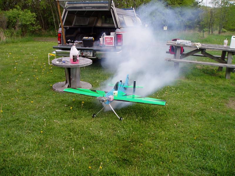

Here is what I got out of OS 90.
ID:	676651   Click image for larger version

my ys does that to vsustko

Did you really need the pre-heater?
I see that you used the same tap point I am using. I have not put in the coils as you've done, but I am running a 1.20.
Old 05-02-2007 | 09:20 PM
My Feedback: (11)
Joined: Aug 2005
Posts: 41
From: Elmira, NY
Default RE: adding a smoke system
I probaly could have gotten away without the pre-heat, but then hotter it is then more it smokes. Also, it helps smoking up a storm when you are running low throttle. This model was very overpowered and I liked using smoke while hovering so it helped at lower throttle settings.

Be careful not to over-preheated. if you wrap to much coil around the muffler it will act as a radiator and cool the muffler body and a cooler muffler means less smoke!
