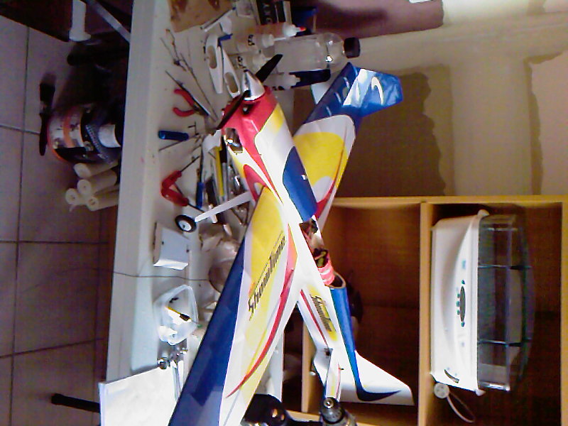

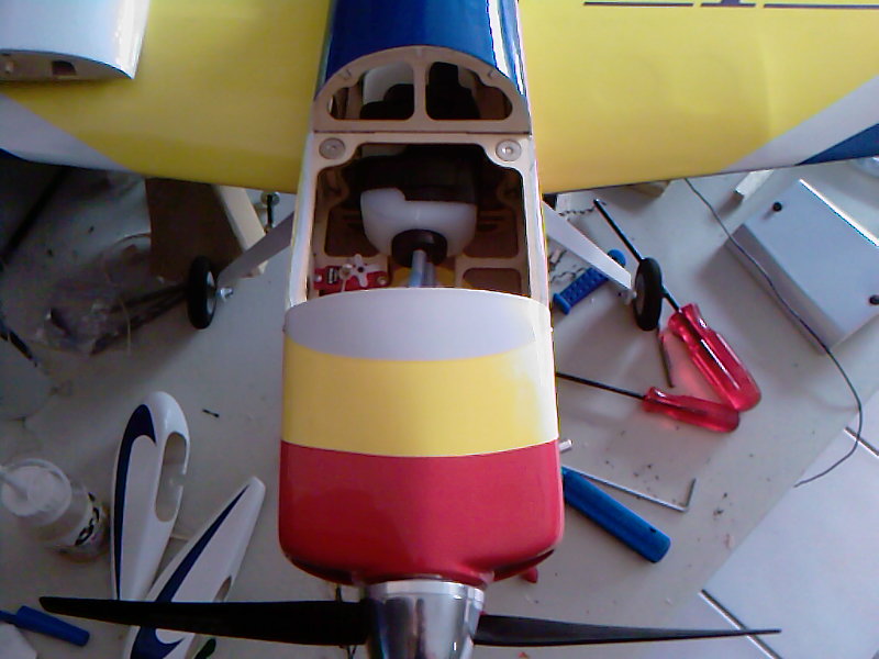

Joined: Nov 2005
Posts: 240
From: ...Victoria, AUSTRALIA
Default RE: Mini Showtime, Convert to GLOW ???
here are the pictures of mine with a saito 30, not sure why one turned out sideways though..., the fuel tank is velcroed in under the battery hatch (4oz tank)

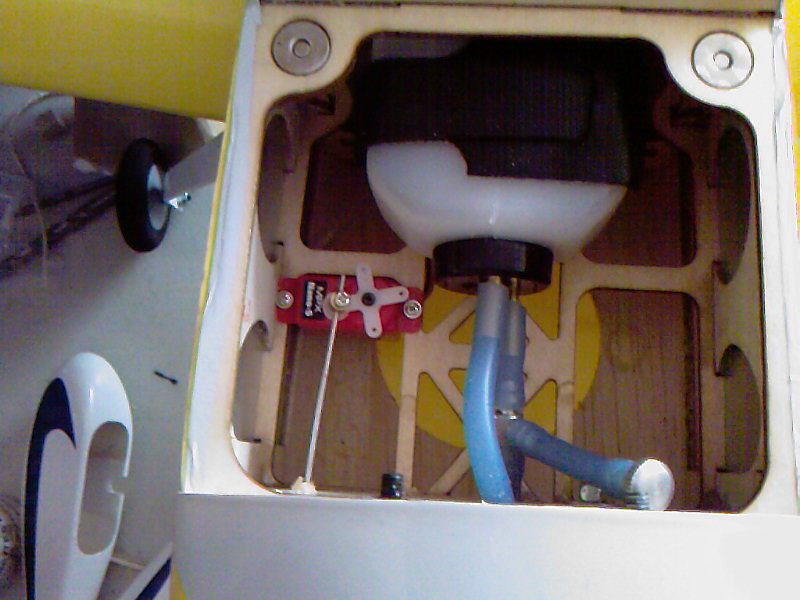

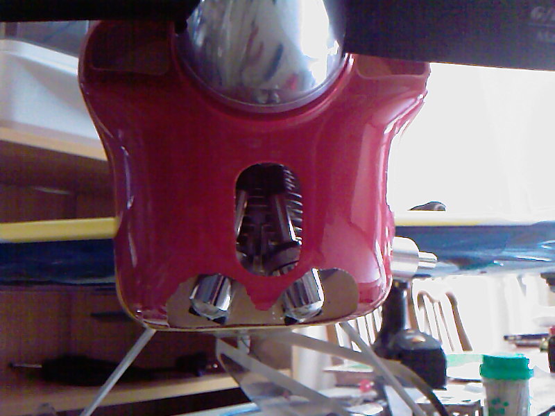

Old 11-18-2007 | 09:24 PM
Joined: Nov 2005
Posts: 240
Heres some added pictures of the fuel tank and throttle mounting position i have set up.
