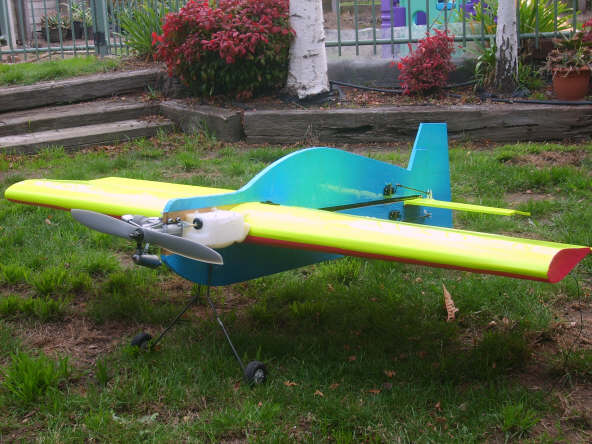

All done and now waiting engine run ups and a couple more cycles on the battery took a few pics to show you all. Came in at 2.6kg(5.7pound) not acuritly weighed but will be close. finial gear is saito 100, 4 5625 hitec and hs85 on throttle 1500ma Nimal battery 10oz dubro tank and covered in monokote (colors chosen by my wife not me
). Will proberly be a few weeks before a flight report but im really looking forward to it

. Did the maiden not to many problems. the only real issue was the dodgy tail skid that i put on. It did not last the trip to the field let alone the flight. So in the end i flew without any wheel or skid. Will fix before more flying. About the flight well what can i say WOW it fly really nice. it looks really big in the sky and seems quite docile yet open the power and man it gets up and boggys sweet. I took of on low rates, it took a little trimming but not to much then i did a few rolls was way to slow so clicked high rates and nice. i did the rest of the flight on high rates its just what im used to using now and don't think i could fly much without them. i then brought it round and slowed it up into a nice high harrier and it just locked in and sat into without any problems. i did a few circuits like that then poped it into a hover just had to lol it took close to no in puts to hold it there it just seemed to stay in place, it made me look good. the controls have heaps of authority at low speed and little movements have a big effect. it powered up and out with ease i did not even use full power the whole flight. i then did some inverted it sits close to hand off and flys the same either way up. knife edge was nice did a full circuit did not notice it wanting to tuck or pull much either way. I then did a rolling circuit look crap but that was my nevers not the plane. landing was nice and easy slows up fast so tend to approach with a bit of power on. i cant wait now to get some really stick time in and bed in with it. Dad reckons the satio is not running right yet he said its not pecking right he said after a few flight we will re tune and see how we go form them. Only did the 1 flight as we were under a bit of time restraint and not wanting to damage a rudder servo. Im am really happy with it and hope some more people have learnt something off my thread and now will go and build and fly one of these planes MoAss Mojos rule [sm=thumbup.gif]
