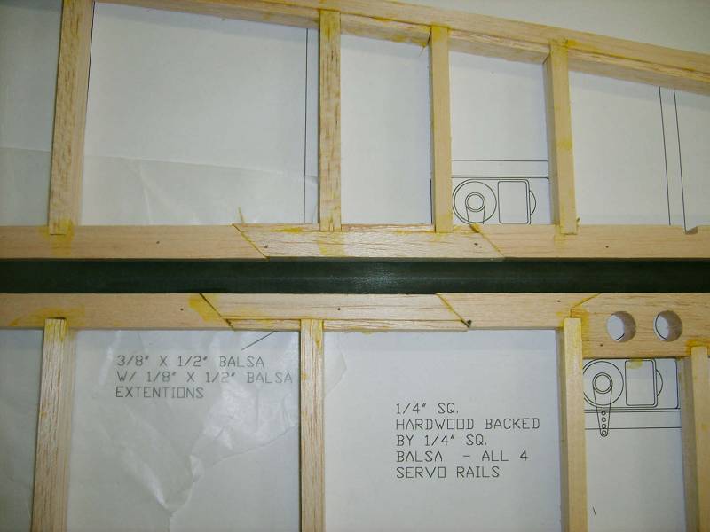

Now to make a few comment about the kit. At first it all looks good but under a closer look there is alot i would like to talk about.
I would like to start out with saying it is the nicest plane kit i have seen, everything has a cut out to help line up and just glue and place, which is very nice for a builder like me that struggles to get the things straight.
The quality of the balsa seems to very lots from soft to very hard. so i took the time to sort though some of it before i started and worked out where some of the places would benefit from having a hard or soft pieces. 1 of the places i will use a harder piece will be the main wing spar. which to my surprise is all balsa with a carbon and hard wood center, i have never used anything other than hard wood for spars but will use it as i do trust the designers choice.
As i was putting the fuse together i went to grab the triangle gussets to put in the back to only find out they were not square. Not even close. A quick fix but was just surprised.
The moass extensions do make it a little slower to build as you are required to cut or add onto the existing frame work to make up the extra size. My dads comment here was he would rather pay an extra some of money to have these parts cut to the right length rather than making them up. making a moass kit not a mod kit, as it would make a stronger and lighter plane. he said if he was building the kit he would still remake all parts needed not make the extensions like i am. For me i dont know enough about the build to dick with it so i will follow what is required but if i was to build another would recut all parts needed.

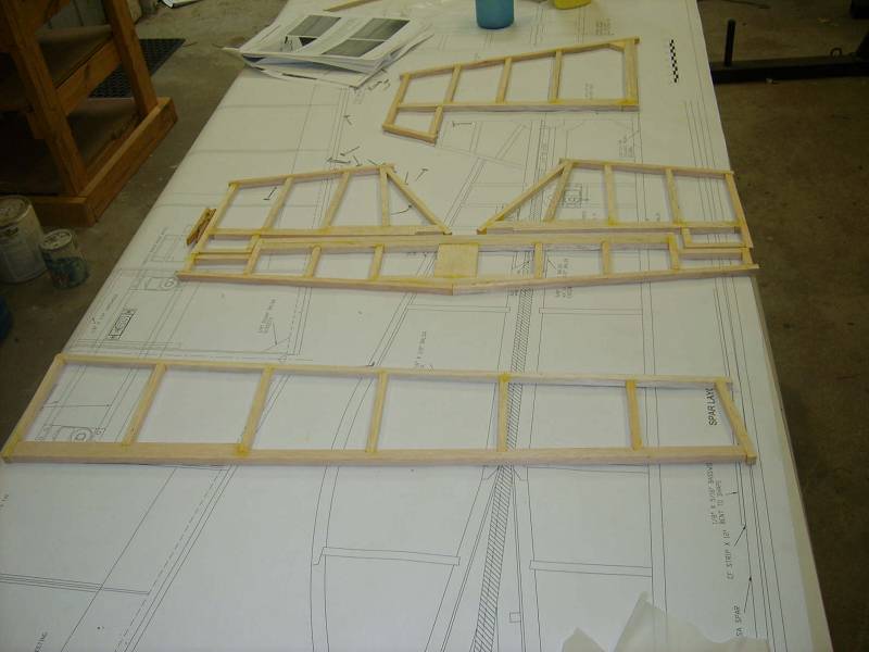

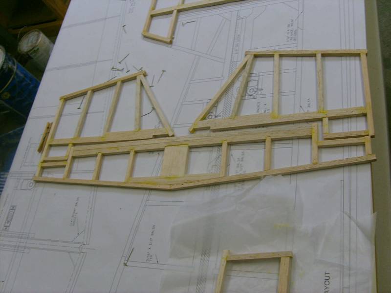

Well on update
Got in about another 2 hours today and got 1 aileron, stab and both elevators made. Just to say wow the surfaces are huge. Real glad i spent the extra money on good servos. There would be no way a standard would be up to the job. Another comment i will make is just watch the uses of the square 5/16 balsa. I worked out that there is more than enough in the kit but if you use it as you go in the order i have it would be short for the spars. But like i said i went though and sorted though it and realized so you have to cut the end off the spars which gives plenty then. For 1 of the first times i lifted the 2 elevator half's off and some how they are so close in size i was impressed with my own building skills. Then i took another look and remembered that Paul Swanys kit had done the work for me, the cut outs make sure it lines up making it real easy to get it right. I then nipped out again latter tonight and got the wing spars glued together meaning i can now build the wing when ready as i made up the center rib as i was building the fuse. So im about 5.5 hours in so far and just have the wing and 1 aileron to build not bad going for someone who really has no idea what im doing. the only problem for me is i will have to spend about that time again sanding and filling but hey thats what it is for me. will try and get pics as soon as i can thanks for reading

got a few pics here now, 1 shows the extensions that are made in the fuse and then just a couple of shots of the surfaces and an overall shot of the fuse its hard to get an idea without anything to compare it with. But i can tell you the surfaces are huge. Off to start the wing soon cant imagine it taking to long cant wait to get it all done and flying

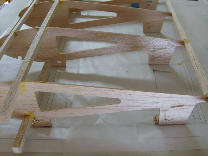

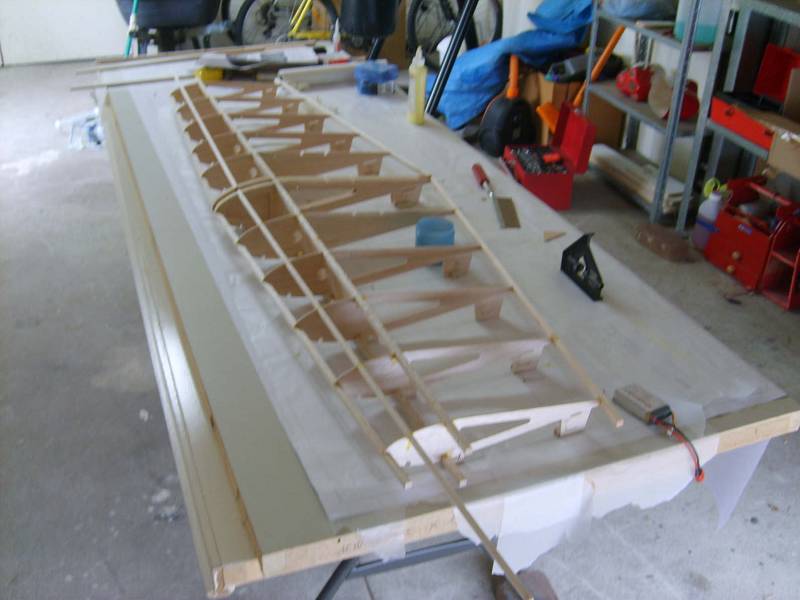

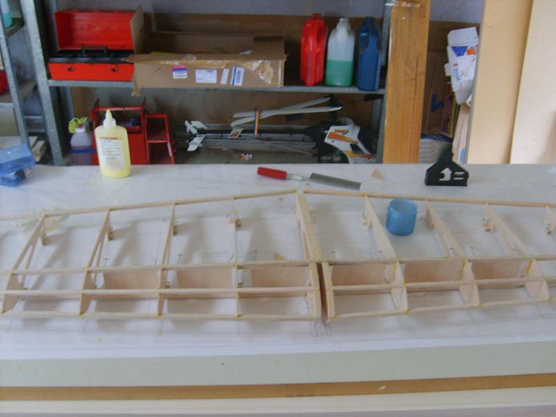

I go in about another hours work on the wing. the setup for it is a bit fiddly with have to pin down 20 odd scrap block to the board to help align the ribs. but would have to say in the long run it was worth it. made the rest of the assemble much easyer. I only have the top and bottom spars in so far but the rest of it is just gluing so wont take long to get done, as all is set in place now ready to be done.

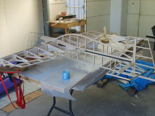

well must say about another 2 hours or so work into and the wing has come along nicely. Have struck a few problems on the way. Im in the middle of doing the sheeting on the wing and have came up well short on the 1/16 balsa. not that its a biggy but just a pain. looking at it now there properly would have been enough there if i had looked at it before i started as i used a new sheet and went ahead and did up the shear webbing.(like the booklet said to do) If i had done it right the shear webbing should have been cut from the off cuts of the wing sheets. Another small thing i noticest is the plan and the booklet differ from each other on the width to cut the leading edge sheeting, 1/4inch different between them i got the rule out and measured it and the plan is right and booklet wrong. I have also came up short on 1/4sq hardwood for servo rails i can only think there was no extra added for a moass where the fuse is taller hence using a little bit more which in turn has left it short to get all the wing servo rails. yet again not a biggy just a pain as now i have to get more of that aswell. well so far its all going well and with about 8.5 hours work so far i only have sheeting on the wing and 1 aileron to make, final assembly and covering might bring me up to about 13-14 hours work which to me does not seem to bad. anyway got a couple of pics of the wing here, you can see the extra tabs built onto the ribs to make it real easy to get the taper and shape right

Sorry for a bit of a delay. Im back to building now i really want to fly so have to get stuck in and get it done. Quick update on where im at, the wing is pretty much finished with just sanding and filling needed got the second aileron half built witch i will get done tomorrow. The elevators halves have been epoxied together just need to put the cap strip on it as the joiner is thinner than the elevators. i still need to put the triangle stock on all the surfaces and the opposite trailing edges. this is a nice touch witch allows the surfaces to have massive throws without any binding ( will look like this ><
. I have cut the 2 hatches out and put the rear lip on just have to put the strengthening strips on under it. Will get the tube drilled and cut and run a draw cable though for the servo wires during the week. Hopefully be ready to glue the thing together by nexted Wednesday as that will be the day dad has off work to help with it. The task of gluing it together looks a bit daunting but dont think it will be to bad, but just want to have dads assistance there when i do it as i know its a critical stage.
