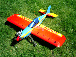

I had an artf 3d mini laser and it flew ok - not 3d though. The control surfaces warped after only a short time. The covering also stuck together on the control surfaces (between the top and bottom of the aileron between the void of the wood). I took the gearbox off and fitted a cobalt 400. It was ballistic but struggled to take the stress. It Broke!
I think this model is a beautiful kit but would need to be thought out properly before fitting IC. The weight of the battery pack (500ar 8.4v) was also, in my view, a bit heavy.
My opinion of this model is it is best left as an electric.
The comacro looks like my Mini Jazz. Powered by an mds18 but 25 would be better. 33inch wingspan and very maneuverable.

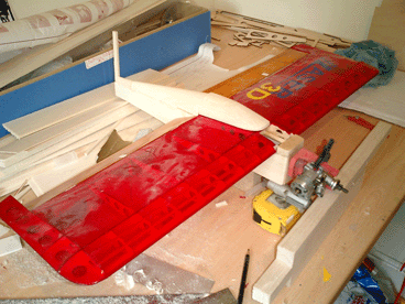

After reading this thread it got me thinking last night what to do with my mini laser 3d. So i decided to make a new fuz. I shall do the tail and covering tonight.Its suited to an OS15fp, should be lively.

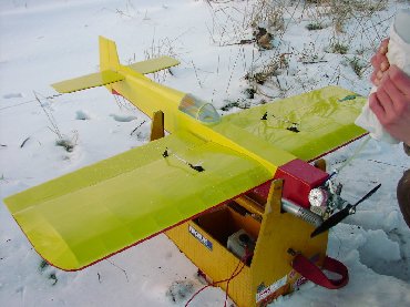

Two years ago I build the plane on this picture. It is powered by Magnum.15. This plane is pretty good, but there is not power enough for howering. I will try a O.S.max .15LA next week.
wingspan 950mm (37.4 in)
weight 750g
If You have a interest, you can find a plan in .dxf on my web site, or mail me.
Lada
weight 750g
Lada
#40
My Feedback: (111)
Posts: 638
From: Romeo, MI
Hi Lada,
Nice looking plane!
But I don't think you will gain anything going with the OS 15 LA over the Magnum 15. They are both plain bearing engines that put out about the same power.
...Or did you mean an OS 25 LA?
Now that would make a noticable difference!
Mark
Nice looking plane!
Mark

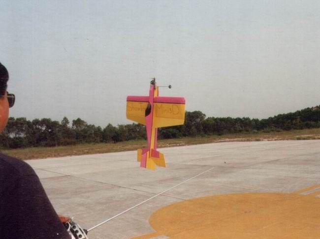

#43
My Feedback: (111)
Posts: 638
From: Romeo, MI
Looks like a nice plane Nelson...but I went to the 2krc.com web site that you mentioned, and I don't see anything that looks like what you are flying in the picture. They only have large planes shown.
...or do you have to have a secret password to view the small planes?
Could you please tell me how to get to the page that shows the plane you are flying, and do you know if their planes are available in the USA?
Thanks for the info,
Mark
Mark

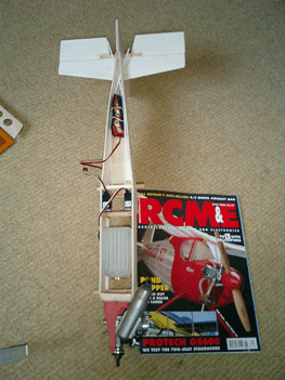

Last night i changed things slightly with my scratch built fuz. Its now called a Mini Magic. Should be covered by the weekend. All up dry weight is 1lb 6oz.
Neil
Neil
#45
As you can see from this picture the receiver and battery are right down the bottom of the tail.
Balances one third from leading edge.

My Feedback: (111)
Posts: 638
From: Romeo, MI
Wow...is the receiver & battery going to be totally enclosed in the tail when it's done, or are you going to have access to them somehow?
Also, is that the stock tail surfaces from the laser, too, or did you build them with the Fuse?
...Can't wait for the flight report!
Mark
Mark
#47
I was going to enclose the radio in. Cutting a small hole won't be a problem if i do need to get at anything. The fuz and tail is all new. The ailerons will also have to lose about an inch on each side as they meet the wing to allow for the rubber bands to hold the wing on.
Neil
Neil

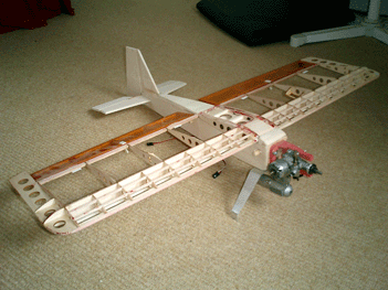

Joined: May 2003
Posts: 7
From: Ostrava, CZECH REPUBLIC
Hi Mark,
Magnum and OS max are very similar. Magnum has a ball bearings. My Magnum is pretty old (3 years of running every sunday, in winter too). It turns MA 8x4 11500 rpm. Os max.15la is new and turns 13800 rpm with APC 8x4. I hope, it will be better than Magnum. I will try it on sunday, if weather will be good.
OS 25LA can be good way, to get a power enough, but I am afraid about wing loading. Now it is about 32g/dm2 and landings are really gently.
On the picture is second prototype of my .15 powered 3d planes.
I love this small things.
Lada
Lada
