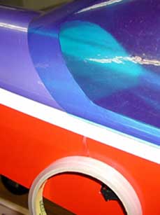

hi, i'm still waiting for my seduction ....i noticed that in most of the pictures the canopy is attached with translucent tape ..are any of you guys intend to use this tape..where can i get it

Default i added a photo
i hope you could see what i'm talking about in this photo

new 3d, that looks just like plain transparant tape to me...

hi Huang thank you for your answer, it does look like a plain transparent tape but i was woundering if this is the best way to attach the canopy to the fuse' (you can not glue it because of the ultra cote covers )
by the way o.k. model has this tape on their website (i could not understand if its something new...)
here is the link: http://www.okmodel.co.jp/shincyaku/acc.htm

Okay, here's a big secret tip for you.
You can use Ultracote to attach your canopy. You can use some RC 56 or other canopy glue to tack it in place if you want, then use a strip of matching (or contrasting) Ultracote. Use a trim iron on low heat. You can really stretch and conform Ultracote to do a nice job. It will stick to the canopy, trust me. Take an old canopy or the scraps from a trimmed canopy and try it. I like to get about 3/16" minimum on the canopy and the plane, so a 3/8" strip is about right. If you goof up, just warm the Ultracote and remove it. You only want enough heat to activate the adhesive. You really don't need to shrink anything if you pull the material tight as you go. If you're really picky you can taper the the very edge of the plastic canopy to help avoid a square edge.

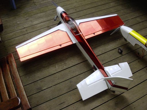

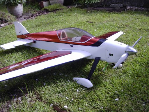

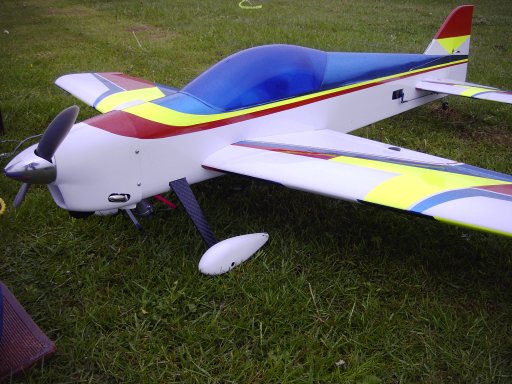

OK Guys,
So here we go I will attach some files of mine and my palls rick's seduction FS's. Mine is the red and white one and is built as the instructions. I have a glass cowl to put on it, waiting for some time to do that. Ricks is highly modified. I am sure I could get around to telling you what he done but it will take an age. He wanted his to look diffrent from mine as we fly at the same field and we didn't want to be tlike the same brothers.
Cheers
Kris

And another

And another next to my Madness

Old 05-19-2002 | 11:26 AM
  #50
Posts: 311
From: Totnes, UNITED KINGDOM
Default Building the Seduction Freestyle - more tips added.
It is the same kit...... Amazing what a colour scheem will do.....
