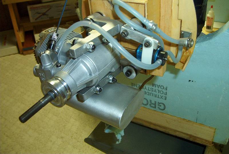

You just drill the backplate in the center and tap for the 6-32 fitting they supply. The 160 FX has a entrance for the fitting on the top left backplate screw that you can drill and replace the screw, not sure about the 75AX. Just remove the backplate and drill it, make sure you file off any protrusion on the backside. This is about a 5 minute job.
The other thing is use the supplied tubing and don't replace with fuel tubing, that will blow off during the pressure cycle, (not good)
I'll get some pics of my installation.
If your worried about warranty just buy a seperate backplate to install if you have to send it in.
A couple of key points, make sure the vent hole is pointing down and the pump is level with the carb inlet. Don't even mess with the adjustment on the pump as it does'nt do much. It's all in the LS needle setting to get these to run correctly, and to smooth out the midrange.
Don't forget no muffler pressure, just route the line to exit the cowl, with the pump you need a tank vent.
These pics show with a fueling valve so don't get confused on the plumbing. If you have a fueling valve it has to go in after the valve. The second line you see going by the pump is the vent going below to exit the cowl.

I have a perry pump on a 120AX and it works great. The 120AX has a spot right on the center of the back plate that looks like it was made for mounting the pressure tap. Also, I had a problem (not related) with my AX; I sent it in with the back plate drilled out and they still honored the warranty. So, just pull off the back plate (4 screws) and mount the tap right in the center of the back plate. The pressure tap won't go all the way through the back plate, so no chance of interfering with the internal workings of the engine.
With the pump, you tune the engine so it's just off peak rpm, like 75-100 rpm just to make sure it's not lean. The plane will not lean out in the air, or at any attitude. It's really a sweet contraption.
Cover your muffler tap so you don't leak exhaust stuff everywhere, and only use the pressure from the back plate to the pump. A line goes from the tank to the pump, from the pump to the carb, and a vent is needed on the tank for ambient air to enter.
Last thing: you want your needles set from before using the pump, then tune the pump to the engine. You should have your low and high mixes set with the needles, and adjust the pump for smooth transition, and obviously slightly tweaking the needles if necessary.

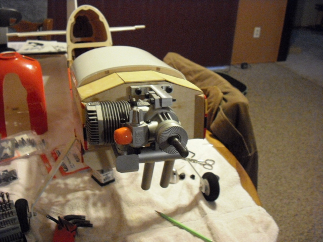

I have a 16oz in my 120AX gives me around 12 minutes. The 12oz should be fine for the 75, should give you around 15-18 minutes. I have a 16 oz on a 61 size trainer and have gone 25 minutes.
The Iso mount works good, although they are a bit heavy, reduces vibration quite alot. You still want to pad your tank on all sides.
The mount is more for vibration on all the electrical equipment and the airframe than the tank.

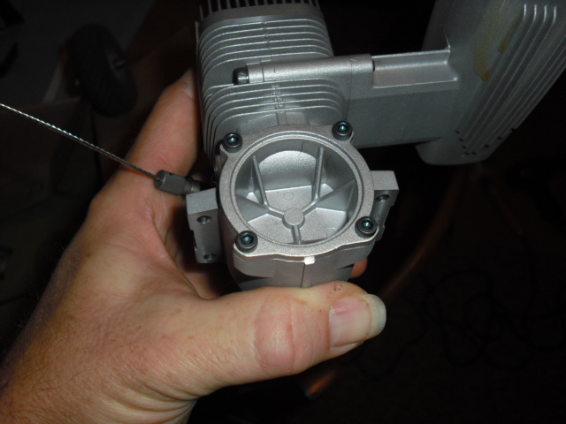

gaRCfield,
I do remember the raised area in the center of the backplate on the 120, made just for a tap. I wonder if the 75 has the same.

Yeh , the .75 has a raised area in the center big enough to drill and tap . My .46 does to but it is not big enough to drill and tap . I think it is part of the design on the casing to add strength .

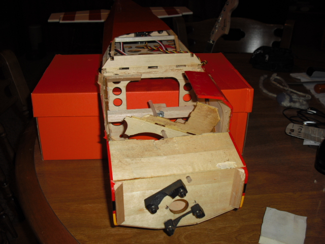

I will be padding all sides of my tank now . The original design of the plane had the tank fitting through a plywood structure in the fuselage with no room for foam except in front of the tank and behind it . Since im rebuilding the whole bottom front end of the plane I will be able to make room for foam .
The pic with the big round nob in the center is the .75 the other is the .46 . I also made about 8 sets of these motor mounts outa T6061 aluminum and am going to try and implement some rubber in them like those ISO mounts you have .

Engine mounts look good, it sure is nice just to be able to knock out a pair out at work.
Perfect spot for the pressure tap on the 75.

I have a Question on the fuel tank . The instructions on the Perry say to use really flexible line so on a long nose down it won't run the pump dry . I have never seen a tank big enough or line flexible enough to reach the front of the tank in a nose down . If it did I would think it would kink or wrap around the pressure line . How do you do your tanks internal fuel line ? Does it go almost to the back of the tank or do you shorten it so the clunck is in the center of the tank . Mine is in the rear of the tank now and can hit the top of the tank if inverted . I like doing blenders and spins and don't want to run out of fuel ,but then again I never have been nose down long enough to kill a motor on any other plane .
Maybe i'm using the wrong fuel line in the tank . I use medium size or standard fuel tubing .

I use an osiclating Perry Pump on a Saito 125 because of where tank is mounted. I had alot of flooding issues with the tank being about half in. above needle valve. Starting was a nightmare and Deadsticks were constant. Now i don't even need a starter. It runs smoother that ever before and have had not one deadstick. I still use muffler pressure to keep tank presurised. Best thing i have done for that motor, and so easy to mount anywhere on firewall will work. Had the pump for a yr. before deciding to try it as i just didn't believe in them (had never used one either) now I just prime it and then Chiken Stick. Sometimes i already have starter out for other planes and start it first time with it. Primes faster that way but don't need to, and then it is just a flip or two and there she goes. Perry had a good idea when he invented this ocisialting (SP) dumaflagy.
Maybe one of you can help me out again . I have the perry on my edge with the .75ax and am still having problems . I sent this letter to O.S.(greatplanes support) and figured maybe one of you might have had the same issue .
Support,
I bought a .75ax and have had nothing but problems . I first tried to break in motor like the instructions say . It will not run at any high speed at a rich highspeed setting . I also have the .45ax . It will run rich . I fly around a little after I think it is running fine with a good transition . And it dies . I ended up tearing the whole bottom front end outa my Edge . I fixed it and decided to put a perry pump in it . I also put a new tank in it and wraped the tank and the box the tank fits in with foam . Now it will idle forever on the ground and go right to full throttle with no problem at all . I have gone full throttle and held the nose up and down , let it idle for 2 min. and nose up for a while and down and it works great . I then go to fly it and it works great for 5-7 min. and when I set up for a touch and go it dies when I lower the throttle . What the heck is going on . I have tried new plugs(#8os) and that doesn't help . Why before I put the perry on it won't let me run the throttle up when it is set rich on the top end ? Is something wrong with this motor ? One guy suggested I run a O.S. F-plug in it . Another guy thought the plug was going cold . I have never had these problems before and even got a better brand of fuel(powermaster 15%) . My other motors work fine so I know I'm not completly ignorant on tuning them . I have 2 Saito's , 2 O.S.'s and 1 Evolution . Help please .
If I can get it to quit dying it would be great . The plane flys awesome still , considering what I did to it on the earlier deadstick . Nice KE's and wicked tumbles . I'm really about to give up on OS motors. Just buying Saito's will be my next route .
edit; I failed to mention I still have over 3/4 of a tank left when I land it deadstick
Support,
