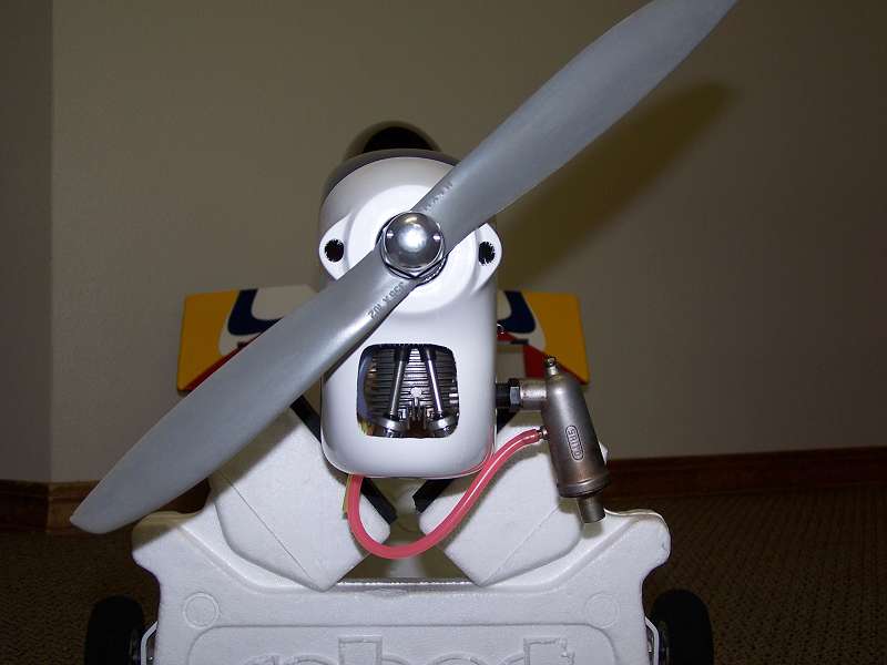

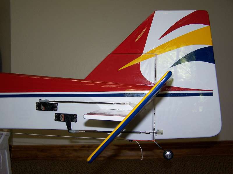

Got my 46 # 4 completed yesterday. What a sweet plane. Here is a picture or two and my setup.
UCD46 4th
Saito 82
14x4W prop
Aileron servos Futaba S9001
Rudder servo Hitec HS5645
Elevator servos Hitec HS5625
Throttle servo Hitec HS85BB
DuBro pinned hinges all around
Ready to fly weight less fuel = 5lbs 12.5ozs
CG = 5 9/16" no weight added
Fuel = Heli 30% Cool Power
Hobbico NiMH 1650 mA 4.8 v battery

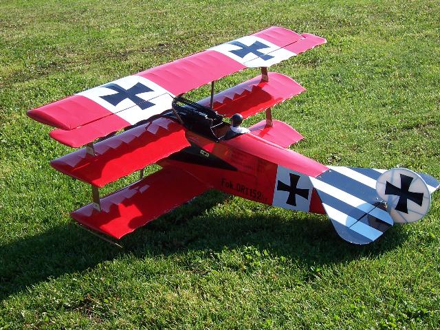

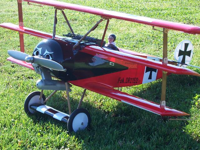

Spud, those videos on flyingcirkus are exactly what i was looking for. I was thinking, wouldnt it be great if someone had a video that showed the sticks while they flew, and that is exactly what they have. Thanks
Here is a pic of a buddy's Fokker Tri Plane. I think he was working on it for almost two years. Looks even better in the sky.
Check out more at http://tricityflyers.no-ip.info/TriC...tyPictures.asp, Choose Fokker from the drop down list.

Hey Barry,
How long are those servo arms on your Hitec's, looks like you are getting a decent ammount of throw on those control surfaces!!!

Evil, I am getting a decent amount of travel. As near as I can measure I'm getting 45 degree deflection up and down. With the Dubro hinges I have zero binding. I'm pretty pleased with the way that came out. I think the horn length on the elevators is 1 1/8" and 1 1/4" on the rudder. The rudder will touch the elevator on maximum deflection.

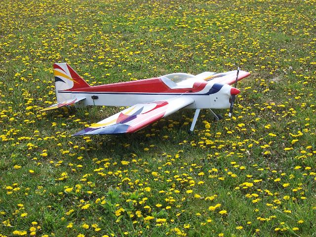

Ceegee, i thought the dandelions were a nice touch. The field looked great that day, got yellow flower petals sticking to the nitro all over my plane, but what can you do.
I wish i could get some flight photos, but i seem to be the only person who can keep a plane in frame when its flying.

gjeffers. The other Saito got sick. May revive it and fly in this plane a little later. But right not the 82 is very nice in this aircraft.
hey guys, I'm surprised nobody has asked about the fuel lines in post # 2502!!!! No questions.
Barry

Has that to do with the clunk vent atmospheric equalization and depressureization of the atmospheric line out to the ------- oh what is the extra line for????[&:]

Could it be a fill line with a oneway valve? Other than that I'm with GJeffers itsa wattchmadoogie.[sm=sunsmiley.gif]

You guys are just too good!!!!! Yeah, it's the fuel line with a one way check valve. I haven't seen anyone do that and I couldn't see why it wouldn't work so I'm gonna try it. Heretofore I've either had to pull the line of the carb or pull out a fuel dot. Both can be cumbersome and I tend to lose the fuel dot so I'm gonna give this a try. Any reason you can think of it won't work?

Evil, Nice looking plane. The pilot looks great, a little constipated, but great........ Is that an O.S 70?
Barry, I noticed the lines but was waiting for you to tell us you had discovered a new set up or something.
